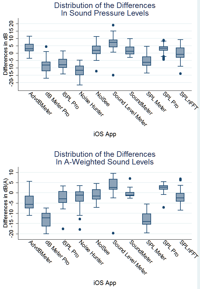

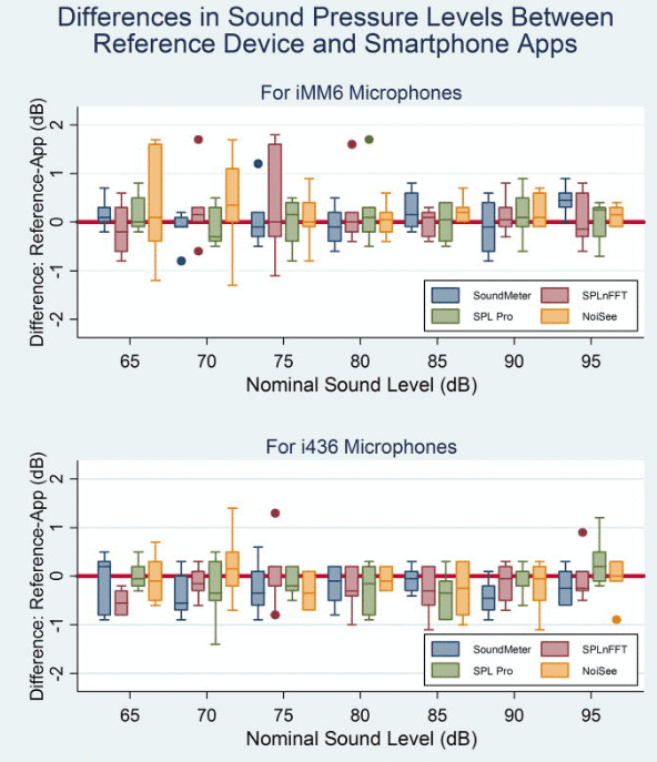

There tends to be more difference using internal microphones. Androids generally have more hardware variability, so that can be an issue also.I think my phone was not accurate; it felt more like 80 to 84 in line with the iPhone.
Averaging could be different or adjustable in various apps.
The data is a bit old at this point, but I assume the variability shown below is still similar when using internal microphones, but whose app is most accurate may be different now.
https://blogs.cdc.gov/niosh-science-blog/2014/04/09/sound-apps/
"Android-based apps lacked the features and functionalities found in iOS apps. This is likely due to the iOS advanced audio capabilities compared to other platforms, the open ecosystem of the Android platform, and having so many different Android device manufacturers using different suppliers and components."
"November 2016 Update: NIOSH researchers have just published a follow-up study: Evaluation of smartphone sound measurement applications (apps) using external microphones to examine the performance of sound measurement apps using external microphones. The study showed sound level measurements to be within ±1 dB of the reference system using the same test setup and apps from the initial study."
https://asa.scitation.org/doi/full/10.1121/1.4964639
I'll take the iPhone as near enough for casual home listening then as it was SPL Pro app.
