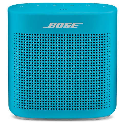

My neighbor has this Bose Soundlink2 thing, sounds nice enough, and it comes in several fashion colors.
