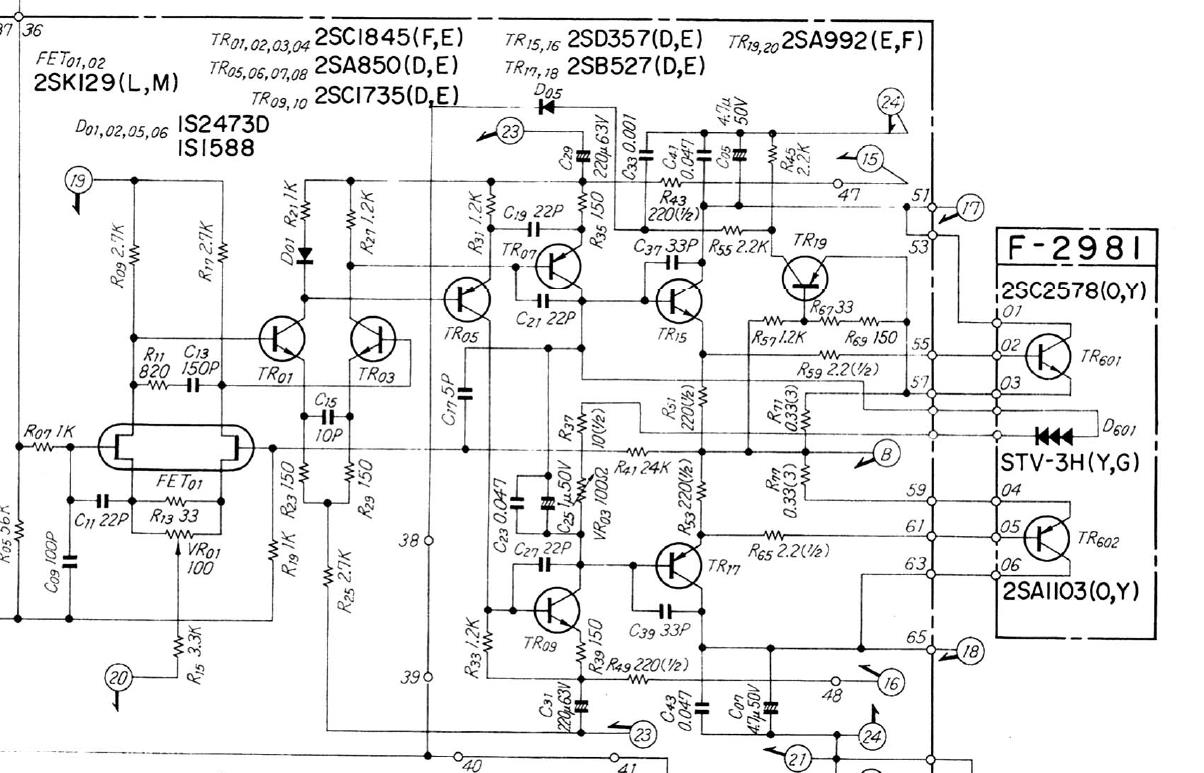

Looking to see if anyone can help steer me in a different direction than I’ve been going with a Sansui G-5500. It belongs to a friend of mine who asked me to diagnose a problem that I could not duplicate, and once we knew it was pretty solid we decided to do a restoration on it; change out the caps, trim pots, full cleaning etc.
So this worked out originally, and the unit was perfectly fine after the work. A month or so later he told me it was popping through the speakers even at low volume, so I have it back here again.
I have not been able to duplicate the issue he was having, but instead somehow introduced a new one which was that the unit was now going into protection when I was about halfway up on the volume level (sinewave test). In playing around with stuff I’m not sure how I did it but I managed to blow the outputs on the right channel. So I replaced them with the NJW equivalent subs and once I knew those were ok I also replaced all the sketchy driver transistors that I didn’t feel needed to be done the first time around. Now I am getting the relay to click into protection at about a quarter of the volume. Same input level, and also still no right channel.
I’m not sure if I’m concentrating in the right area right now because I’m getting flustered on this one. Anyone here familiar with the G-5500 by chance? I did check the stupid stuff like open emitter resistors, and I have pulled all my replacement parts and double checked. I’ve also replaced the HA12002 protection IC because I thought maybe I had damaged it when I was cleaning the corrosive glue away on the board. All the voltages look fine there, as well as on both channel outputs I’m getting my +/- 43v. I’m just a bit stumped at the moment…

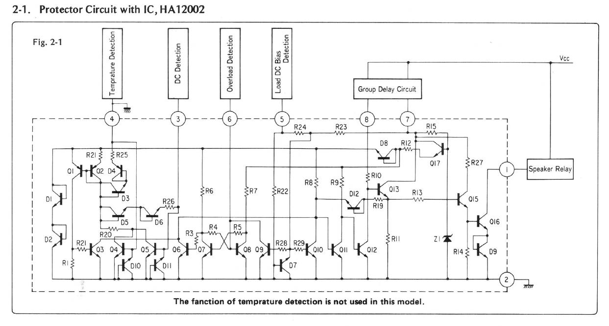

There are three input signals that can activate protection - you need to find out the one causing it.
I was trying to monitor those pins to see what happened right before the protect relay engages. Couldn't tell if anything was off.
How did you do it?I was trying to monitor those pins to see what happened right before...

On schematic find by me on the internet the slew-rate is noted to be 56V/µsec which is normal not fast. Fast means to over 100-150V/µsec.
An the transistors are 2SC2578 and 2SA1103 witch are 20Mhz. Most modern transistors for audio amplifiers are 30Mhz so I do not understood what is with first post of @tonyEE .

@sesebe yes. I was going to dive in deeper with the scope later to check something along those lines to see why the new parts are acting different. I was monitoring the protection IC pins with my meter, trying to see if there was some type of fluctuation right before the relay disengaged, but there was nothing obvious. Maybe the scope will tell me something. I'm still down a channel also, which, after I had started my re-work, found that it had already been messed with and outputs were changed out also, but it must have been done ages ago. Also, just a quick note, if I move the balance pot to the right channel (the one that's out), the relay will not kick out. It's only when there is an active signal and load on what is only the left channel right now. Also doesn't happen on just an input; has to have an active load connected, dummy or speaker.
There is a peculiar detail with this power amplifier stage - the high frequency feedback (via C17 capacitor) is not taken from the speaker output (junction of output transistors' emitter resistors) but "earlier" from the signal path.
So change in output transistors properties may introduce a phase shift in feedback chain that may end up in oscillation. It may happen or not happen - who knows exactly, your scope investigations perhaps will reveal something.

Well, it's fixed... and both issues 100% MY fault (which actually makes me feel better about it).
1. Tripping into protection: I accidentally ordered and used 33ohm emitter resistors . That'tl do it. Supposed to be 0.33ohm, and I KNEW that. I even looked at them multiple times and it still didn't phase me.
2. Channel out: I ripped the ribbon connector cable right out of the volume pot board and it happened to be hanging by a thread on just the left channel.
Another one put to bed. And thank you to everyone who assisted with my frustration.
