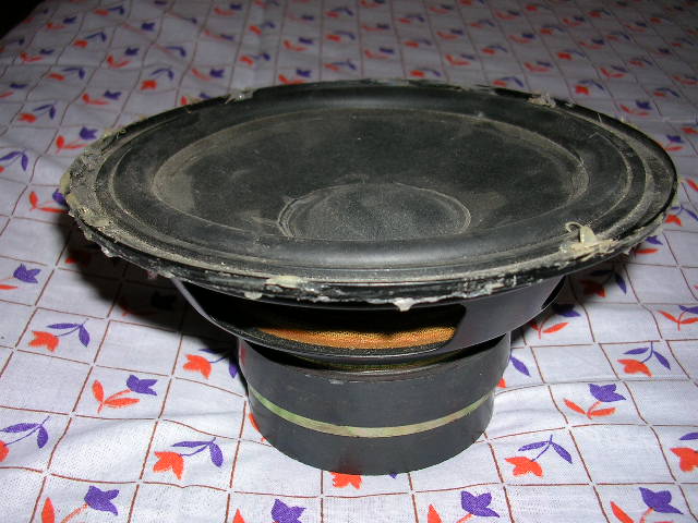

i need some help with a subwoofer driver which is 8" paper cone with foam surround, its a local unnamed driver i bought. its not a long throw driver and it must be around 40w rms and i am connecting a sony 85rms amp. so like can any one please tell me the dimensions of a vented box,the size of the vent ,and also the thickness of the mdf 4 this kind of driver.(i am using an external amplifier)
(i dont know its specs but can anyone just tell me approx. wut will work the best, i just want it to sound good)

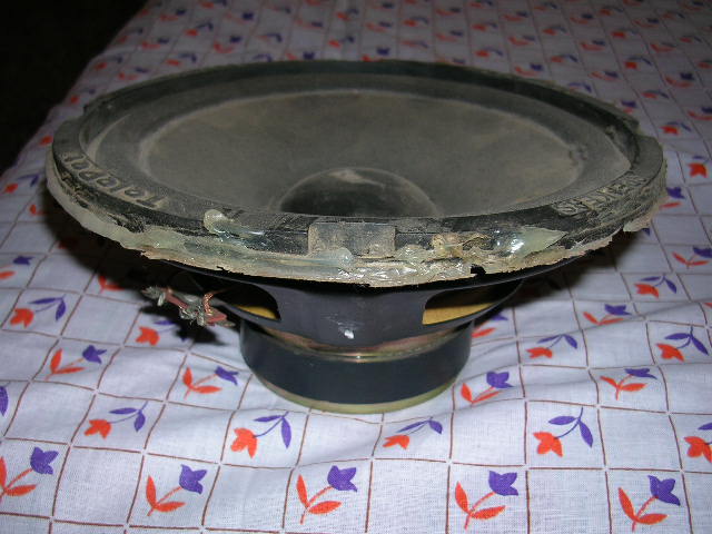

heres a picture of the 8" sub i have. see if u get any idea from it

The 8 inch driver looks like it has a small magnet which will result in fairly high Qts. This means that it will probably be a bit boomy and uncontrolled in a vented box. I expect that the resonant frequency (Fs) of the driver will be around 45-55 Hz as it looks like cheap lightweight woofer.
None of these drive units are really any good for sub use. But if you got them free/cheap you can have a play 🙂 You will need an amp and low-pass filter to feed the sub. Have you got these?

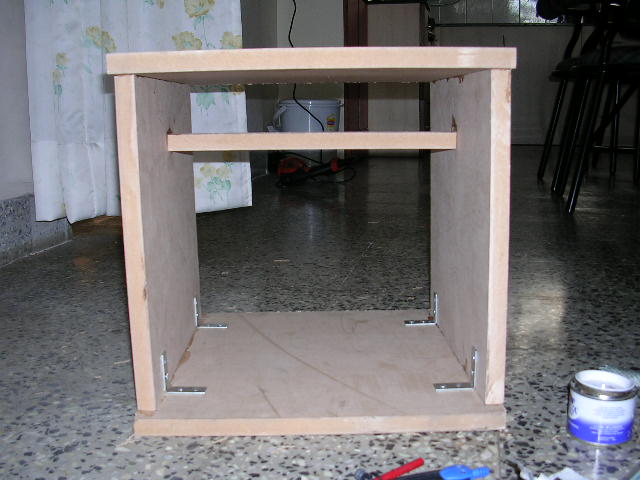

ok so i have made a box approx. 32 lts (inner volume).
with 18mm mdf. i have pasted and screwed the boards together. i used small steel L-shape braces inside at corners and one mdf piller to support the walls ( cuz they were bending inside because of the steel braces.
tell me again do u think i should stuff the box?and do u think i should make a vent?
tell u wut, i'll make a bipolar sealed enclosure if it sounds good i'll keep it or i'll make a vent hows that sound?

sidd_raj2002 said:i used small steel L-shape braces inside at corners and one mdf piller to support the walls ( cuz they were bending inside because of the steel braces.
I'm surprised that you could bend a bit of MDF that thick.

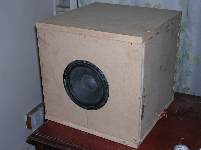

hey there,
i already built the sub. guess wut it sounds terrific !!! seriously.
it first sounded a bit boomy so i put some foam cubes in. now it sounds a lot tighter.and its not distorting at real high volumes either(may thas because of the sealed enclosure). wut u think should i put more stuffing to make it sound tighter?cuz it is a bit boomy right now too. wut stuffing do u suggest?
but beleive me i could not ahve done this without ur help man. excellent. this baby sounds way better than many other (costly) subwoofers I saw, they were ofcourse smaller but the cost was like more than 80 or 90 $ but i buit this one in hardy 30$ including drivers.
heres the picture of the finished sub. wut u think should i give it a cherry polish? wut u think?

I'm glad you are happy 🙂
What is the stuffing you used like? How dense is it? I'm surprised it made such a difference to the sound.
It's usually the case with speakers (especially cheap ones) that bigger boxes sound better.

Did you glue all the panels together? If yes, it's well done because not noticeable hehe.
