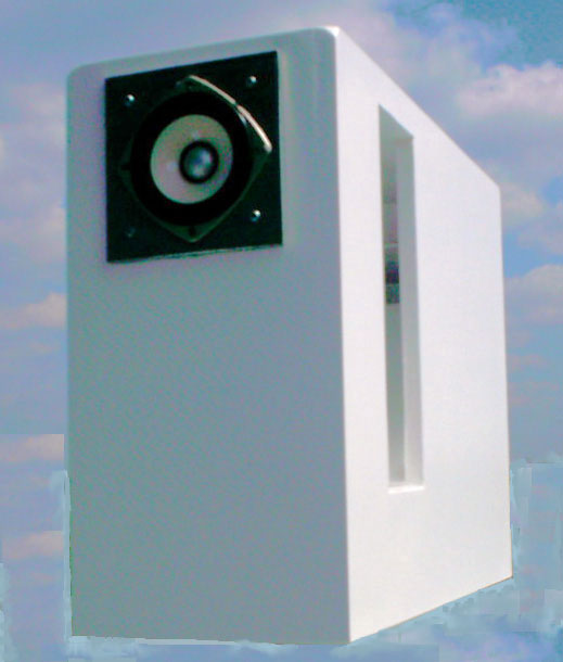

During 2003, I have built a pair of these for a set of FE87E (see image). After reading all the reviews saying "a lot of bass for such a small speaker", I was a bit disappointed. Ther is no bass for me. However, voices sound nice, and small combo music is nice to llisten to. Very good imaging.
When combined with a pair of low-range speakers they sound very nice. They are one of the nicest mid/high units I have heard so far.
Further, I have tried them in a FRS-8 (Visaton) Buschhorn enclosure. This also delivered a very thin sound, much less body than the FRS-8. Also here - no bass for me. Even less balanced than in a BR. Note that this rear loaded horn was not designed fort this driver. The Fostex horn enclosure probably will do better.

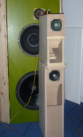

Last but not least, I tested the FE87E in open baffle enclosures with more or less serious constructions. I have tried the baffle from the BR enclosure for example. The most funny one is seen in the other picture. There I have screwed a box to the BR baffle to obtain a lower tuning of the mid/high unit.
In open baffle, I love these drivers! Mainly because highs and mids are very coherent and sound well together. I am planning to build a nice enclosure and fit them to a nice set of 6-7" low range speakers that I will use in a TL enclosure. A passive filter to make a lowpass for the woofer and a highpass to lower the low frequency response of the FE87E and make them play cleaner.
Have fun with your little boxes! These are very nice drivers to experiment with!
