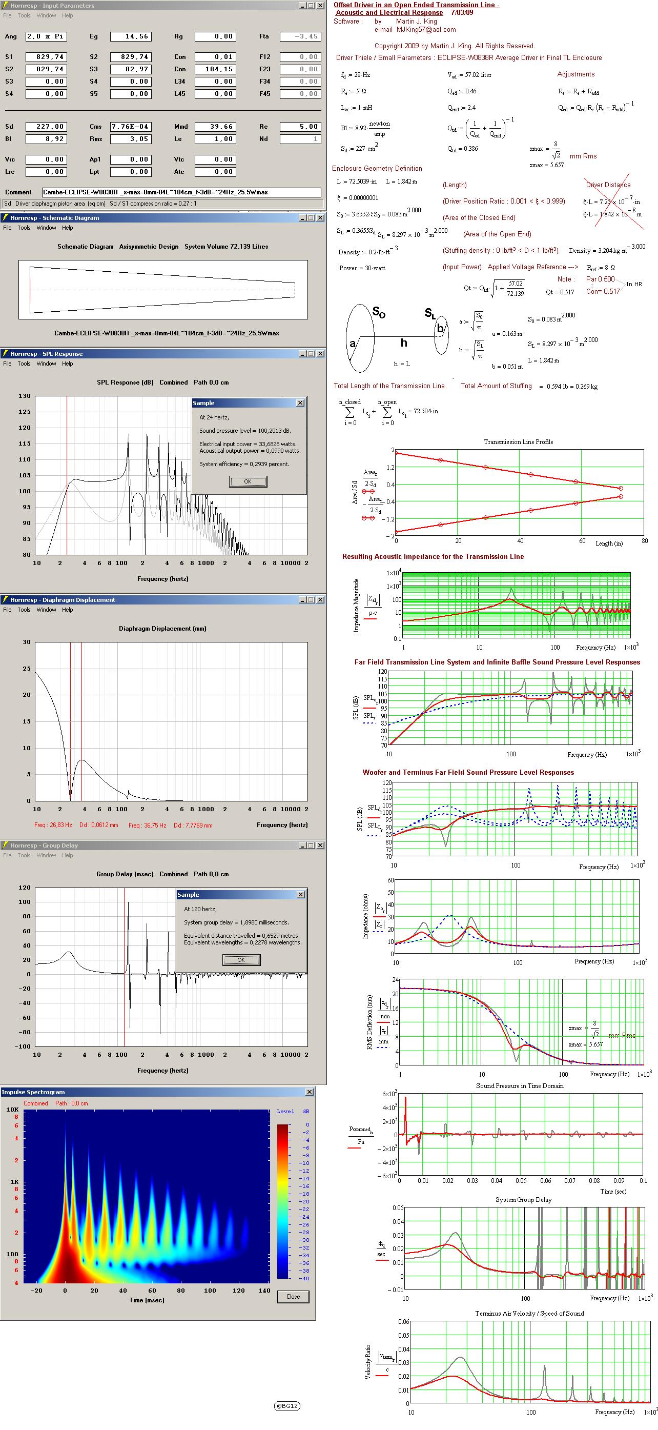

Hello,
I have a pair of Eclipse 8" woofers that I would like to build a pair subwoofers
with. I'm looking to try a transmission line enclosure for them. I downloaded
a excel based spread sheet created by fellow diy member Henkjan. Well, my computer is a Mac and when I typed in woofers spec data in the spread sheet I got this:
Length of the line 29.11"?
Box dimensions?
Taper?

Hi Cambe,
Post the driver T/S . Don't forget Sd,BL and Re if you want help to a trustworthy design, without these parameters...No help at least from 'b'.

PS: My computer is OK now so I started simulating your Pencil.
I used the spread sheet program downloaded from MJK's website and got this:
Area of closed end ~ 128.61"^2
Area of open end ~ 12.86"^2
Actual length ~ 72.5"
Effective length ~ 73.66"
Dz ~ 51.063
Dr ~ 0.0975
SL/SO ~ 0.1
Hi Cambe,
You master the MJK's - spread sheet and this design will work just fine.
If you import your numbers to HR ,you will notice a small bump at the lower end of the FR.
As it's less than ~3dB it will completely disappear when the TL is stuffed with suggested density/amount of damping material.
b🙂
FYI:
b🙂
