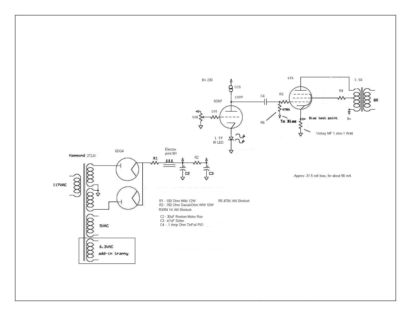

I found a nice SE 6V6 schematic (maybe here) and have used it for the basic map, but am math challenged meaning no Ohm's Law and truly I do not understand all the stuff my GE book tells me.
Basically this would be a very simple amp. If you take one side, forget about the power supply which I want to put on a separate chassis so I can make changes to it later and use different output tubes, as in one chassis for 4 Pin Triodes and another for Octal Pentodes, but all running fairly close together with maybe switches to change the B+ as this is ALL about tube rolling.
Basic amp is a 6J5G and/or GT as the amplifier and a 6Y6G and/or GT as the power tube. I bought a pair of James J123HS which has 3 primaries and 3 secondaries. 2.5K to 5K ans 4 to 16 ohms. Doing SE the list of triodes and pentodes you can run on this is as long as your arm, but I figure the 6Y6 and 6J5 are about as easy as it gets. The 6J5 takes 300V to the plate and the 6Y6 takes 200V to the plate. The 6Y6 seems to like an impedance of 2K to 3.5K but most tube data shows 2.5K. The J123HS lets you play around a lot.

Anybody want to help me out? Get in on the fun? Want to find out how many watts can be gotten out of a triode strapped 6Y6 and if 2.5K is low enough to still get pretty music out of it?

The 6Y6 is a good tube. A little heftier than the 6V6 but at lower plate and screen voltages. Triode connected with 200 volts B+, I would expect the tube to produce about as much as a pentode connected 6V6.

If I recall correctly, Acrosound made a transformer specifically for the 6Y6, and really sang the virtues of this tube. Yeah, it was a PP design, and UL to boot, but I think they were getting about 18 watts out of a pair, at rather low B+ levels, using cathode bias. The low plate-to-plate impedance required allowed for a rather extended HF response as well.

I bought some James OPTs that have 3 primaries, I still haven't found a SE 6Y6 schematic. Without a triode strap they are rated at 6 watts, which is about where I want to be. Triode strapping is sometimes worth the loss of 3 db, I would have to find out if it would be enough for my speakers. At everyday listening levels I would say yes, but if I want to listen to Yes, I doubt it.
