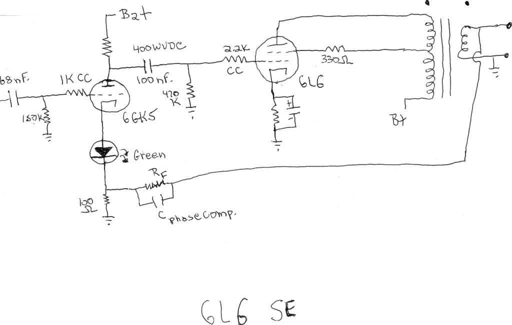

We used the brute force method in "El Cheapo". The LTP load resistors are inductive. That causes gain to rise in step with frequency, a technique known as "peaking". The NFB loop is shorted out by a cap. from speaker "hot" to ground, with the 3 dB. down point set at a bit more than 80 KHz. The natural HF roll off of the O/P trafo brings things into alignment. The better the O/P "iron", the further above 80 KHz. you can go. Controlling the level of NFB induced HF error correction signal is "the name of the game". Don't ask the small signal circuitry to bite off more than it can chew.

Eli - OK, I've pretty much gotten over the "keep it all analog" mindset. If I will be able to hear an improvement I'm all for it...What will the circuit change look like..and R23/24 values?

An interesting possibility is to replace R3 with a 10M45S constant current source (CCS). That tweak is good for linearity and makes sizing R23 and R24 very easy.

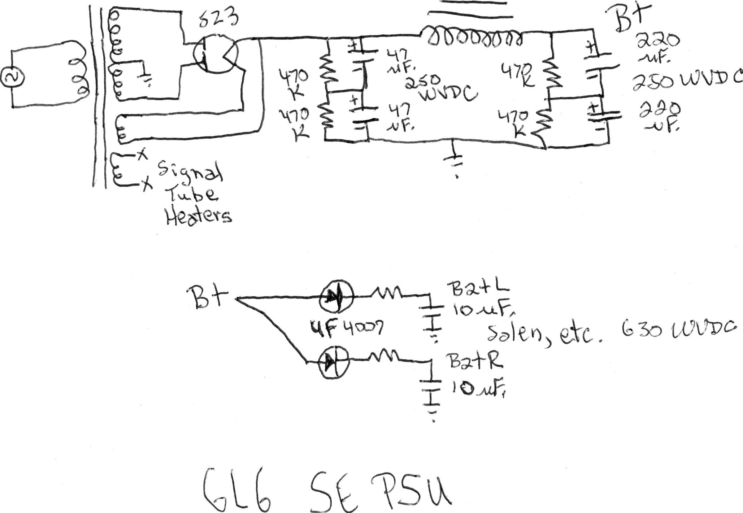

If the power transformer is truly a 440-0-440, the first caps are inadiquate. You will have over 550V on the first two caps with ratings of only 500V stacked like that.
440V * 1.414 = 622V
622V - 60V (Tube drop) = 560V

The schematic symbol for a CCS is 2 interlocked circles. Refer to the attached "El Cheapo" schematic.
A 390 Ω RN65 seems good for the 10M45S current set part. Using the 10M45S CCS makes 100 Ω fine for R23 and R24. The exact voltage B2+ comes in at is no longer important. CCS loading makes things settle into place, automatically. 😀
I previously stated that R4 should be 10 Ω. Making R6 56 Ω will feed back 15% of the net O/P voltage, which should be a reasonable starting point. If R6 is 100 Ω, 9% of the net voltage will be fed back.
Gimpy's remark about allowing WVDC headroom in PSU 'lytic selection makes sense. So, 350 WVDC parts will be used. Panasonic part # EEU-EE2V470 takes care of 47 μF. and Panasonic part # EET-HC2V221HA takes care of 220 μF.

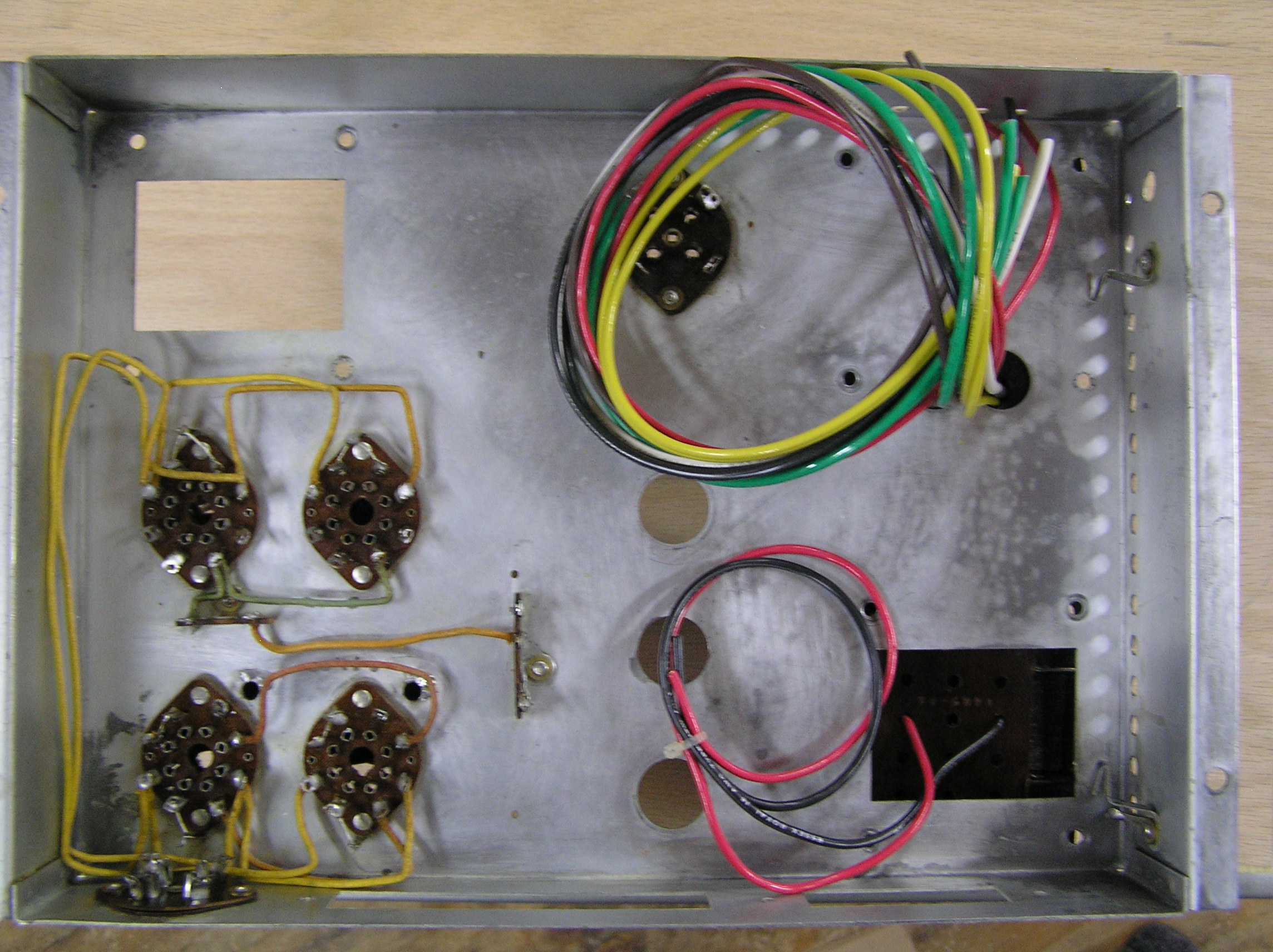

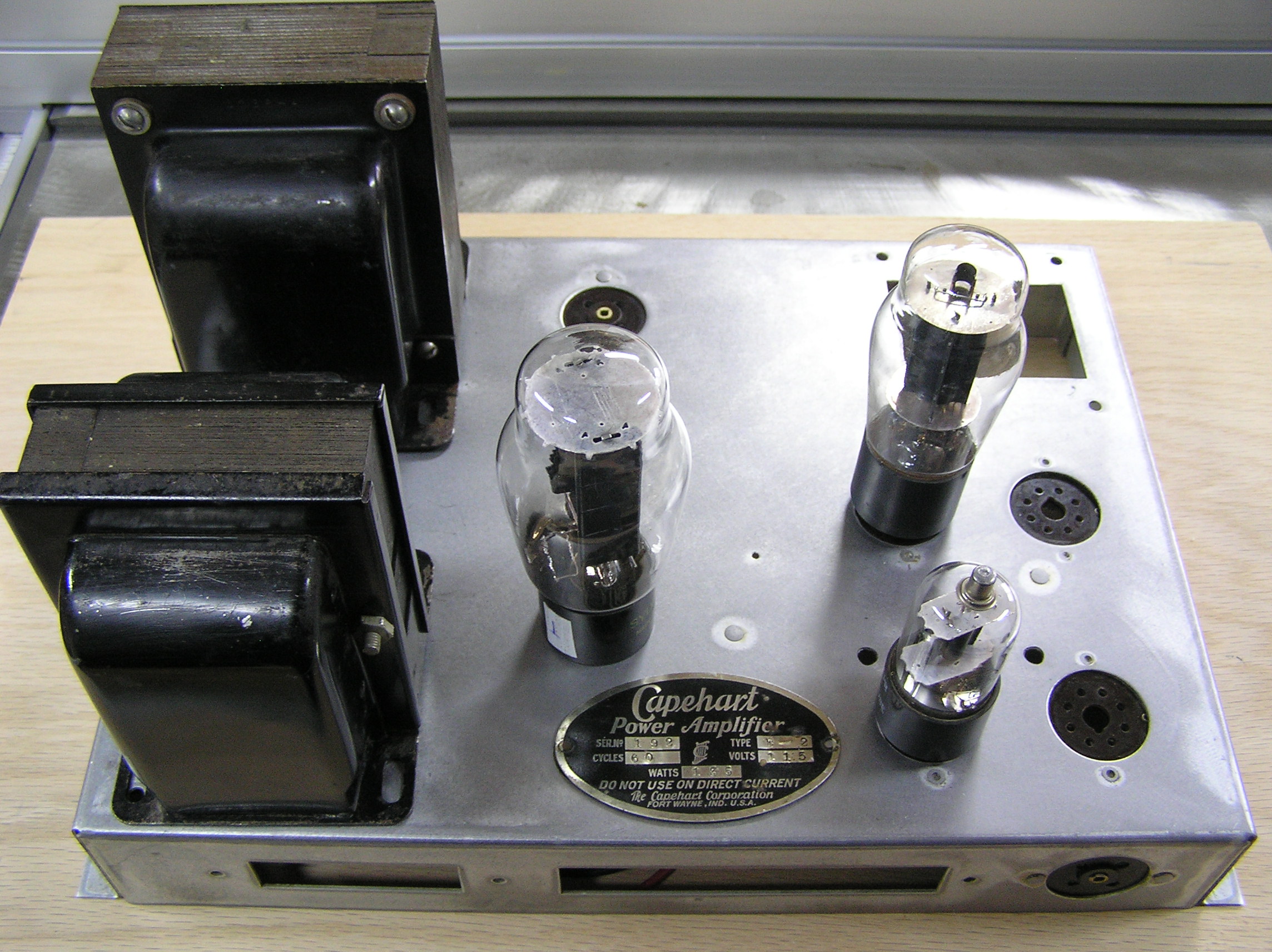

So, I've spent enough time with this schematic that I think I can build it in my sleep...
Eli - As time permits can you review this and possibly fill im the remaining blanks...I'm about ready to start ordering parts and would like to get everything I can on hand. I know a few values are still unknown and some will be a fine tuning issue, but starting point values and ranges would be good and I can order everything at once.
Please take your time, and again I really appreciate your effort...
