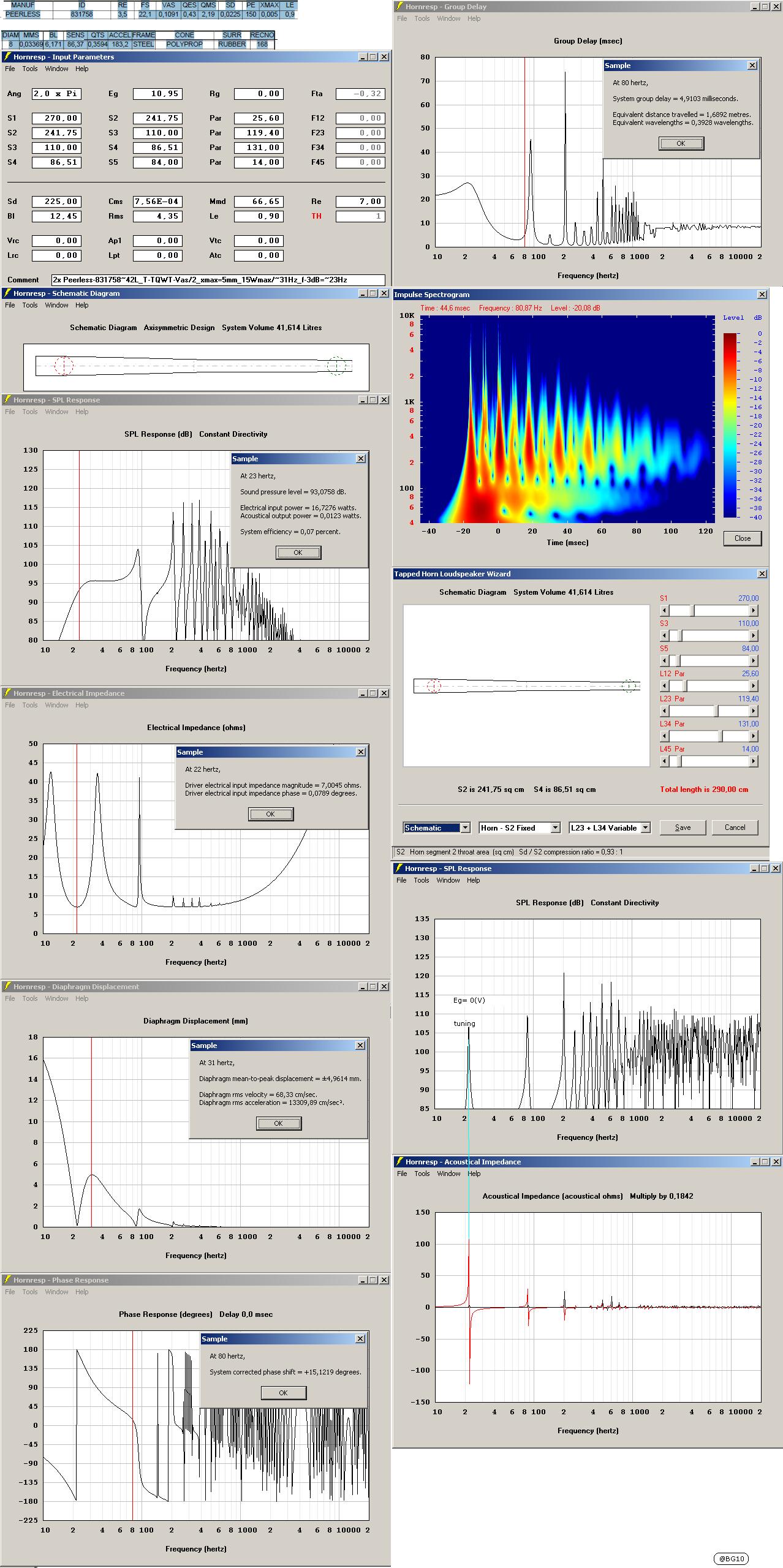

Port size solved.Suggestion:Build a multi-folded 42L T-TQWT with series connected coils and Vas= Vas/2.
I doesn't get smaller than this, tall if single folded but more compact if multi-folded.
b🙂
Bjorno-Tak sa mycket (sp?). A lot of the technical stuff and the T-TQWT acronym are lost on me, but FYI these woofers were originally used in a simple transmission line tower I built about 12 years ago and they produced unreal bass (but didn't ever real move enough air). Thanks for the diagrams and analysis runs-- I'll try to make sense of it and see if I can do, as you suggest, a small footprint, though maybe tall, t-line sub. I'm still leaning toward the simple compound sealed box, because it will be tiny. I have sats right now to go with it, but they will eventually move back to another room/system, at which time I might try to do some tiny coaxials or full range sats and see how small I can go 😉
