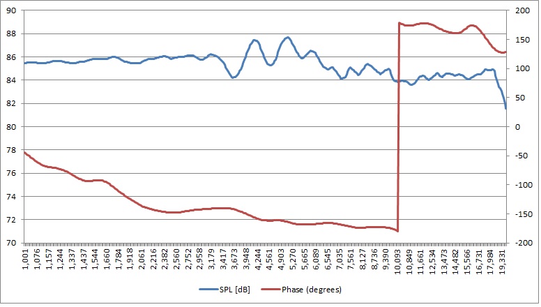

Here's the measured TPL-150H response.
TPL was mounted vertically, away from reflecting surfaces. Mic was inside the waveguide and 3" away from the front of the AMT, on axis, in the middle. I used REW, from 1 to 20kHz, gated with FDW of 10 cycles.
Is this OK to use as input into Bagby's Passive Crossover Designer?

peaks and dips around 5k are less than 2 dB and L. has active EQ if needed.
Is it not better to measure it at the mouth of the horn on axis, then 1 meter, then at the seat spot to have an idea ?
I assume for XO, measurements are maid at 1 meter for the trebles and mediums ?

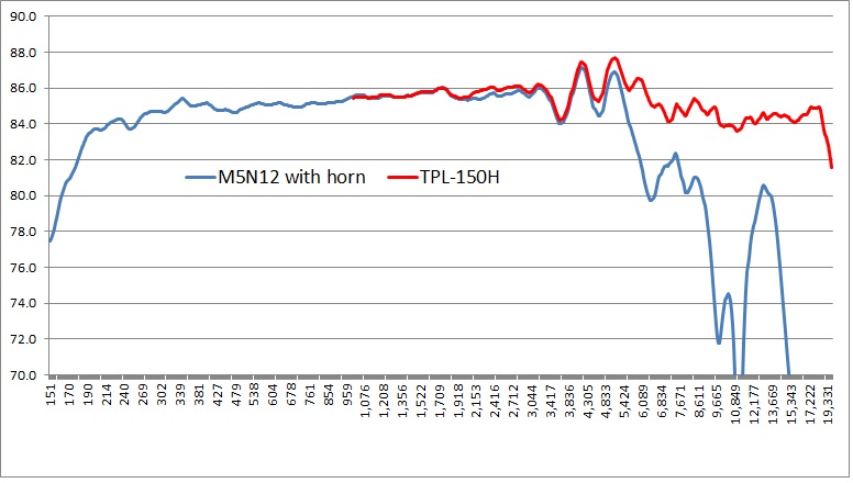

I built a dummy rectangular tractrix horn for the M5N12 out of foam, and measured the driver. Response is plotted below. It looks so good it is making me wonder if I'm measuring appropriately.
Mic was set 12" from the horn mouth, gated FDW at 10 cycles, response smoothed at 1/48.
It is very suspicious to me the exact same response as the TPL was measured, even the ripples at 4-5kHz.
So assuming the measurement was right, next step is to input both frd ccurves into the Passsive Crossover Designer. BUT, do measurements look right?
Thanks in advance for the input!
