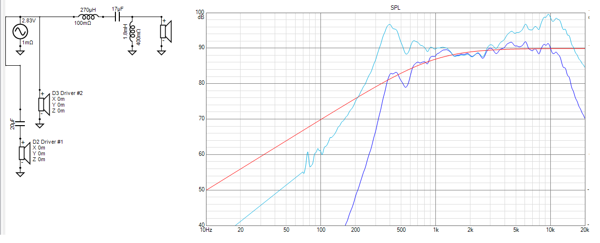

Simple first order crossover.
I feel like I should emphasise here that what Allen has displayed is a 1st order acoustic crossover centred at 1kHz. As you can see it needed a 2nd order electrical high-pass filter to arrive at this slope. This was necessary because of the tweeters rising response. The series pass inductor is used to tame the rising top end. I am not sure if Allen's crossover takes into account the tweeters full impedance although it could do as PE provide zma files too. I would have thought it may have required a notch to flatten the impedance peak but maybe not.
Allen's filter is beneficial because it provides a first order roll off during the region where the tweeter provides useful output but as it's actually 2nd order it'll provide much better control of what happens below this range.
As to if the tweeter will work this low? Distortion measurements with an appropriate filter, at your kind of listening levels, are the only true way to tell. Nevertheless you are considering operating the tweeter at 1kHz. I wouldn't want to go any bigger than 12" to keep the horizontal off axis good.
