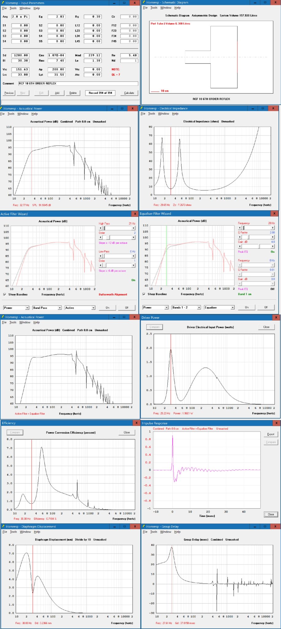

Hello Friends,
I have 2 18 inches sub driver and wants to design for them. I have the parameters and tried my best to design on a software but was unsuccessful.
If anybody can please give me a design dimensions I’ll be grateful.

RCF LF18X451 by the looks of it.
It will help others to help you if you tell us a bit more info.
What kind of encvironment will it be used in - eg home, live gigs, outdoors vs indoors etc.
What kind of program material will you mainly use it for - eg mainstream music vs EDM vs Movies etc
Do you have any other limitations such as max size or limited amp power available?
HTH,
David.

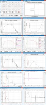

Indeed, it's designed for either a huge high power sub, mid-bass horn or mid-bass sealed or vented alignment. Otherwise put it in an acoustically tiny (20* Vas*Qts^3.3 = ~66 L net) sealed box and use DSP to frequency shape it to suit.
its a classic assisted 6th order woofer - so a 151.6l vented box tuned ~fs
