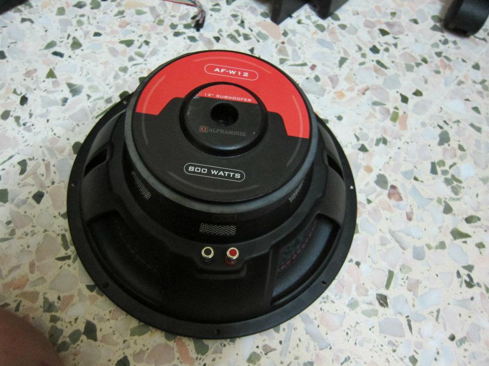

I need a help here again ... I have a 12in Subwoofer driver here ... Parameters are:
Qts: 0.285
Qms: 5.720
Qes:0.300
Vas:94.55L
Fs: 31.75Hz
Re: 3.5ohm
Zohm: 4ohm
Sd:95.03in2
P(rms)150W
Sensitivity: 92.07dB
Pictures are available too:
I plan to use it with 71 liter of box size and using 2 of the drivers ... as the parameters above turns out from WINisd it suggests that vented box works best ... but any other suggestions here? i plan to use with active EQ ...

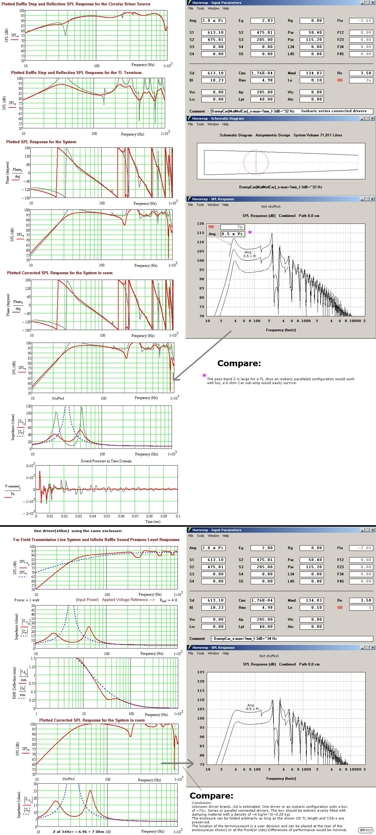

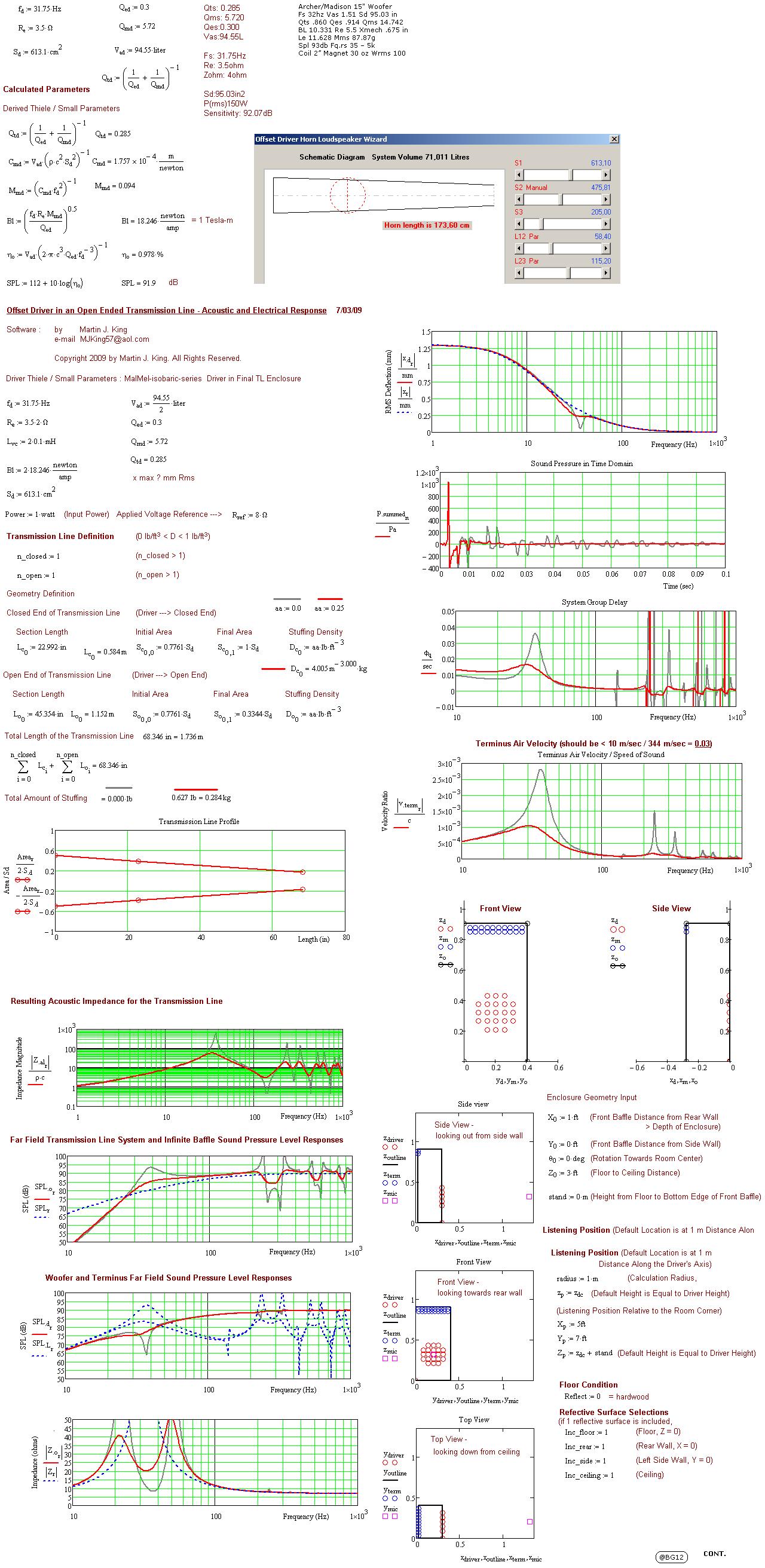

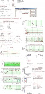

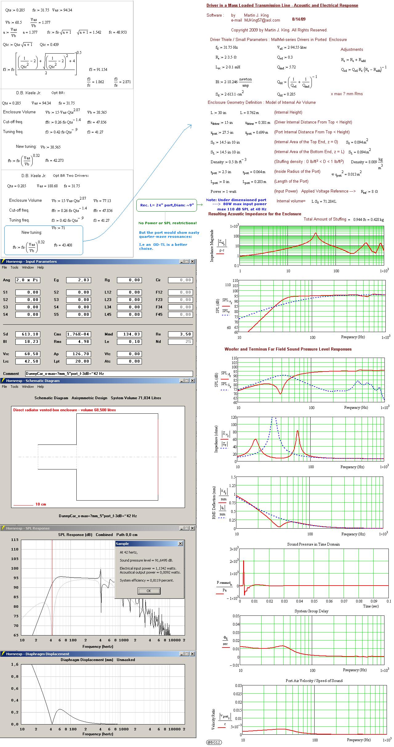

Have you seen this thread ? Linearteam - For everyone wanting to predict "Cabin Gain" 😉
After you post back i'll plug the numbers into WinISD for you, and see what i can come up with 🙂
