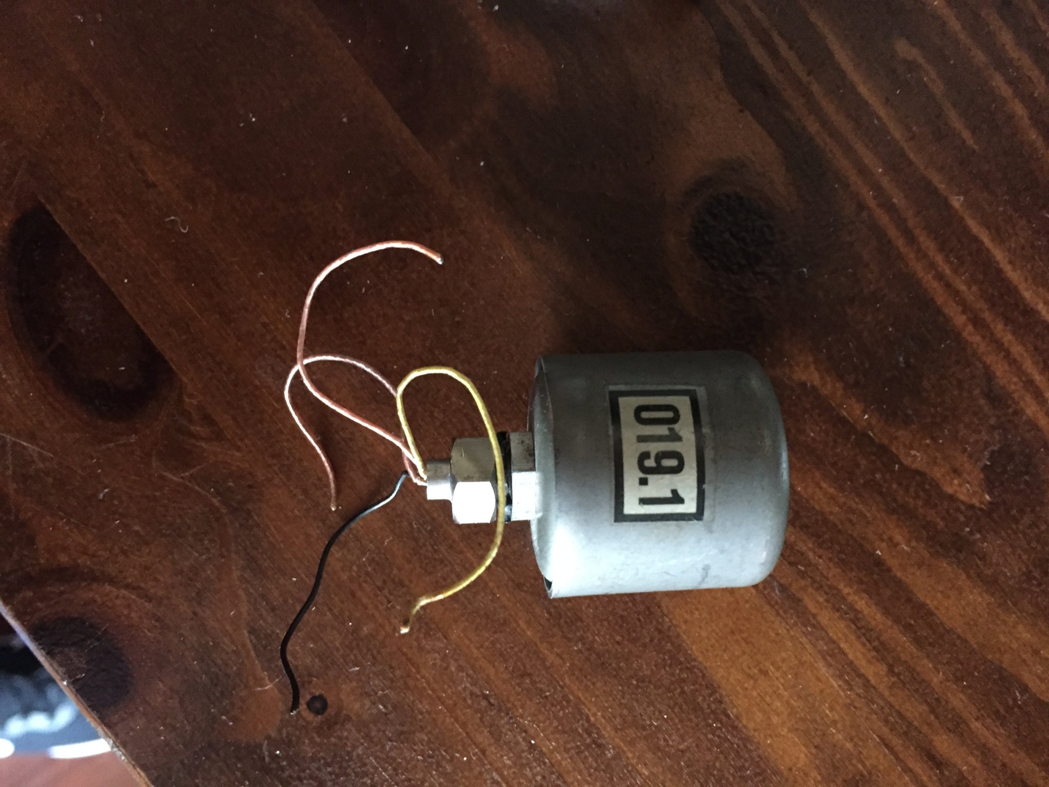

I purchased these German line output transformers some time ago, they are marked 019.1 and come from a broadcast mixer comissioned by the RFZ (the East-Germany BBC. Well known for their lovely preamps, I purchased these for some pres I have from these old mixers.
I assume these are matching transformers, but Its impossible to find a diagram and I mysef have never wired/tested a transformer.
Any help in wiring this would be much appreciated! It would go from the preamps unbalanced output into the trafo and out to the XLR mounted on the chassis.

set the meter to low ohms, find your two windings and the resistance for these windings.
I would have to see if I can look up the Haufe part number on the transformer.
since you are connecting to an unbalanced output with this transformer you connect the primary to your unbalanced output and the secondary is the output with one on pin 2 and the other on pin3 pin 1 would stay unconnected as the next device is the shield.
If I remember, this is a 300 ohm to 300 ohm transformer and a better transformer can be sourced for your application. These are mid to low end transformers in pro audio gear, So expect bass roll offs from 50-100 hz down. and lower bandwidths.

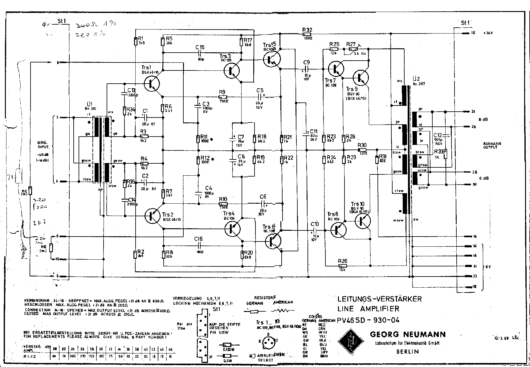

like its similar to a Siemens 811403 PC board
This one looks more like the PV46 circuit.
But what is the output circuit?The RFZ amplifiers usually only have a transformer at the output of the console. You can use a common 1:1 transformer for this. In the KSG625 this is a 1:2 transformer due to the low level in the console.
I would just study the circuit and apply the appropriate transformer, and not chase around for a vintage transformer that is not going to be any better than a new one.
no problem.Here is the original data sheet, complete with diagrams and the full schematic in PDF.
Any help reading this information to choose the right output trafo is much appreciated indeed!

It isn´t. The design of all RFZ are totally different to the design of the Leitungsverstärker PV 46 SD.RFZ is the east Germany version of Siemens and a lot of the designs are almost the same.
At my website https://www.audiomodellierer.de/Home_-_Rundfunk-_und_Fernsehtechnisches_Zentralamt_der_DDR.html you can find a lot material about the RFZ. You will see, that they were good enough to develop their own electronic designs.
