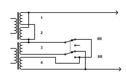

I've got a pair of custom Sowter's for a Baby Huey EL84 build.
I didn't get a spec sheet, but this one looks fairly the same:
https://www.sowter.co.uk/colours/8378.pdf
There are 8 secondary wires, red/blue pairs numbered 1-4.
I'm having trouble understanding how to wire these given the drawing above.
The 1ohm and 16ohm diagrams are less relevant for me.
Ideally, I'd like both 4 and 8 ohm options, so either:
* Wire in parallel with multiple binding posts
* Or switchable via toggle switch.
Thanks for your help.

You'd just need a DPDT switch to change winding #4 from in parallel with #3 to in series with #3.
Like this:

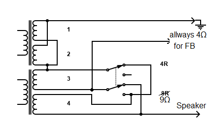

Still haven't made much progress on my EL84 build with Sowters....
How should these be wired if using feedback?
With tapped secondaries, I've chosen a tap (say 8 ohm) tied it back to the PCB and tweaked the compensation cap according to it.
With the Sowters, the 4 and 8ohm will be switchable through a DPDT switch, there isn't a "fixed" secondary that I can tie back for tweaking the feedback.
What is the best approach?
There is a tap that's allways 4Ω you can use for a (to 4Ω adapted) feedback.
And 1+1 gives 4Ω (1+1)², 1+1+1+1 gives 16Ω (1+1+1+1)², but 1+1+1 doesn't give you 8Ω but 9Ω (1+1+1)²

Quote:
"There is a tap that's allways 4Ω you can use for a (to 4Ω adapted) feedback."
Doesn't load of the speaker on secondary windings affect feedback points differently if different taps and/ or speaker impedances are used within the same winding?
