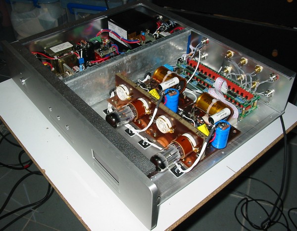

The 30k is the integral part of the electronic volume control circuit which is a DIY kit made by a very popular China based DIY shop, "Lite Audio". Refer to the attached photo, you can see there are 2 relays boards stack. This kit didn't use any IC to do volume control, instead they use whole bunch of 5V miniature relays and Halco resistors to perform volume control just like those manual rotary tappers. I believe they inserted a 30k series resistor into the output of the circuit to prevent or damp any resonance or transient that may be generated during relays operation. BTW, this kit can do 100 steps volume control, 4 sources selection, and come with a remote control.
