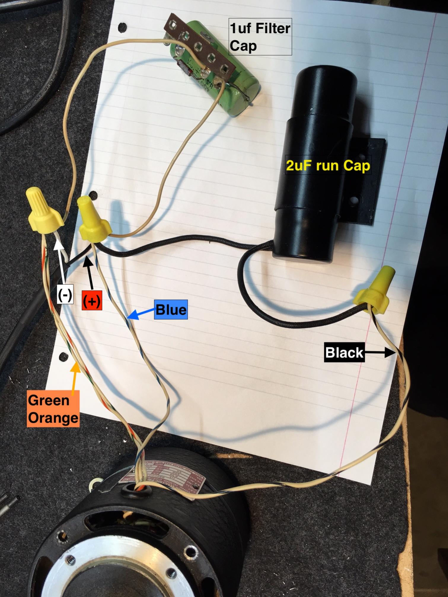

Trying to check your wiring from your photo Pat.
However, I can't see all the connections and, with my eyesight, I'm unable to differentiate the colours!
Could you sketch then post the circuit as you have assembled it?
Is the 1uF capacitor and resistor combination connected between line and the blue wire?
Here is a close-up of the wiring with colors identified. Please confirm.

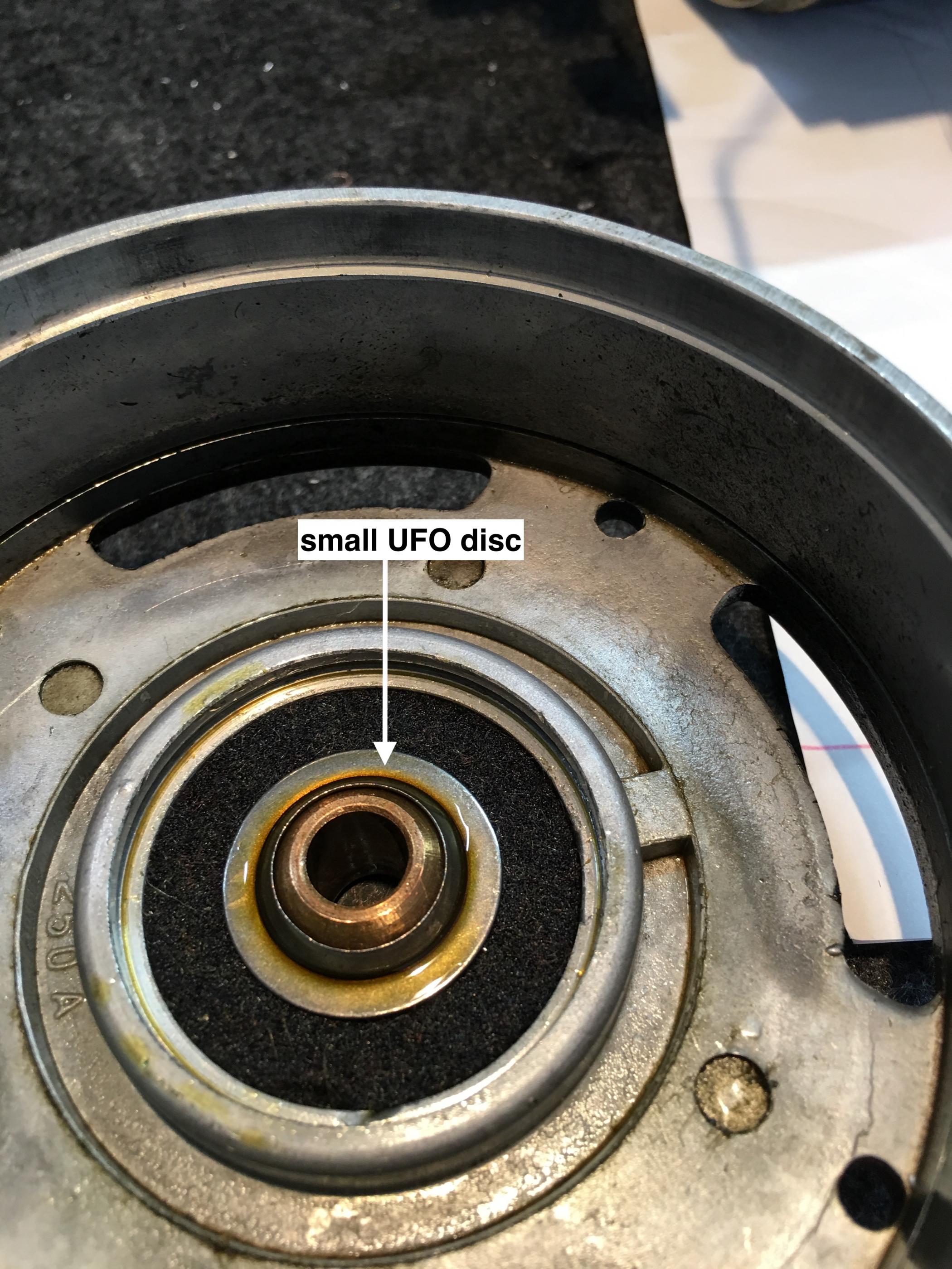

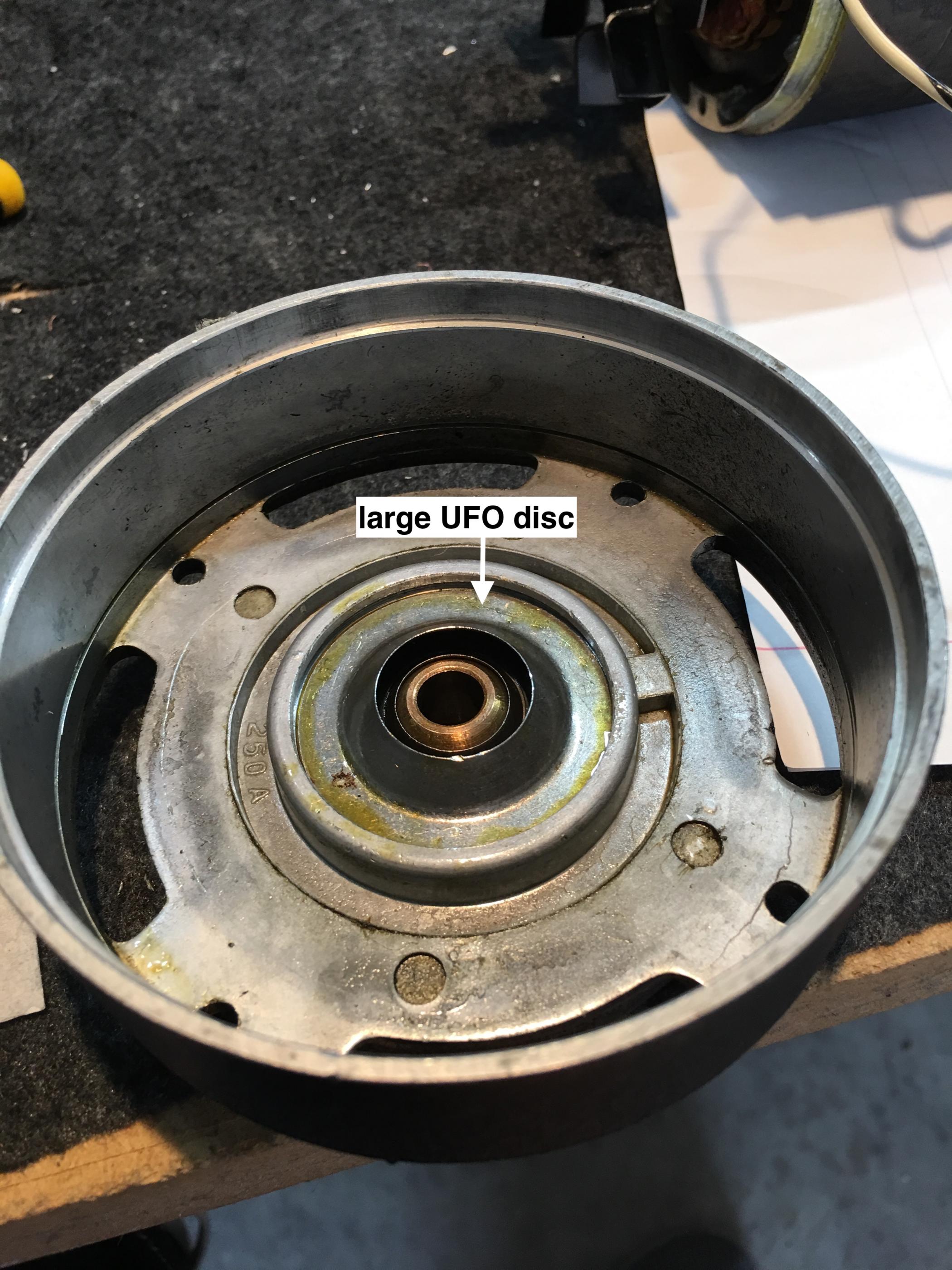

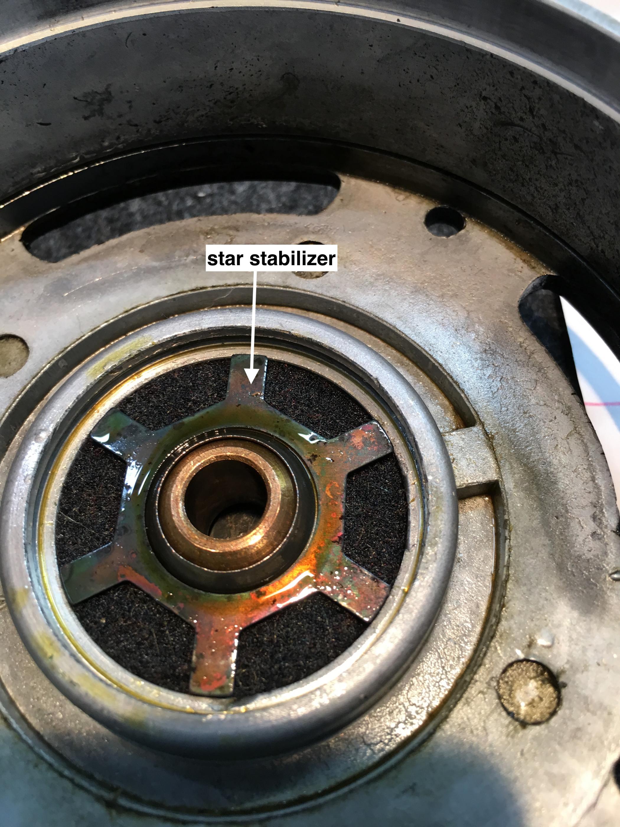

SUCCESS!!! She's running. OK, I re-assembled the bottom bushing components and I changed the order of 2 of the components. The "star" should go on top of the "small ufo disc". Then the larger UGO disc goes on top of the "star". Forgive me in advance as I do not know the correct names for these parts. Here is the proper order of assembly starting from the bottom going to the top:
1. bronze bushing
2. felt oil ring
3. small UFO disc
4. star stabilizer
5. large UFO disc
See photos. I had #3 and #4 reversed order. This allowed the bronze bushing to move freely. Once the assembly order was correct, the bronze bushing was locked into place and thus kept the motor shaft in it's place.
THANK YOU! for all who contributed on this journey. I hope this thread helps out someone else in the future. I am so happy!
