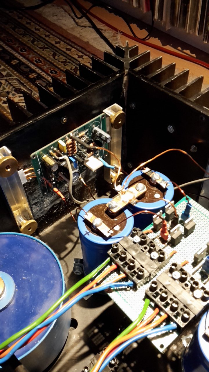

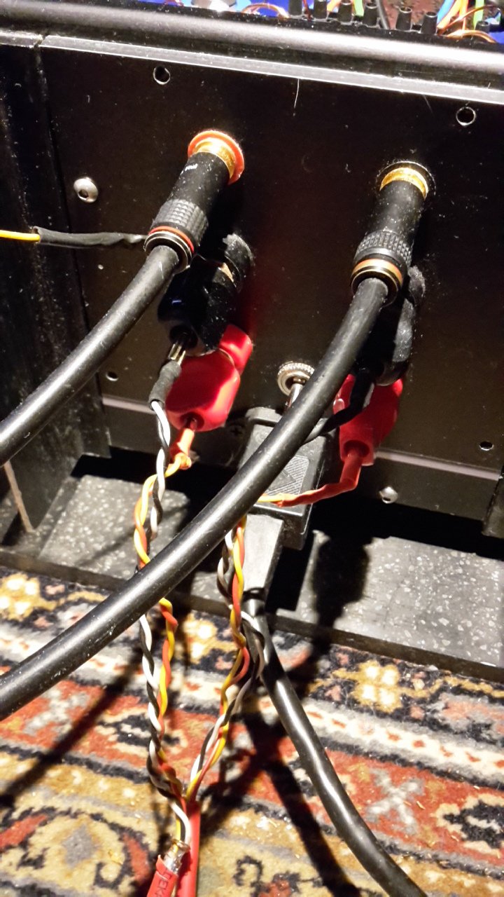

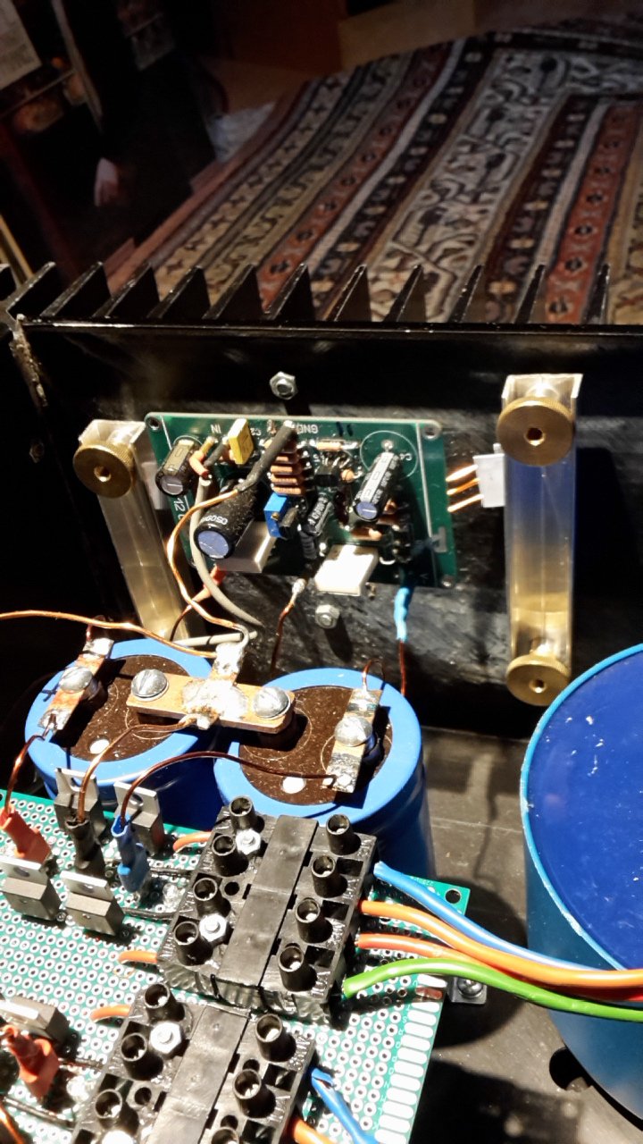

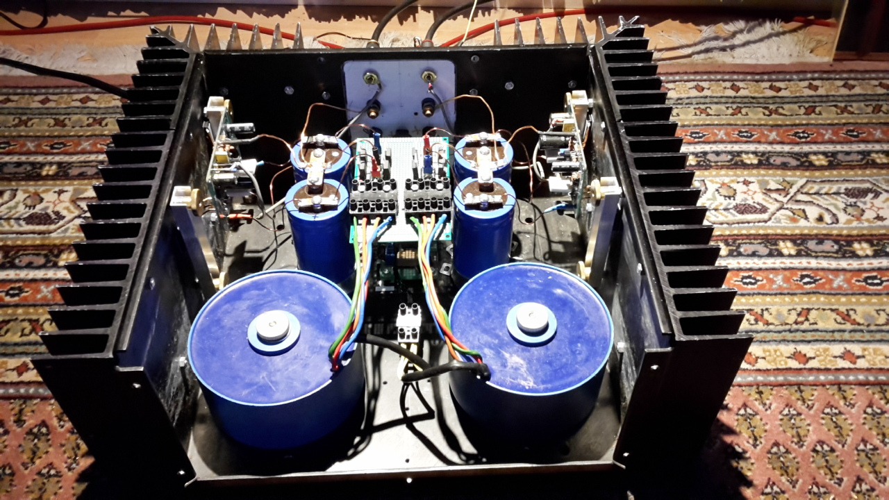

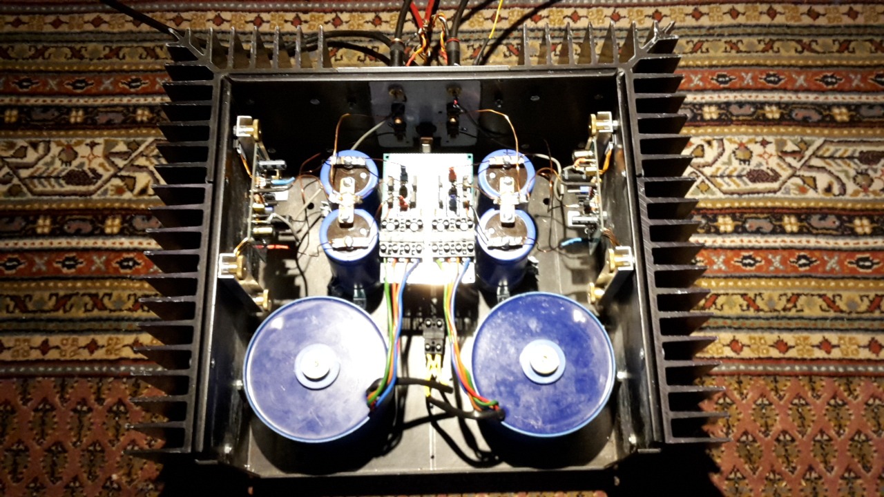

C citationfan Member Joined 2013 2024-10-01 6:57 am #22 2024-10-01 6:57 am #22 Here some pics of my DIY Citation12 Mosfet The enclosure is from an old Bose1800. Trafos are 2x30V/300VA = DC 42,8V per rail BIAS is 200mV Electrolytes are 68000µF/50V from NipponChemicon Cableing is all Copper solidcore
