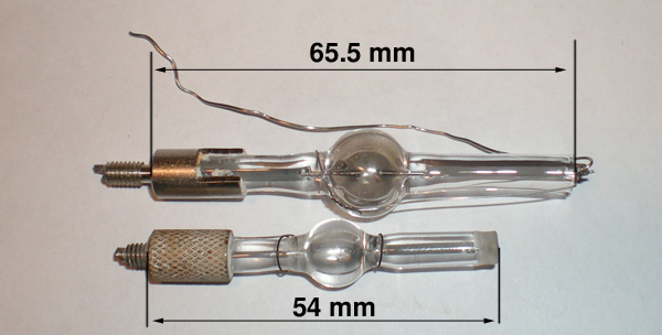

I have BENQ W100 projector, and I am unable to install new burner for that.
I have ordered and received (from YWH) following items:
-One BSM-AC 200W (does not light up with this projector, but I'll keep it as spare for some other projector)
-One JYS/AC 200W (works ok, but is too long to fit in there)
For some crazy reason BSM-DC 200w DOES work, but it is clearly the wrong type. (this burner is small enough, though)
Any ideas? Anyone had same projector with burner change recently?
Previous owner had bought burner from YWH, and YWH recognized it as JYS/AC (from picture). Older one was bought over a year ago, and model has changed since.
But the new one is MUCH bigger than the old one!
Original reflector says:
TOP 302 D6
UHP 200w/170w 1.0
PHILIPS
HG
The older one just and just fits in there, the new does not.
I'll try to include picture to this post. Above is the new JYS/AC and below is old JYS/AC. You can see the difference :/
