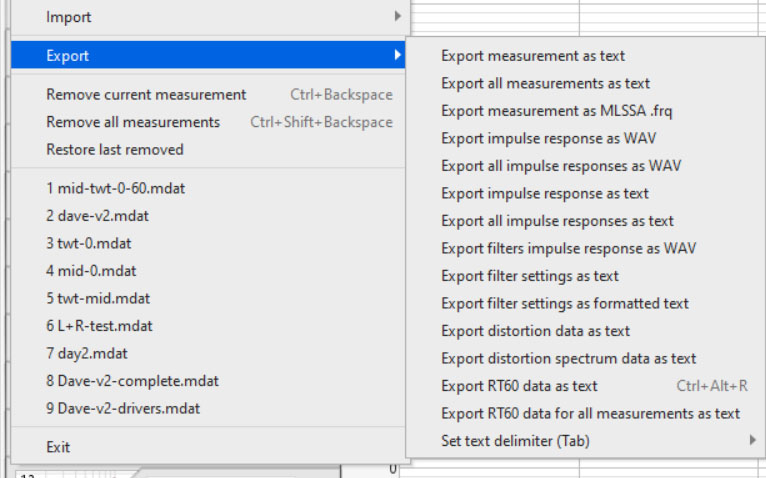

How does a *.mdat file work? Is it some kind of compressed file which contains frequency response measurements?
In order to take a look at these measurements, I will need frequency response curve files, in a standard *.frd or *.txt format.
It's Room EQ Wizard's native file format. Quite comprehensive -- from as single sweep, lot of data is extracted.
I'll see about exporting to other formats. In about 15-30min.

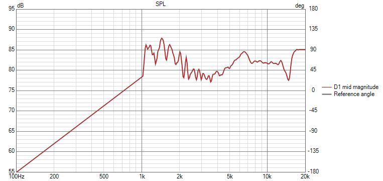

This is what I got for the midrange driver 0-axis

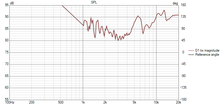

This is what I got for the tweeter 0-axis
Please check to make sure this looks like your data. ... i.e. confirm that I extracted it correctly.

The 5.5k peak in the tweeter response looks suspicious, as others have pointed out. It could be a measurement error. There is also a 5.5 k peak in the NE123 response, and this could be a coincidence, because that is exactly where a 12 cm cone driver would probably have a peak. On the other hand, it could be part of the same measurement error.
If you have a chance to repeat the measurements, it would be nice to start them at a lower frequency... 50 Hz for the mid, and ~ 600 Hz for the GRS tweeter. It would also be nice to verify that you are using a time windowing properly so that these are truly quasi-anechoic measurements. The large oscillations from 1k - 3k in both driver measurements leads me to believe these are non-windowed scans.
But assuming these are valid measurements and assuming you can use the DSP equipment to flatten the response out, it is possible to come up with some passive crossover options.

Non-windowed. Yes. In REW, time window can be applied after the measurement.
But I can redo them tomorrow morn & repost. Export to TXT format.

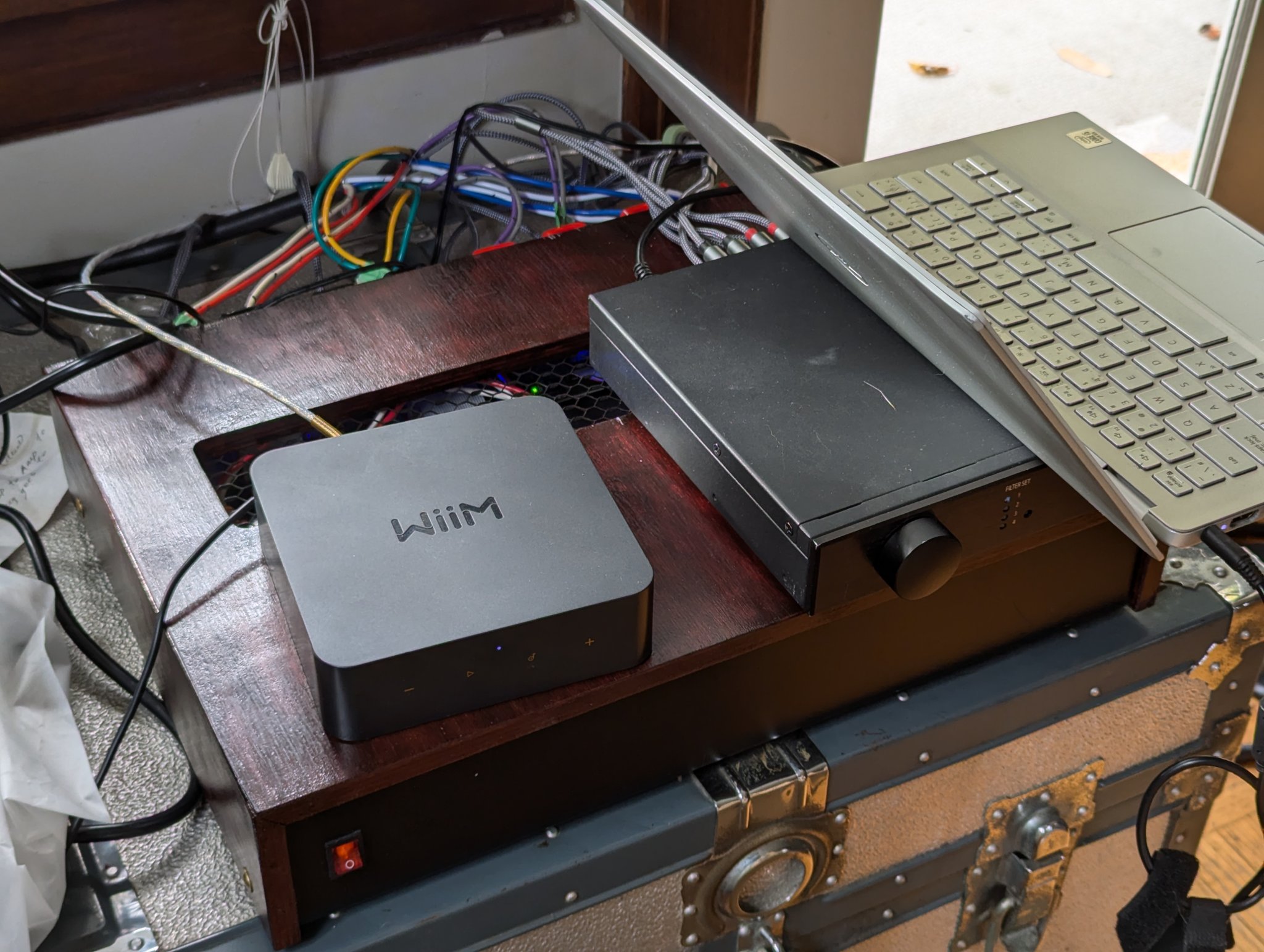

On another note, continuing the transition of these lx521 clones...
I set up the newly modified speakers in my son's place with his help last night. Overall, the sound quality & presentation isn't much changed, based on admittedly unreliable acoustic memory: the spacious dipole effect is there in spades, detail, dynamics... But there's added bass punch & depth, tho sometimes subtle. It's in the acid test of high volume modern rock/pop that the modified speakers + more powerful amp pass with flying colors. At over 100 dB peaks, the room shakes with deep bass, the impact hits in the gut, without any sign of woofer over extension or amplifier clipping. The smooth ease at lower volumes isn't quite maintained but it's not bad. I'm half surprised it's worked out this well; I had visions of a driver or amp module burning out dramatically in this test. Yeah, it was that loud.
A good sub or 2 will help the system stay more composed at such levels and provide better bass.
Funny how these speakers, designed mostly to be neutral high performance HiFi, are doing double duty as a near nightclub DJ rig. 😲 I keep my fingers crossed that all the components are robust enough to do such heavy duty well for good while.
In case I wasn't clear, I did not implement the passive crossover between tweeter & high mid that Jim kindly developed for me. Didn't have time because Dave was missing his system & wanted it back. (He lives in Vancouver & I'm on an island 50km away. Getting back and forth with heavy cargo is only practical by car & ferry and the limited winter schedule of the latter makes logistics challenging.)
But the passive will be implemented when I build & integrate a sub into the system. The 2x300W will then be bridged for 600W mono <80Hz to the sub, and the current woofers will be run on a 2x150W module.
This too is a trial -- I hope the bridged amp is capable enough for the sub, and that the 2x150W is enough for the woofers that become midwoofers. 🤞
