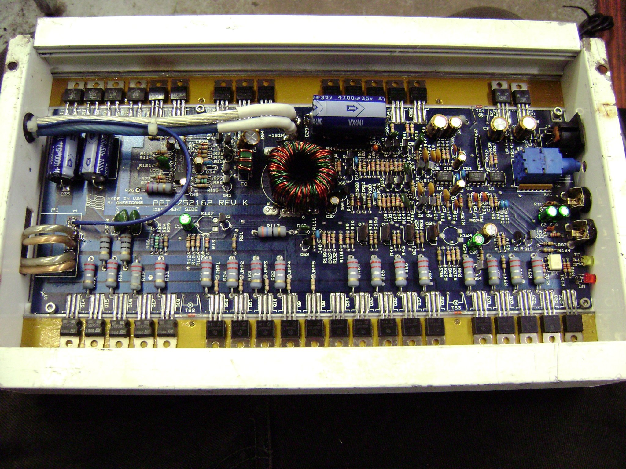

Help understanding upgrade to old PPI amplifier power section!
What is the purpose of adding these components to the original circuit.
I have the same amp so should I do the same if this improves the output?
Also I would need to know the components as well.
The Rev. K board has that circuit already.
About the capacitors. I tend to fit the largest capacitance, largest physical size, of good voltage rating replacement when I do replace them - this is for supply input and output rail only. All else I replace with like components.
Aliexpress will guarantee you get non-genuine articles. I like to use Nichicon VX. How did you determine they are weak? These amplifiers are not hard on the rail capacitors.
Also, a word about cost. Any money spent on a non-genuine part is wasted. Spend what a quality part that will work for years will cost, it's cheaper in the end.
