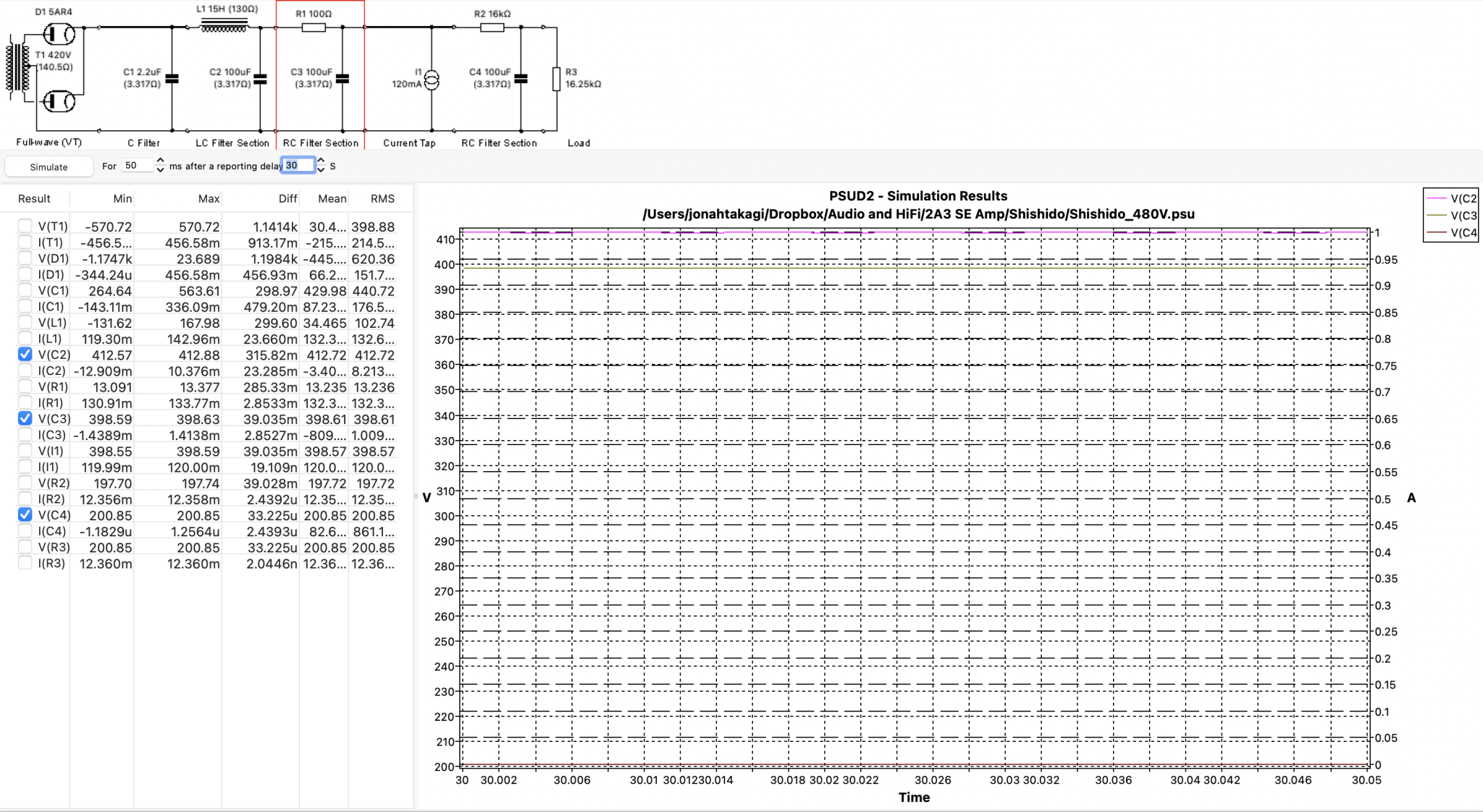

I've got all the parts for a more or less Loftin White 2A3 build, but I realize I'm not totally clear on how a portion of the circuit works—specifically the area I've circled in red. I've been familiarizing myself with a variety of Loftin White-inspired circuits and most of them seem to have a hum pot on and cathode resistor and cap on the 2A3. This one does not and would love some insight into what is happening in this section. Perhaps it's obvious, but it's all new to me. Wanted to start with a simple circuit as my first ground up from schematic build.
After some poking around online, I've found that a 6SQ7 is a suitable replacement for the 2A6 (different heater and base). That said, I've got a couple of 6SL7 tubes on hand and would like to save some money. As far as I can tell, the circuit is only using the triode portion of the 6SQ7 and my question is can I use a 6SL7 instead (only one triode section)? They seem pretty close in spec however the amplification factor is different as well as more plate current draw and higher transconductance. As long as my power supply can handle the extra current draw how will the amplification factor play out downstream?
Thanks in advance!

This is not a simple circuit for beginers to tweak , you should build it exactly as it is . In the red square is the cathode resistor for 2A3 ( 3K 20W ) , the cap in parallel C3 and a cap to B+ C4 , probably for ripple canceling . The rest is a resistive divider R6 - R5 to the 2A3 cathode and filter C2 that is generating the supply voltage for the driver tube .
It is direct coupled so you can't just replace 2A6 with some other tube you want , the plate voltage must be 150V as it is the voltage on the 2A3 grid

Thanks @Rikaro it makes a lot more sense. I did plan on omitting the meter as all the nice ones were a little pricey.The 2A3 cathode current runs through the low resistance current meter in series with R4.
C3 is the cathode bypass cap.
If no suitable current meter is available it could be replaced by a jumper.
One other thing, I'm reading the "N" on the 2.5V filament in the schematic as a center tap. Is that correct? My PT doesn't have a CT on the 2.5V secondary and I intend to use a couple of resistors for a virtual CT. Any issues with that downstream?

Thanks for this @6A3sUMMER. Just to be clear we're talking about the resistor value for the virtual center tap, correct? The goal is to have enough damping? Would this impact the input driver tube, the 6SQ7?
My PT will output 2.5V at 5.5A so should be good. I went overkill to someday mess with DC filaments... someday.
Good point!Rikaro,
50 Ohms x 4.2 = 210 Ohms
800 Ohms + 210 Ohms = 1010 Ohms plate impedance, rp, (versus 800 Ohms that IS Significant).
So that would mean about 0.3W less output and ~20% increased source impedance.
BTW, also the OT primary DCR adds losses and source impedance.
Slow warmup of the rectifier is essential in this circuit - if rectifier heats faster than the input tube, there will close to 300V on the 2A3 grid instead of 150. 5V4 is same as 83V but with octal base, much easier to find. Likewise powering it with driver tube missing will destroy the 2A3 as well.
Thanks @Tom Bavis. I have both a 5U4GB and a 5AR4 on hand. I plan to use the 5AR4 for the soft start and working on finalizing a design for a choke input PS with a small 2uF tuning capacitor before the choke to get the B+ to 450V DC - my PT has 420V and 480V CT secondaries. Also, considering a thermistor to slow things down further.
