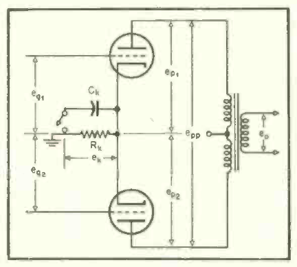

Help understanding cathode bypass capacitor
As long as we are here, what characteristics should we look for when buying an electrolytic capacitor for output stage cathode bypass use? Both SE and PP. Low ESR? Leakage current? What characteristics make the Nichicon UKA series "audio grade" capacitors (their words not mine)?
