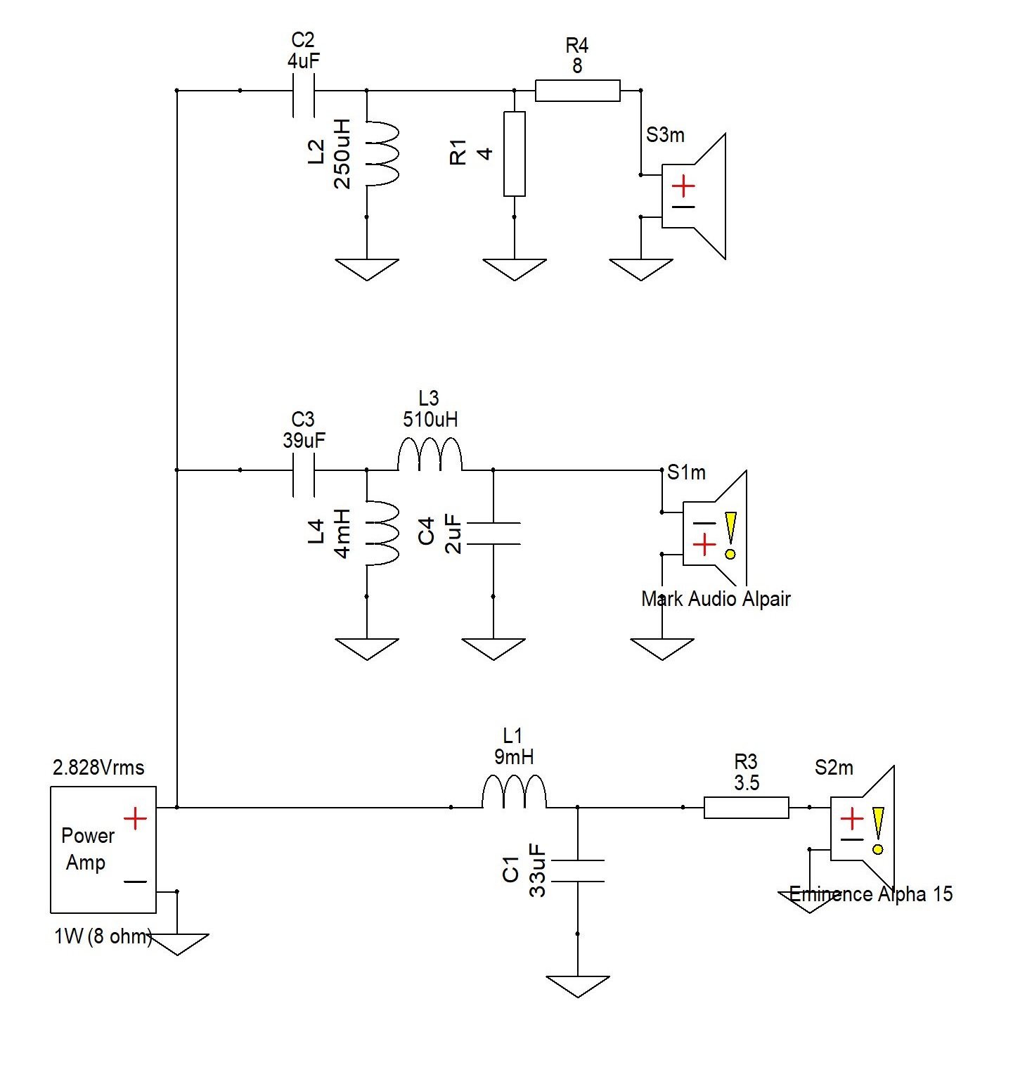

Hello all,
I'm in the midst of tweaking my 3-way crossover and I could use some help. My drivers are an Eminence Alpha 15 woofer, a Mark Audio Alpair 12P midrange and a GRS PT2522 planar tweeter. They are in an open baffle. Here is what I have
I realize having the resistor in series on the woofer is not ideal.

Things I'm thinking of doing:
changing the 68uF cap to the woofer to 33uF to smooth the spike at 250K. Change the 1.1uF cap on the LP filter section on the midrange to 5uF. Increase the values of the resistors on my tweeter L pad.
I tried an L pad on the woofer and it sounded terrible. I didn't have a bunch of values of resistors available for use however. I tried resistors in the 2-3ohm range. What would you recommend to attenuate the bass?

The configuration makes a considerable difference, not least when using an open baffle.
You might tune while measuring one driver at a time between each crossover change, or you could import those into Xsim.
If you get it flat and it still doesn't sound balanced, you might consider doing polar measurements.

I know that I really am not being scientific about this and should be measuring each driver in the baffle independently. That being said, here are some tweaks I've come up with. I'm new to x-sim and I think I needed to adjust the sensitivity of the tweeter to match the specs, even after uploading the .frd file. Here is the new x-over and the new frequency graph:
I know that this will be different in my baffle but I'm kinda eyeballing it considering the measured frequency response from before
I would try a 6 and 6db series filter with just the Alpair (no tweeter) and pass them over as low like 80 hz.
With the series filter the big bass is filtered with a big capacitor so its not expensive to filter it that low.
