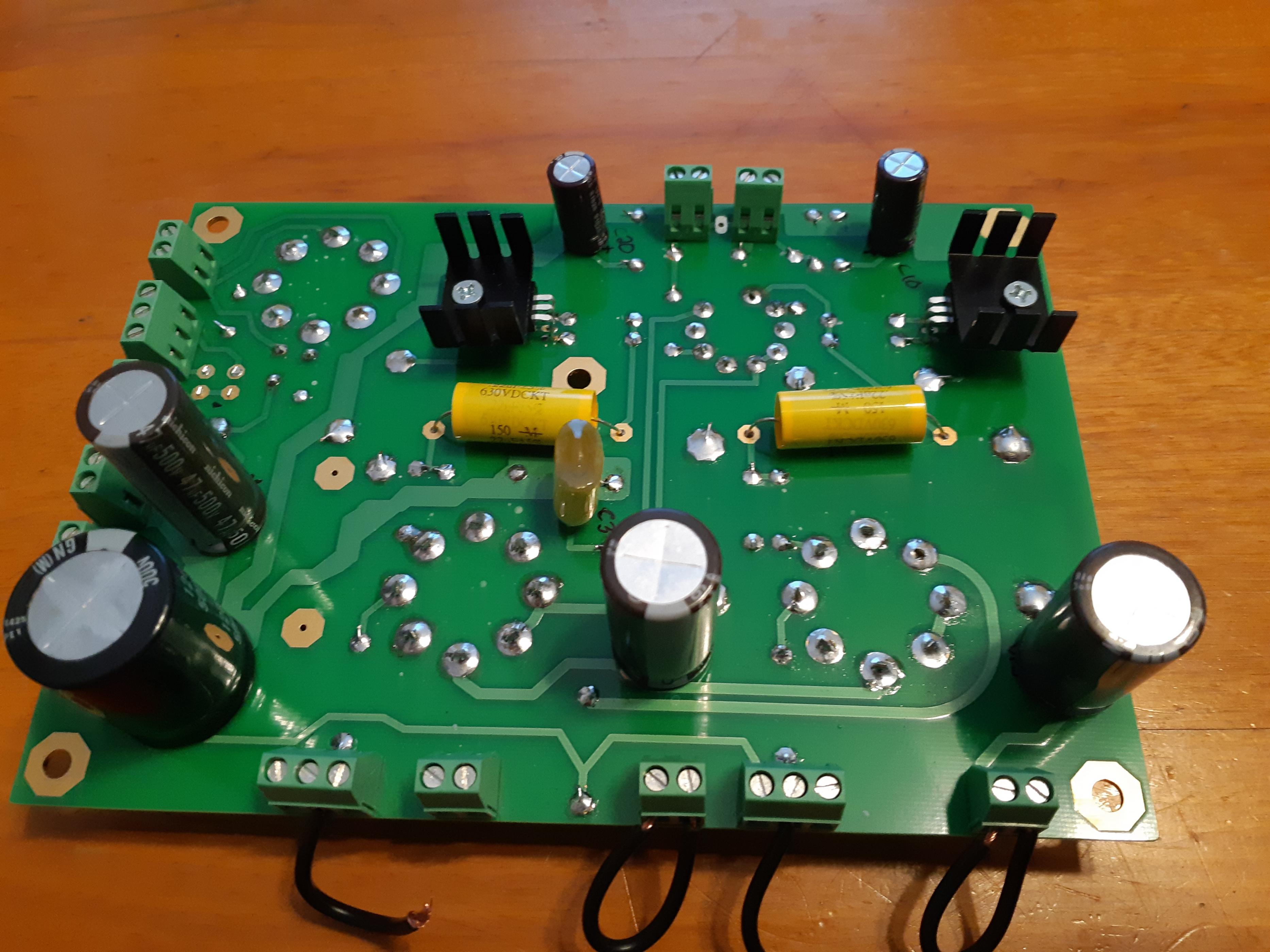

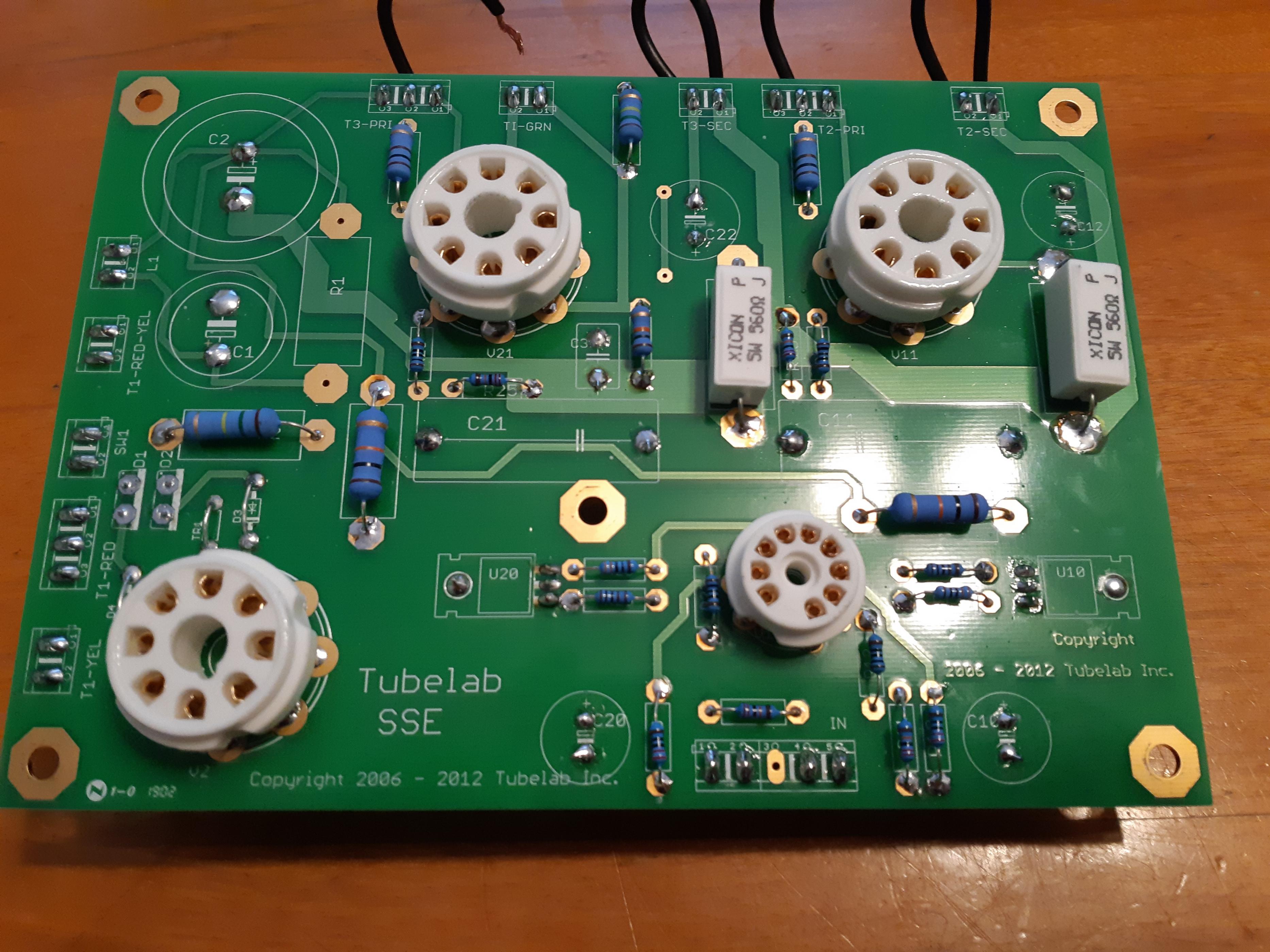

Here's pictures of my board. I'm a beginner so please constructives advices or comments.

The best advice I can give you right now would be to go back and check your soldering on all your resistors especially your coupling caps, looks like a majority of them may need a bit more solder to make a solid connection. You want them to look like a little "ant hill"
If you have a multimeter I would take that and ohm out all your resistors going from solder pad to solder pad across the resistor to make sure you have continuity across the resistors, do not touch the leads of the resistor with the meter leads just solder pads. If meter reads OL or nothing there is your open.
I'm sure someone will chime in about what else to checkout for not having sound in the left channel.
