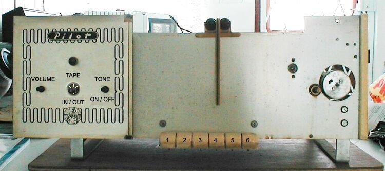

Pilot Radio
Pilot Radio certainly used to have a factory in the UK, in London NW10, from the 30s to the 60s I believe. Whether they made their own sets or simply assembled US sets adapted for European customers is a different question.

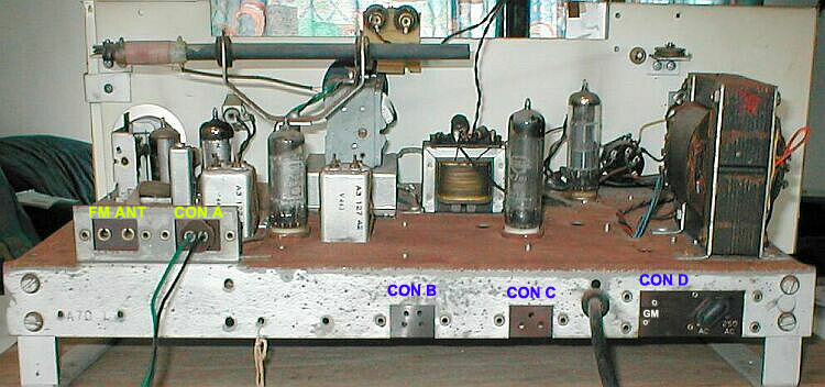

The only identification I can see on Djev's set is on the back of the chassis, on the left hand side - it looks like A70 (or possibly 470?) but I cannot identify this set from any schematic I have.
I think that Djev might have to go to one of the vintage radio websites to pursue this further.

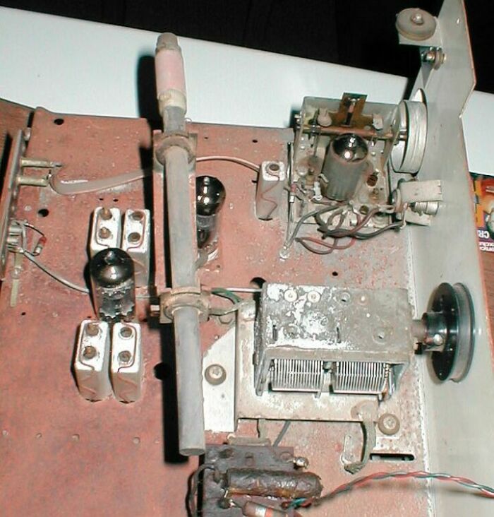

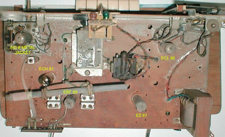

Thanx for all your help. I replaced the broken ECH81 with a nameless tube which got almost the exact same appearance, got some of the correct nylon string and a spring, figured out a way to connect all rollers and pulleys with it, and switched it on and waited for a bang 🙂 No bang, no smoke, no nothing, just a nice green and red lamps glowing and all tubes glowing slightly. I measured on speaker connector, nothing - no AC no DC. Connect an old speaker and a piece of wire to FM ANT. connector, still nothing. Start turning the frequency knob, MUSIC. Loud and clear. It seems to work perfectly from about 88Mhz al the way to about 108Mhz FM. Not very loud , just good for small room listening. Reception with wire ariel, very good. It turned out that selector 6 is for FM and 5 for AM, though I only received 1 AM station.

Well done!
I think that maybe it only works on FM?
That would be the case if the ECH81 was replaced by something not quite compatible. It's job (as I mentioned earlier) is the AM oscillator and mixer. But on FM it (might) be an IF stage (or not).
The volume level:
Could be due to low emission valves, or the wrong one.
Also, the sensitivity of an FM tuner of it's kind will not be as good as a modern one. Just give it plenty of signal and make sure to tune critically - slight mistuning with a "ratio detector" causes appauling distortion.

There are 3 ECH8x type tubes that look very similar. The US equivalent to the ECH81 is 6HU8 if I recall. I think I have several lifetime's supply of these 🙂
Regarding E/PCL 83, 82, 86:
E/PCL83 has a rather unusual pairing of a rather big output pentode (for a bulb that small!) with a low mu triode. The latter is probably why it went out of favor in consoles - you needed extra amplification for a turntable. This same thing seems to be the reason for E/PCL86 taking over for E/PCL82 - slightly higher power from the pentode, and an ECC83-like triode with a mu of 100, simple to hook up a turntable with more than enough ampliication, plus extra for NFB.
E/PCL83 and E/PCL82 were used much longer in televisions, as parts of vertical deflection circuits, also a second PCL82 for audio.
JDeV said:I replaced the broken ECH81 with a nameless tube which got almost the exact same appearance

The ECH81 has no subsitutes that I know of, other than (probably) a US equivalent number. I can't access info at present.
It is used as an oscillator (triodes section), and mixer (heptode section).
Probably, Russian 6И1П (6i1p)?
The whole thing looks like Telefunken, may be made in SA.
