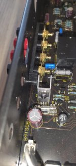

Hello,
I started to try to understand the principle of the schematics and why would the relay go off.
I understand that there are some DC current feeding relays and other stuff. These components are hooked to a radiator. I started to look at u10 and u5.
So u10,
Amp idle you have 14v ; ground ; 0
Turn amp on : 14v ; ground ; more than 10. This decreases and when goes below 5v amp goes off.
After a while off now showing 8v ; 0 ; 3.5v...weird
Then, is there a problem with that component or is there something counter feeding the output to make voltage lower because of a problem
  • A21-AMP.pdf
    A21-AMP.pdf
I remember when speakers were hooked I was surprised to find 12 ohms sometimes between the two red speakers connectors.
I had a spark at u10, call me stupid.
But amp is still on and sometimes output impedance goes at 2 ohm, then OL on both side. Volt meter or something wrong...
Why doesn't he go off, did I finally smashed the protection circuit u10 ? All voltage are around zero on that one. If it still runs I will try too hook some test gear
