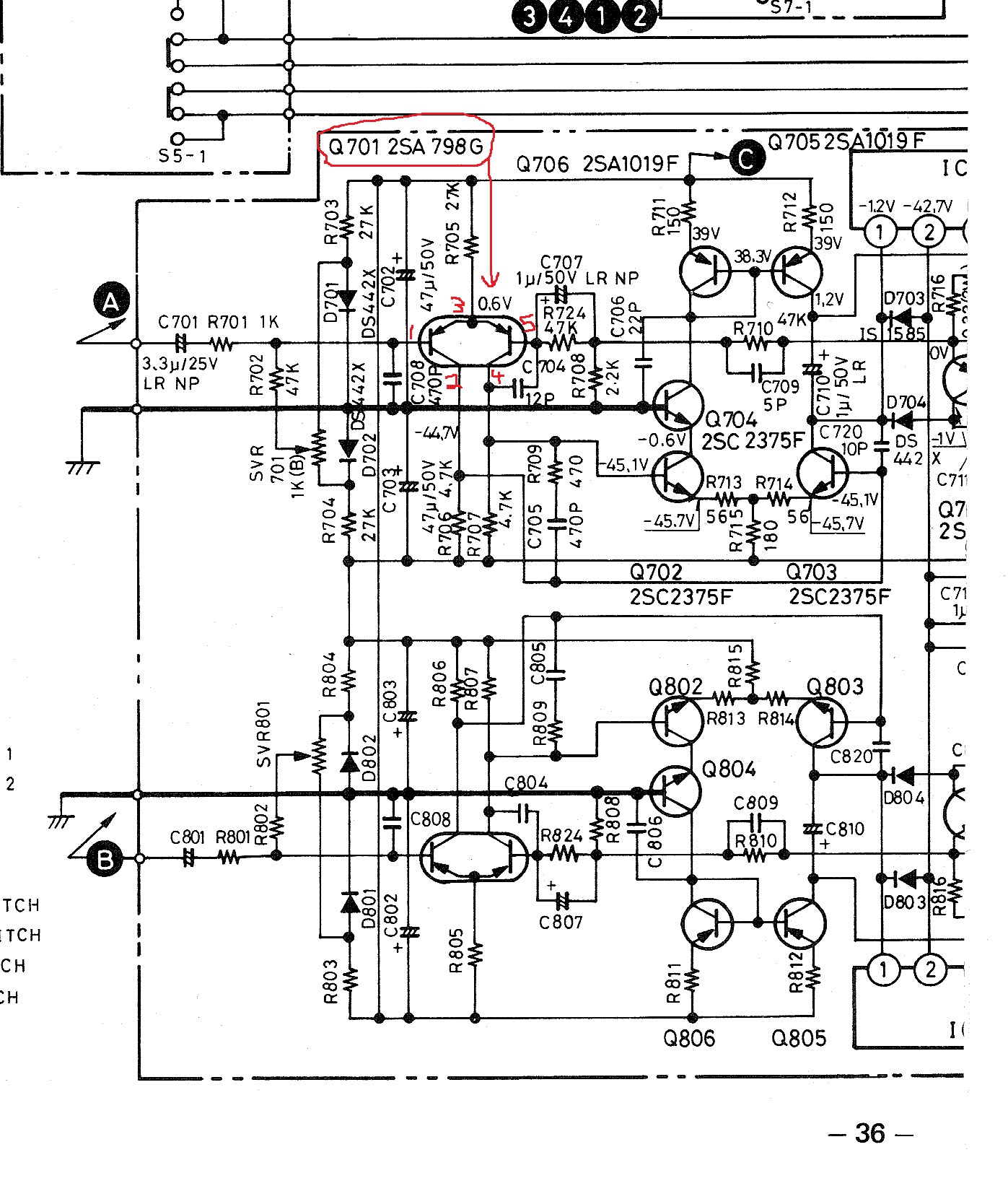

I have a left channel distortion caused by my hand slip. The signal looks good going into the amp circuit, 1khz sine wave. At Q701 (2SA798) it starts to distort. I replaced the 2SA798 with one I got from eBay and it may be bad. I pulled all of the other transistors in the circuit and they check ok using the diode and hFE functions on my meter. I was a licensed tech 40 years ago but it is really just a hobby now.
Here are photos of the scope readout and that part of the schematic.

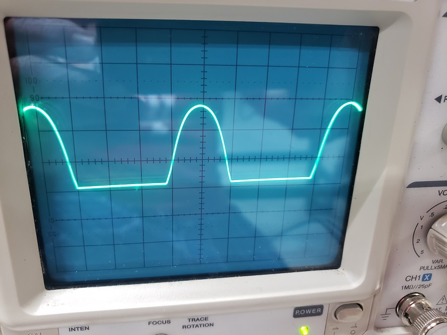

This is PIN 1, 200mv
attachment.php

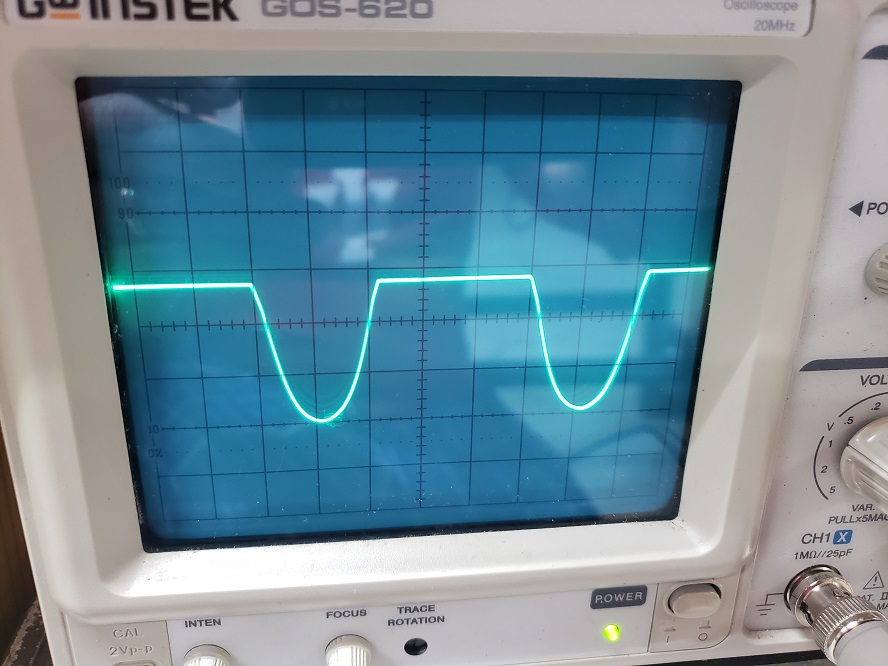

PIN 2, 2.8v
attachment.php

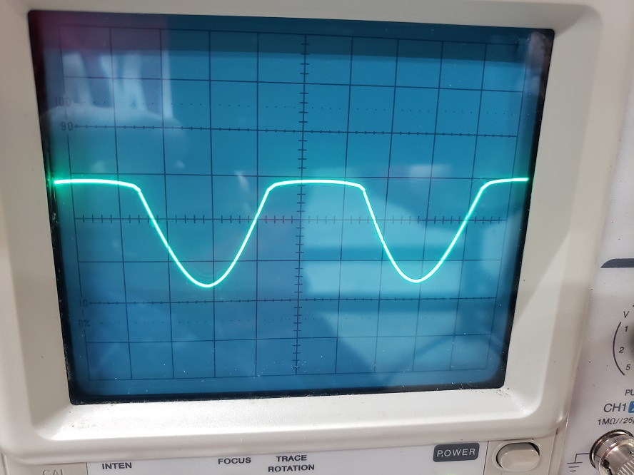

PIN 3, 130mv
attachment.php

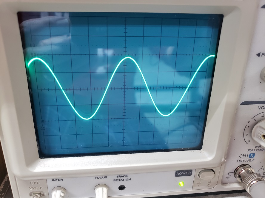

PIN 4, 2.7v
attachment.php
PIN 5, 130mv
attachment.php
SCHEMATIC with numbers, "A" is the left input from the preamp.

Looks ok since both sides are similar, could be another part in the circuit.
Can you check the DC voltages in the next stage, Q702, 703, 704, 705, 706?

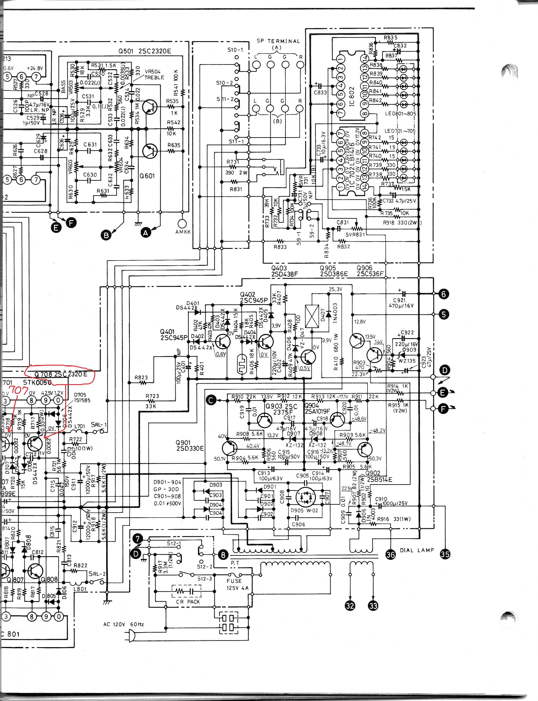

Here is what happened:
I built 2 discreet versions of the STK-0050, I installed one in the left channel to test it, the STK-0050 was working OK. My dumb *** put a wire too close to a bolt and blew the discreet version. I put the original STK back in and the left channel was dead. I found two transistors Q707, 708 that were bad so I replaced them, it worked but started getting distortion and the sine wave was clipping. I thought the 2SA798 was bad because the sinewave started clipping there. I still have another discreet STK I think I will put that in and test it.
