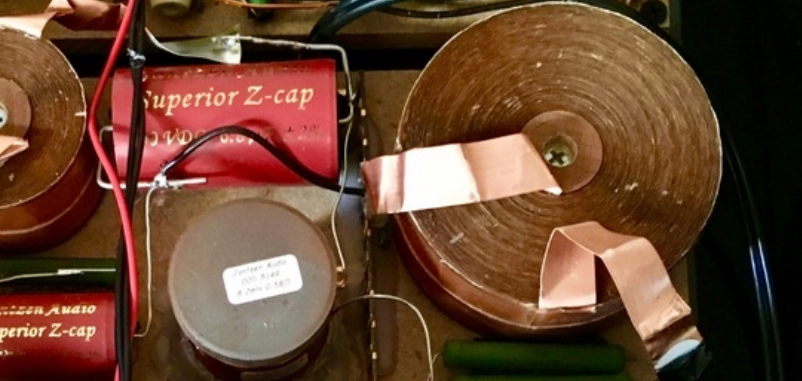

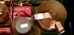

Hello, I have Troels Gravensen loudspeakers, specifically the Jensen ATS model. Jenzen-ATS
Made some changes such as improving or, if you prefer, adjusting to my sound tastes, various caps of the crossover. Seeing the changes that choosing one cap or another can generate, especially those dedicated to high frequencies, I wonder if this is also important in the choice of coils. The cut-off on the ATS is at 2200 hz. Therefore, there is an important area of ​​high frequencies that correspond to the mids speaker. The ATS works with a second order filter and uses a Jantzen model WAX 1.8mH, 0.37omh and 14 AWG coil in the mids section. My question is the following. Could you improve the sound by replacing this coil(respecting the original values)? If the answer is "yes", what makes and models can be suggested?
BR
Toñi
If by respecting the original values you mean maintaining the DC resistance of 0.37ohm, which will have been factored into the original crossover design, then I don't see that your inductor can be bettered.
The AWG dictates the resistance of the coil. Making a coil with thicker wire will, of course, reduce the resistance. This reduction will alter the sound, but not necessarily for the better.
Don't change the nominal inductance and DCR values to make sure the xover still works as intended.
That said, different inductor types can make a small sonic difference. Air coils will have less non-linear distortion than a coil with a magnetic core that will saturate at some point. Also, mechanically stable coils will cause less non-linear distortion (resin impregnated coils ans similar). Finally, there are foil type inductors that are mechanically stable and may also have less skin effect (don't ask me to provide proof for this).
Hello, thanks for your help and opinions. As I had commented in the first message, i started from the idea of ​​respecting all the original values ​​of the coil. The point is that I have found that both the caps and the resistors generate obvious changes in the sound of the loudspeakers (with the same values). Therefore, I thought that the same happens with coils. Specifically, the one used is an air core and ribbon coil. As is known, Troels is limited to a single brand to make his designs. This does not mean that it is the best or the one that others like. Hence my idea to investigate other possibilities. I understand that from your experience it seems that great improvements cannot be expected by changing coils.
BR
Toñi

Frankly, the idea that caps and resistor can generate obvious sound difference, without a double blind test is foolish. If you have money and time to waste continue with this idea and buy some coils with roughly the same DCR (say from 0.3 to 0.45 Ohm) and perform the test. There are both "normal" air coil and cored coils with quite exactly the same DCR of yours.
True, but a cored coil from a reputable mfg won't saturate for hi-fi use, even when used at high power levels.
Again, true but buying non baked coils for saving pennies is pretty stupid.
Finally, let me say another thing. The 1.8 mH coil is in series to a 2.35 Ohm resistor, for a total of 2.7 Ohm resistance in series with the driver. I'd have chosen a much smaller 1-1.2 mm wire air core coil and adjusted the resistor to match the 2.7 Ohm total resistance.
Ralf

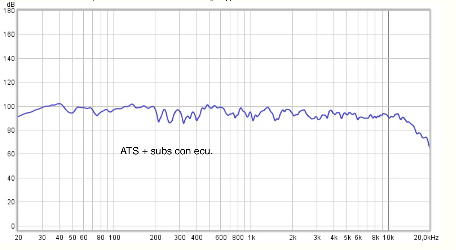

Hi, thanks for the answers. It is true that reviewing the prices of coils from brands like Duelund, the cost shoots up quite disproportionately. I think the idea of ​​improving the main coil of the mid crossover doesn't have much of a future. Some time ago I decided to remove the filter from the bass to use a Hypex 501 amplification module and filter on active. This way I can equalize to correct room problems. Perhaps another interesting option can be to remove the resistors from the mids ( Troels G, “ The 18H mid is a bit too efficient for the 10C77 bass, thus minor attenuation provided by R2031. To stay cool I use 2 x 4R7 in parallel for R2031. ”)and adjust the wofer (active) and tweeter (adjusting resistors) to their level. In this way, the sensitivity of the assembly would improve, facilitating the amplification work.
BR
Toni
