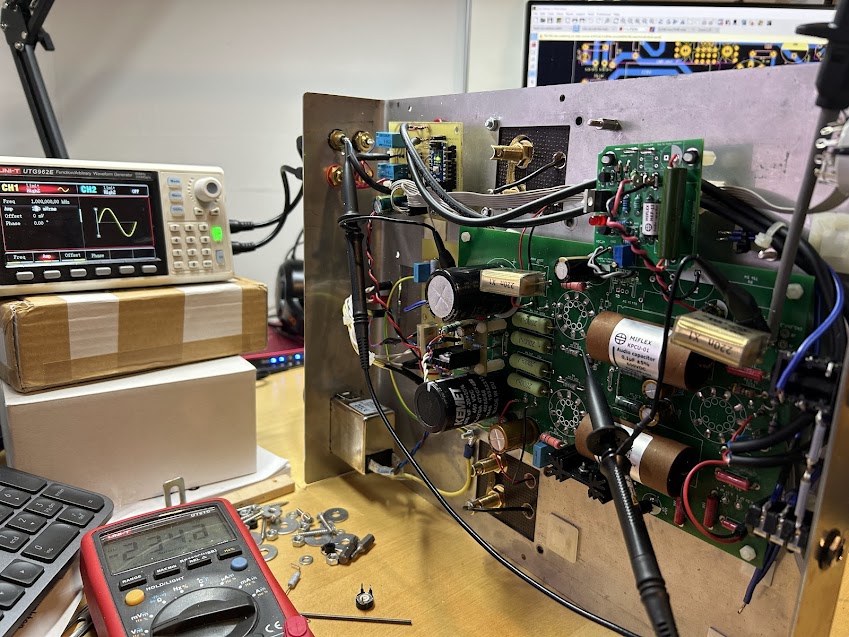

Hello, I need some help to understand why my amp is clipping.
When the input signal bigger than 330mV rms, the lower half wave start to clipping. If I increased the input signal then the upper half wave start to clip. I was not able to reproduce the lower half wave clipping in LTSpice, but exist in the real amp.
I would like to know what causing the lower half wave clipping, and what causing the upper half wave clipping.

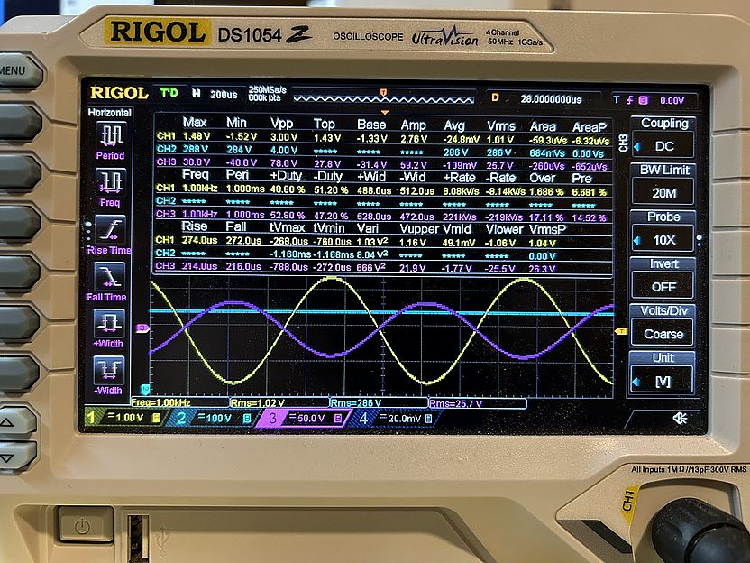

I tested the following: I pulled out the EL84 output tubes, so only the ECC88 was in, then I put the scope probe to the coupling capacitor leg, no cipping after the ECC88.
When I put the EL84 back (scope probe not changed) the lower half wave clipped after ECC88.

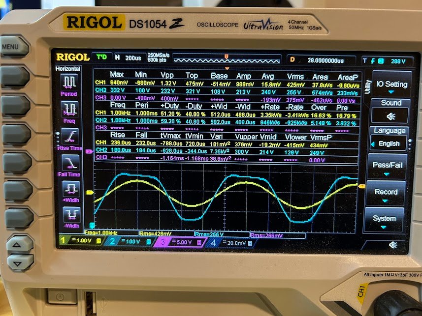

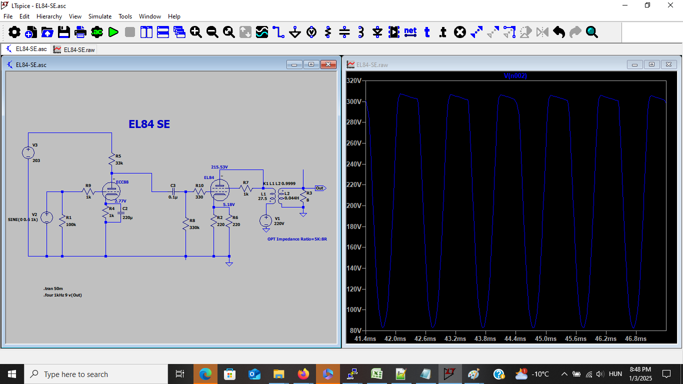

The simulation shows the Anode voltage of the EL84 output tube.
The pictures shows same Anode voltage of the EL84 output tube.

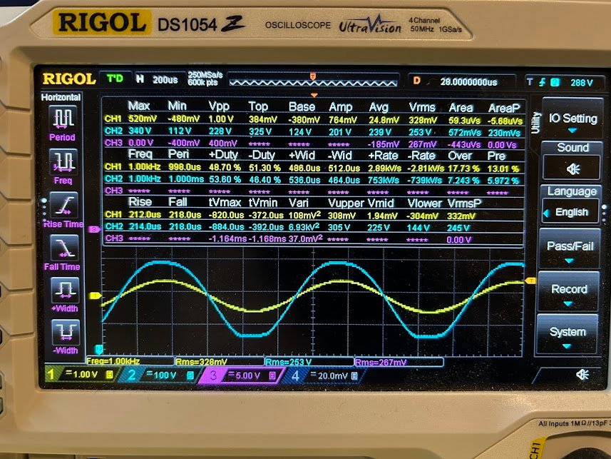

There is too high ac-voltage at the g1 of EL84. G1 to cathode (bias) voltage is - 5.2 Vdc, so the clipping start when ac-signal at g1 of EL84 exceed some 11...12 Vpp, i.e. some 4 Vrms. So 330 mV at the grid of ECC88 is too much.

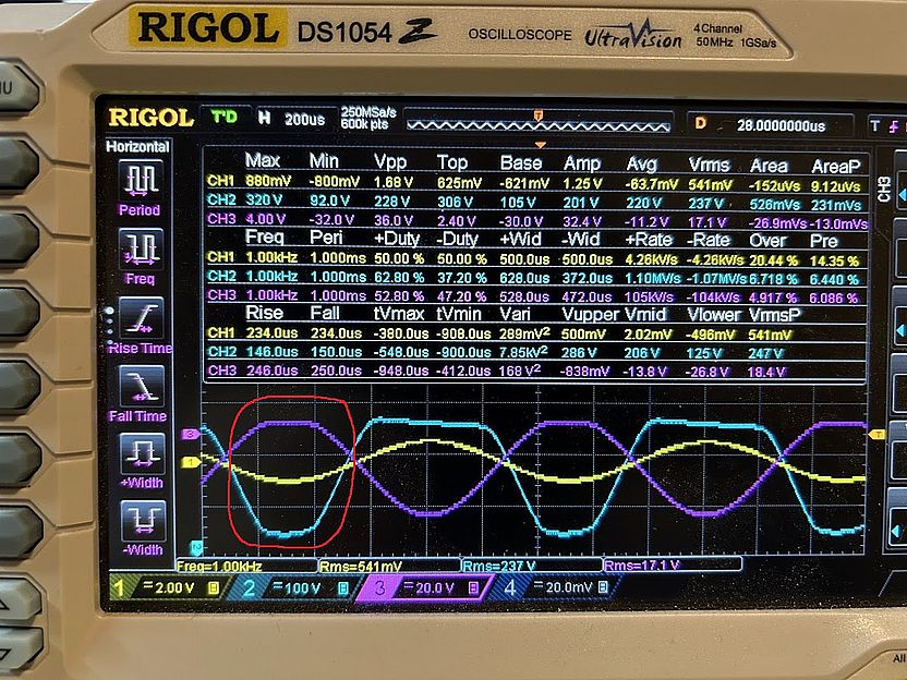

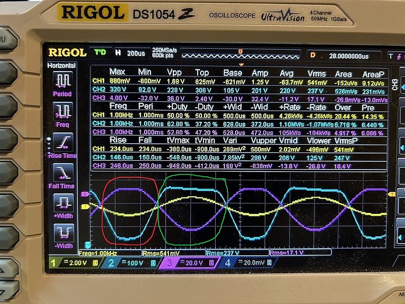

Yellow - Input signal ; Blue - EL84 Anode ; Magenta - after coupling capacitor of ECC88 stage
So if I understand it correctly, the red marked clipping caused by the overdirve? And what is the green marked "sharp" clipping
And why the output signal of the ECC88 influenced by the EL84? I mean there was no clipping if the EL84 was not installed, but started to clip when EL84 was in place at the same input signal level?
Sorry, but I have some gap in my knowledge, and I would like to understand what's going on.
I also realized that the R8 330k resistor lifting the signal after the coupling capacitor (relative to the ground) so the signal is asymmetric to the 0V

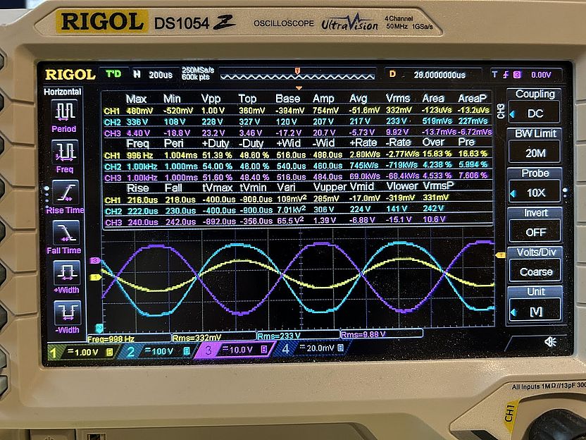

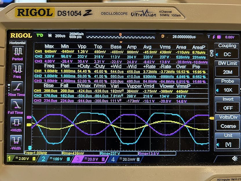

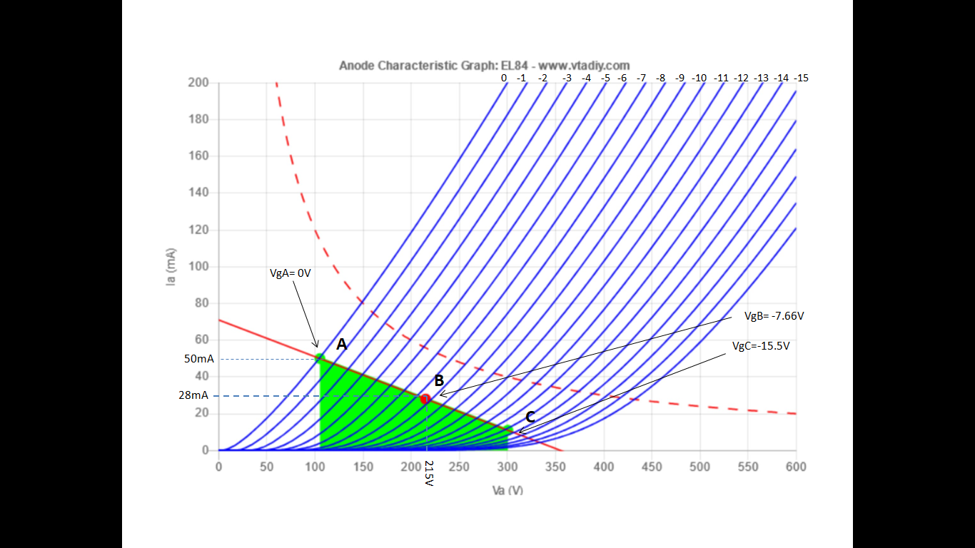

I used the loadline calulator:
Universal Loadline Calculator
The Slope of the Loadline determined by the Output Transformer (I already have it) 5k:8Ohm
Point A is the maximum plate current, according to the datasheet 48mA let's say 50mA
Point C is the maximum plate voltage according to the datasheet 300V
Point B is the operating point in the middle between A and C
So based on the graph 215V and 28mA should optimum. I guess
Is that theory correct?
Yes, but because you have cathode bias, you should subtract the cathode voltage to figure your plate voltage point. So, if you are restricted to only 215v for a supply voltage than you won't get the most power the EL84 can give you. You are well under the best Class A power dissipation that would be closer to 12W on the plate. I estimate you can create about 1.5W of signal power at the EL84 plate and a final output power of 1W with your triode configuration.
Did you check the driver output signal with the EL84 in place? When you pulled the EL84 and the signal stopped clipping, it was because your voltage of B+ jumped higher without the output tube load on the B+. It likely changed the operating point of the driver. Is your PS transformer too small for normal circuits of this type?
The load line shows the quiescent (DC) operating point at 215v/28mA, but the circuit diagram and voltages show it's 220v/47mA.
The circuit diagram shows no bypass capacitor across the cathode bias resistor, but the load line graph assumes the (AC, i.e. signal) bias network has zero impedance. It's important to distinguish the AC operating point from the DC operating point.

Thanks for the suggestion. I also realized, without the load of the EL84 tubes the raw DC voltage was higher. But I'm using a regulated voltage for ECC88, so the increased raw DC not increasing the plate votage of the ECC88. So the driver tube signal clipping (or distorsion of the sine wave) I think should be something else. But I'll double check it.

To understand my journey better, 5-6 years ago I have built a headphone amp, based on one of my friend's schematics. But after a few years I realized, the schematic is very similar to Zen Triode amp, so I ordered an another Output transformer, and changed it to be able to drive my speakers. Then the power supply part of the amp has been changed etc. I figured out, the original operation points are not optimal for the current usage, so therefore started to simulate it in LTSpice.
So the schematic in the first post is the slightly modifeid one. I started to measure the amp (attached the scope pictures) but the output stage is behaved strange.
So I'm trying to figure it out how to modify the output stage to work better.
