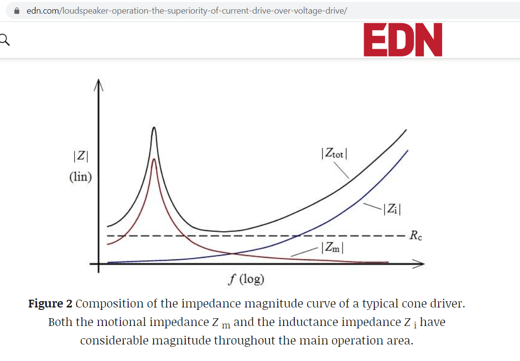

This image and associated text in the article is one thing that made a lot of sense, where "voltage drive" or "current drive" would be usefull:
Cone movement varies the Zi. Reduce effect of varying Zi by increasing external impedance in the circuit where Zi is significant. Zm in turn is the driver resonance which in turn would benefit minimal circuit impedance for electrical damping, reducing movement.

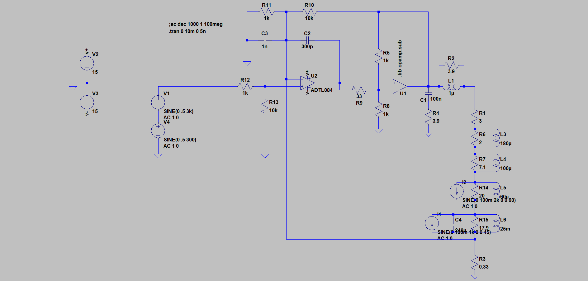

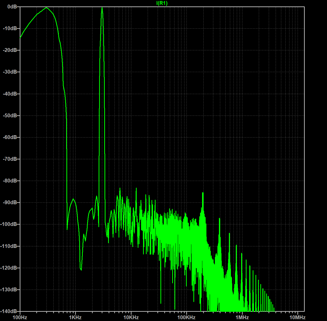

Some simulation again, this time with two disturbers (1kHz & 2kHz, each 100mA) within the load. Driving signal as before 300Hz & 3kHz
Attachment 1: showing where the disturbers are mounted
Attachment 2: simulation voltage driven
Attachment 3: simulation current driven
Attachment 4: simulation file
in this simulation i think the benefit of current drive is obvious
spectrum_300Hz_3kHz_disturbed 1k-2k-100mA-voltage driven_blackman-harris filter.png22 KB · Views: 129
spectrum_300Hz_3kHz_disturbed 1k-2k-100mA-current driven_blackman-harris filter.png21.5 KB · Views: 126

Have you validated the simulation model by measuring the distortion in reality? There're a lot of variables in SPICE simulations (step size, for example) that can throw off your THD results. Some opamp models don't have distortion included in the model. Etc., etc. I'm not saying this is the case for you – I have no insight into that – I'm just saying that it's something to be aware of with simulations of distortion.
Tom
Tom
The model for the power amp is a very simple one and i did not expect it to be perfectly exact. It is a little optimistic, but it comes close - at least in simulation for the voltage amplifier shown and a resistive load. The step size i use is very small (max. 5ns/step) - this lowers the "floor" .
I am aware that the picture simulation result shows can not exactly 1:1 be transferred to reality. But that was not the point here. I just wanted to figure out how current drive works. And now i think i got it. The "disturbers" that i modeled as current sources within the load have no effect on the signal curent when the load is current driven. Assuming it is the current that "transferes" the music i expect the resulting sound to be (at least a little) more transparent. I have to proof that on my system. The "disturbers" have not dissapeared, but now they "disturb" the voltage across the loads connectors.

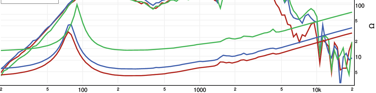

The situation is not as extreme as you say , by any means.And now, self inductance of the coil! But this, is mounted on a solid iron former, which means, eddy currents, in the iron former cause self inductance effects to be extremely opposed. The effect is much like talking about a transformer primary with the secondary being a shorted thick copper single turn.
Is the residual inductance worthy of consideration?
Voice coil inductance is so much a thing that it´s part of Speaker parameters, go figure, and OF COURSE it causes the huge rise of speaker impedance at higher frequencies, up to 2X or so 😱
You call that "not worth of consideration?" 😱
Well, there is a thing calles "mixed feedbak", guess wherevthe nan comes from 🙂I don't understand why you keep both the voltage feedback as well as the current-derived feedback.
One will lower the Zout, the other will raise it.

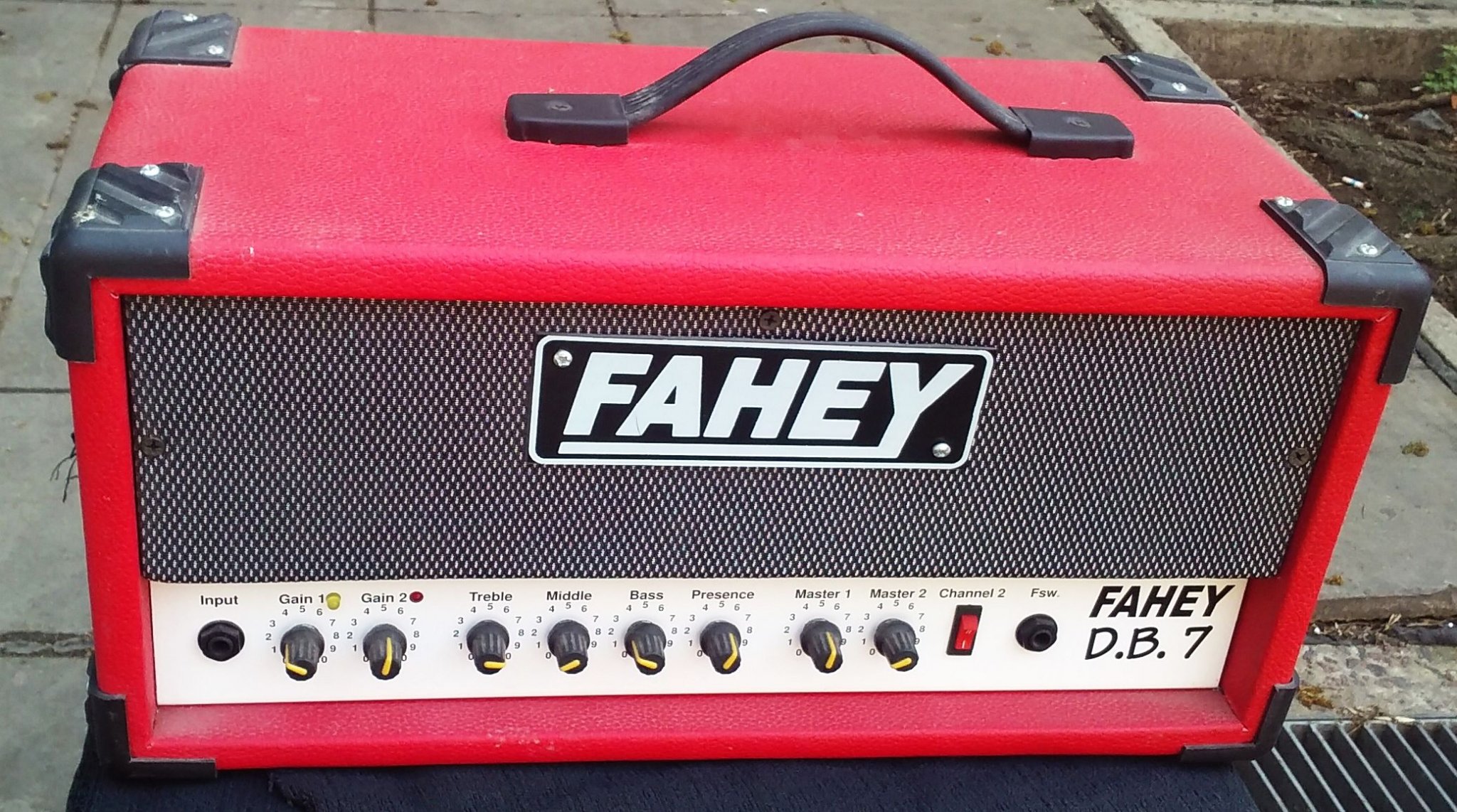

By the way, the MOST used high impedance factor amp users in the World today are Guitar amp makers (by the hundreds of thousands), not Hi FI or any other marginal market 😉
Does your load vary with frequency, and if so, does your amp's output impedance?Well, there is a thing calles "mixed feedbak", guess wherevthe nan comes from 🙂
And it´s used where you want definite values of output impedance between zero (perfect voltage source) and infinite (perfect current source).
As in my own use: unity damping factor, or internal impedance =load impedance.

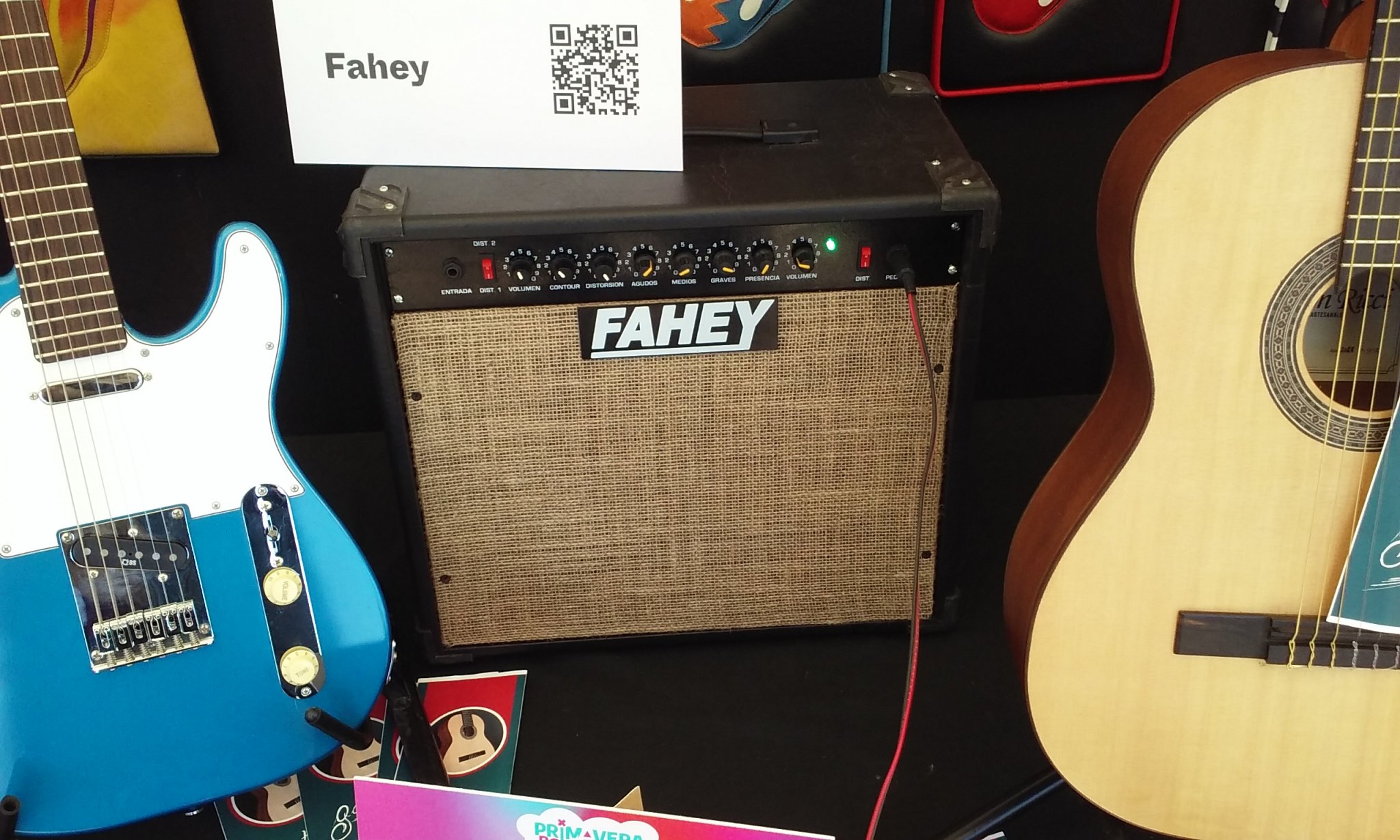

FWIW last Saturday there was an "Entrepreneur´s Fair/Show", including those related to Musical Instruments, and I was asked to send a sample, so I gladly obliged.
It was held at the City Stadium at La Plata , the province´s Capital, some 45000/55000 young visitors assisted.
why do I mention it? .... because it was the only SS amplifier amongst all kinds of Tube ones also shown there ... and musicians kept coming back, go figure.
part of the "special sauce" behind that? ....
well, high impedance low damping mixed feedback, of course.
Might have used pure current drive, but then sound becomes too extreme, razor sharp chest thumping, "too much of a good thing is not good any more" 😉 , which I reserve for Metal heads:
