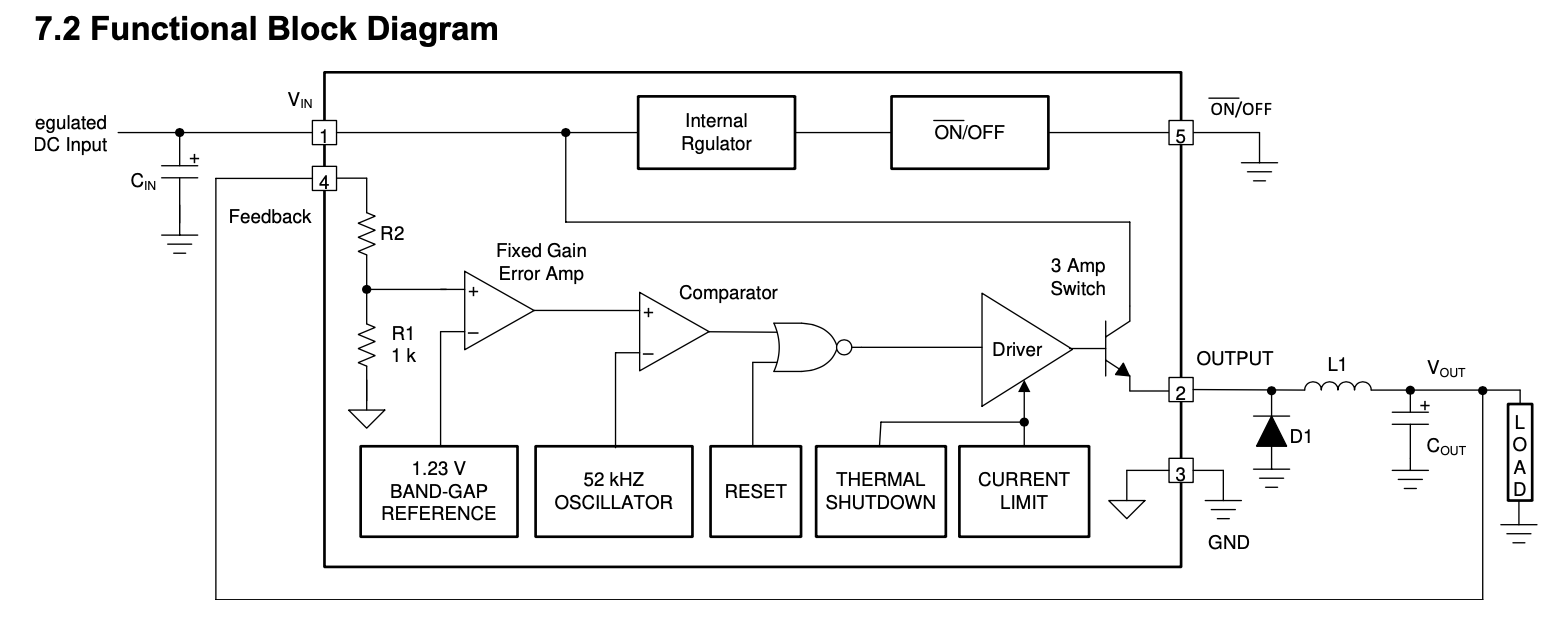

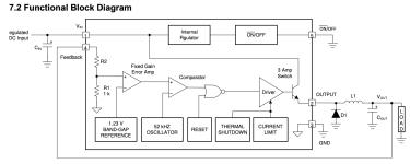

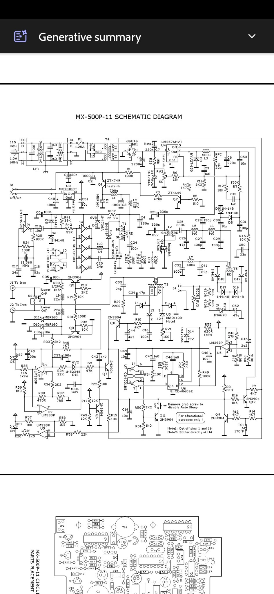

So I've bought another Metcal MX500 for a spare and it doesn't want to heat the Iron (Iron has been tested ok) working through the document attached page two has voltages from working units, mine tests OK until I come to U4,
Pin 4 measures 261mv dc
Pin 5 bounces around low mv
However Pin 2 when switched on, light green and iron connected is measured at 56vdc not 18vdc like on my working unit, does this point to U4 being faulty?
any help welcomed on this
Quite possibly a short circuit switching transistor as this is a simple switching regulator; see attached.
Check to see if it is switching before condemning it.
