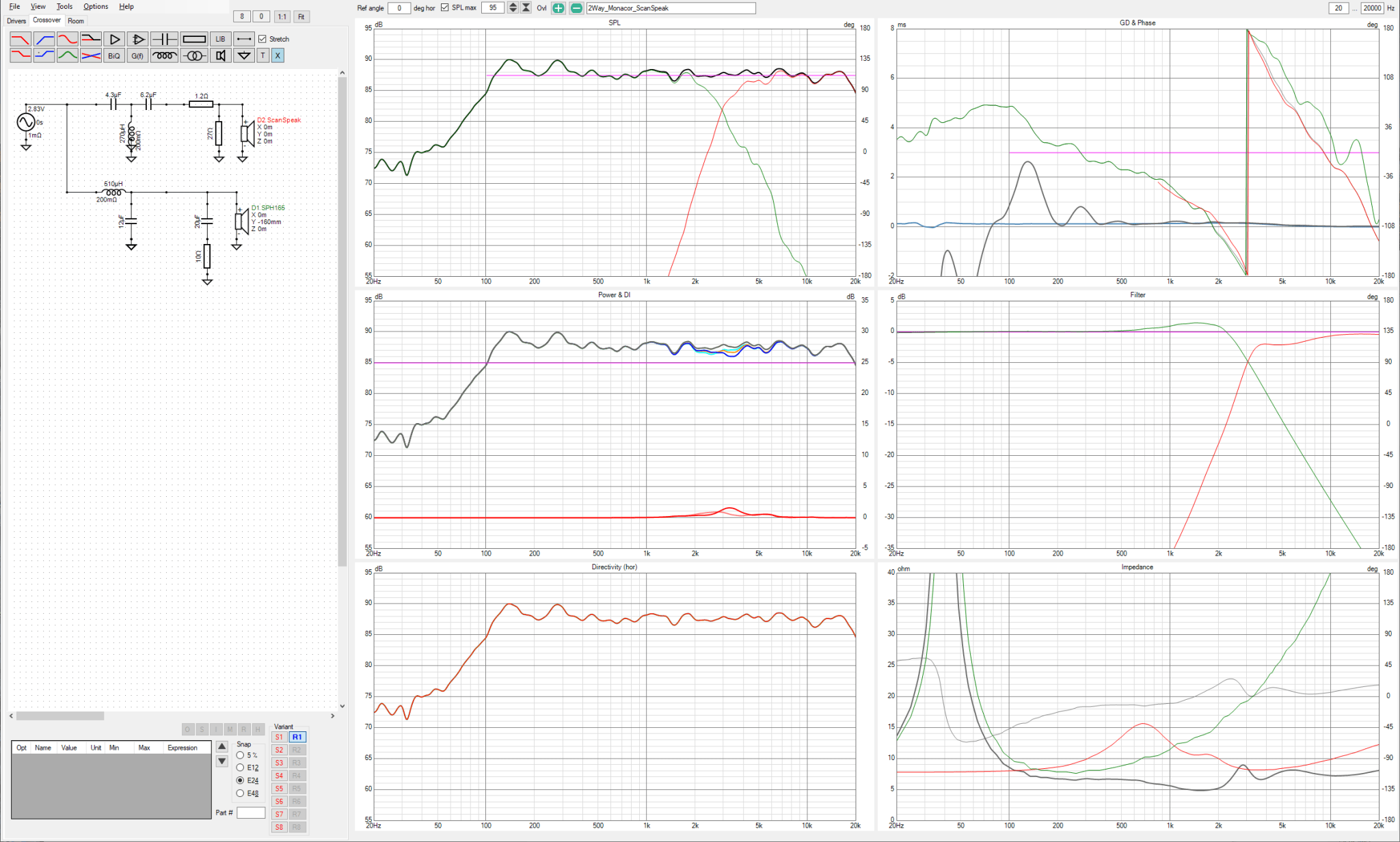

Yes,by all means reduce the sensitivity! 😀 The tweeter level is a smidge high and the woofer rise to meet it is not desirable. Flatten the woofer output and your impedance gets better. Lower the tweeter level and the balance becomes fuller

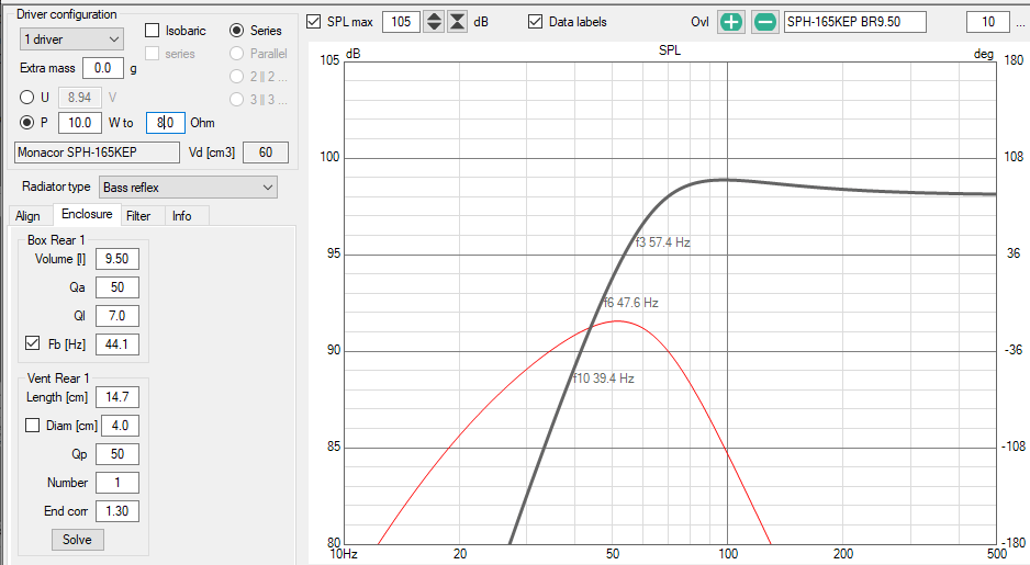

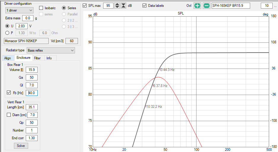

That's great news that they were the internal dimensions! The internal volume comes to around 15.9 litres, which seems plenty for the Monacor SPH-165KEP based on the Thiele–Small parameters in the datasheet. With a Dv = 7.0cm vent diameter, the VituixCAD estimates the vent length to be Lv = 35.1cm, which is quite long. The resulting bass response curve for a vent tuning frequency of Fb = 40.0Hz is shown below. The −3dB point is F3 = 44.3Hz.

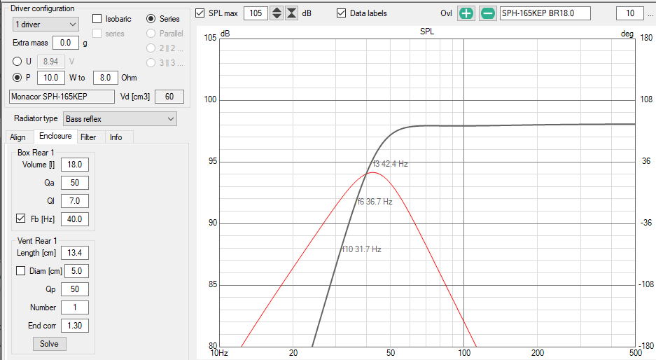

If we swap to a vent diameter of Dv = 5.0cm, the estimated vent length drops considerably to Lv = 16.0cm. With this configuration, the driver's Xmax is reached with 18W (re 8 ohms) of input power. At the same time, the maximum air velocity in the vent hovers around the lower of VituixCAD's guidelines (turbulence warning).

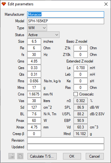

By the way, the following VituixCAD table shows the set of Thiele–Small parameters that I took from the woofer's datasheet.
Thanks for your help witwald! Now I understand a little more how to get about with VituixCAD. I am a prof. classic musician not really trained in this terminology. But I learn quickly. Anyway, the port/vent I prepared for was 7 cm in diameter, because Monacor sort of pointed in that direction when I read about it. Not to easy to change at this point. The port I bought can be extended to 26cm and according to your figures that will generate 45,5hz. Intention for these speakers will be in my workstudio about 18sqm. Of course its not good if there will a lot of turbulence but I am not sure how to understand the figures. Also I am quite tempted to try the crossover from your post #10, need to order some new values first.
I'm not entirely sure that we should try and reduce the output of the woofer to reduce the hump in its filter's transfer function. That will reduce the sensitivity of the system in the midrange area, which is potentially more undesirable.
Here the raw woofer response has a bit of a downward tilt. A little bit of filtering EQ is not unusual when dealing with driver natural frequency response functions.

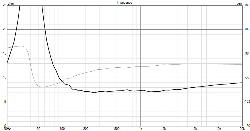

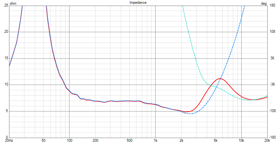

Below is a plot of the woofer impedance curve with the Zobel network in place. It has flattened the rising impedance of the woofer quite well. The impedance is about 7 ohms between 200Hz and 2000Hz, and then log-linearly rises to 9 ohms at 20kHz.

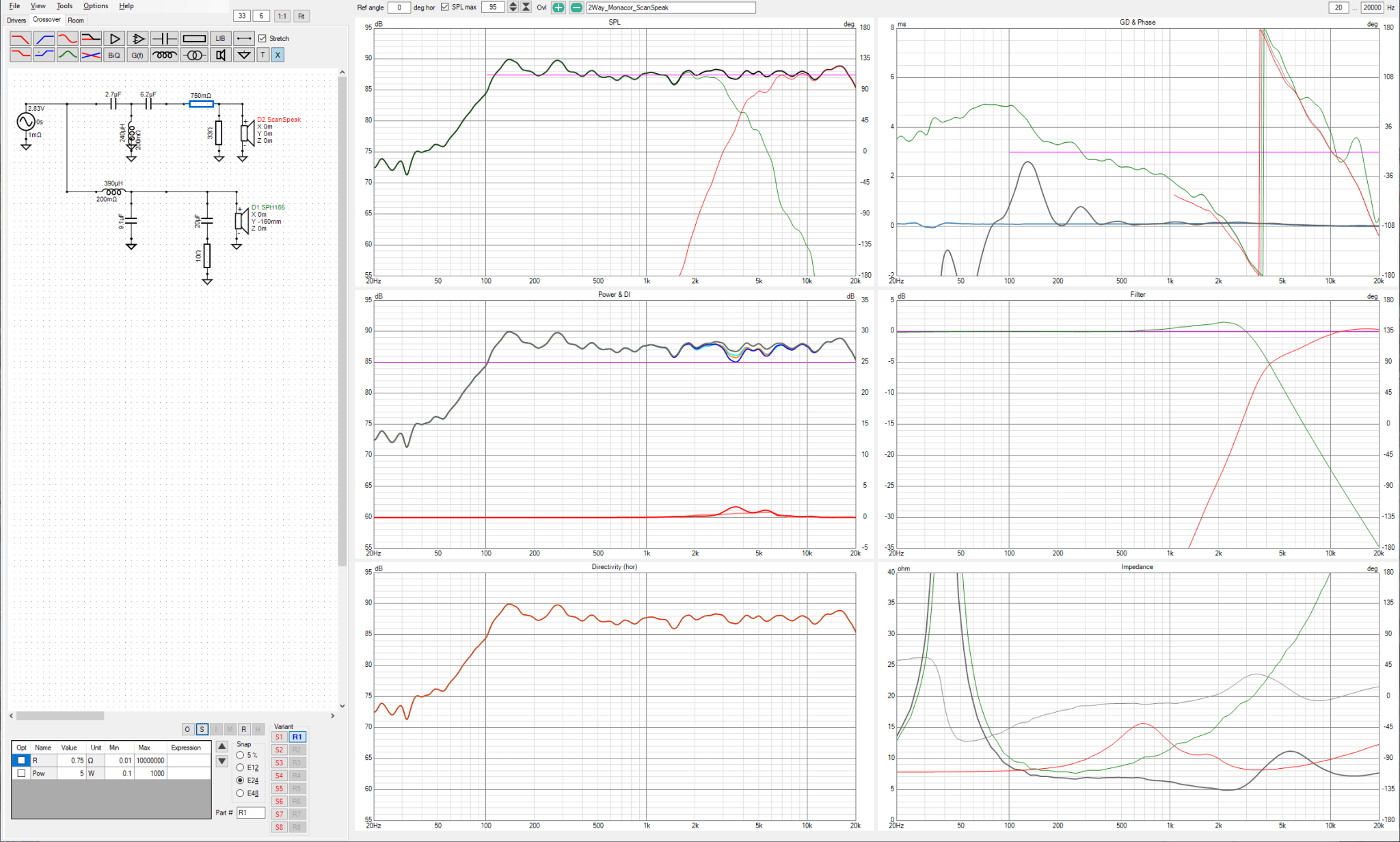

Hi, I follow the discussion with ericsquires with great interest. I must ask if you changed anything in the crossover layout from post #10? Mine looks now as in post #16

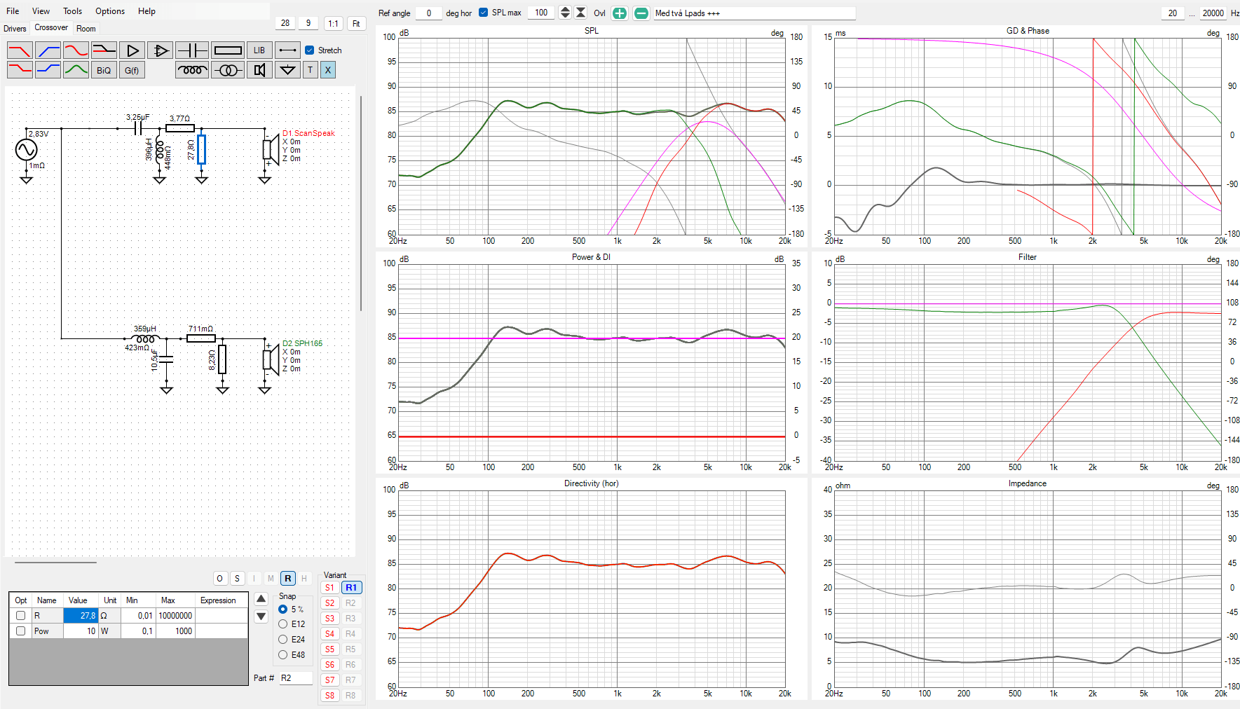

The crossover layout as per post #10 is the most up-to-date one that I posted. The impedance curves in post #16 correspond to it.
I tried an alternative Zobel design, which increased the woofer impedance at high frequencies. It did not produce any significant increase in the impedance around 2.2kHz. However, it resulted in a little bit more filter EQ in the woofer crossover, so I didn't bother pursuing it any further.

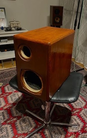

@witwald I must really say you did a fantastic job here, thank you so much! I have learned quite a lot this last few days. Also, your estimation of 8,5 cm cleranse to front wall is perfectly right. The article by Troels G. was also very interesting to read. I actually did correspond with him on mail a few years ago regarding a problem I had with my Proacs R1s. Hence, I opened them and found that they used a flanged tube, looking as those I made for this project. Since it's a long vent of 25 cm I will try first, I thought it could be a good idea. Interesting was that ProAc uses a rather thick foamrubber and nothing else around the walls. Yesterday I did order the components for the crossover, mainly Mundorf EVO oil serie 450v but also some Jantzen parts. Not the cheapest parts but certainly not the more expensive ones. It will take some time to get it all, but am looking forward to hear and also measure this with REW. I will post you when its ready. Thanks!
