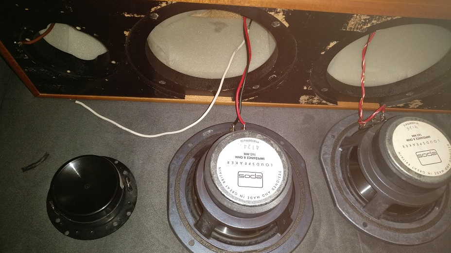

I've only the one tweeter out of the box. The other ES22 is working (I've not actually tested it but I was assured it does). So I've left it intact. The speakers arrived with the one tweeter disconnected. I have unscrewed the other two loudspeakers (see attached).
The tweeter gives resistance of "05.3" when the DMM set to 200, that's the lowest it goes. This is the same, roughly (it's a cheap Ebay Digital Multi-Metre), on each of the other speakers that I've unscrewed from the cabinet (but left attached to their wires).
I read somewhere to test a tweeter by attaching an AA battery to see if it responds. I attached a 1.2v recharageable and the diaphragm moved in a uniform manner - and made a sound - when thus connected.
Apologies for my lack of experience and knowledge when using the DMM. I am completely new to any kind of electronics.
The only other information I can give is the previous owner said he had a surge of power through his valve amps, there was a popping sound, and this one tweeter stopped working.

If the ferro-fluid was all dried up, would that stop a tweeter working? I'm grasping at straws really, as the previous owner said there was a definite popping sound and the tweeter stopped working. I can't see any cracks in the aluminium dome, and the coil appears intact. It is definitely in need of new ferro-fluid, but it isn't like it was totally dried up.
I'm very tempted to solder the tweeter back in place and see what comes out of it. I suppose I just need to hear if anything at all comes out of it.
Ok, so I did solder the tweeter back in to see what happened. It made sound but crackled. It really sounds like a cracked diaphragm, even though I can't see any cracks. So, it has come out again as I await the replacement tweeters.

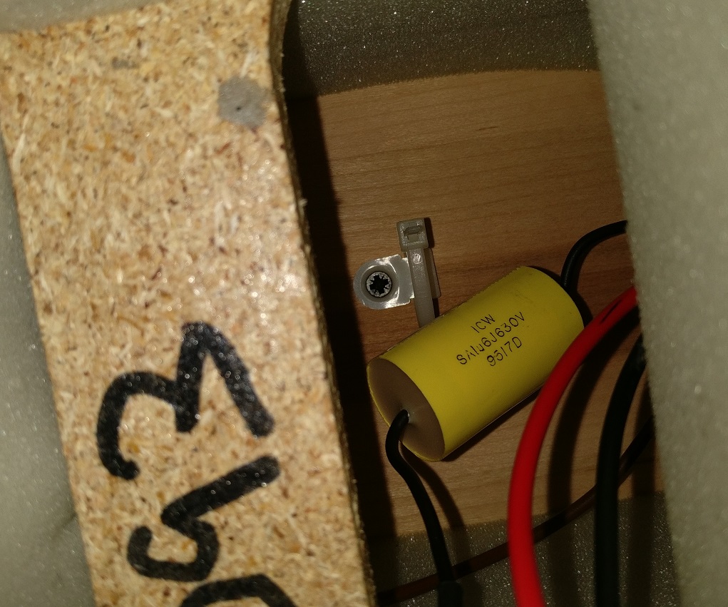

This is an old thread, and TBH, i am slightly confused by the exact capacitor value, but it is certainly near to 1.6uF.
What we know is this is an Epos 22:
This is the approximate crossover filter:
If I was a betting man, I'd say the chances of a 630V 5% MKP capacitor popping are next to zero.
Far more likely the tweeter has popped. What I suggest you do, is measure the tweeter with a good multimeter:
It should come out at about 4ohms. This is how tweeters look when you take them apart:
Many ways in which the wires break. Either the tweeter is broken, or the crossover wiring. If it was OK when you stuck it in the attic, I'd suspect broken wiring. Reflow the solder joints with a 40W iron and all might be well.
The code in the picture ... SA1u6J630v ... Series SA 1.6uf J? 630volts
