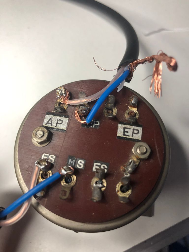

Hi friends, im asking for help to connect two Malotki transformers to XLR in and out connectors to pass sound though them as a stereo pair.
I attached the schematic of a Lundahl circuit to achieve what you want (missed that in the heat of the battle because of lacking/confusing data and also with theory, sorry). In your case there will only be one secondary winding so the AS and ES connections going to pins 2 and 3 of the XLR output connectors. If I am right then you will have a 0.7:1 ratio when used like this and I don't know if that is what you really want as signal levels are predefined and often high enough in the balanced world. A 1:1 ratio would seem better in that aspect. Still the lack of a datasheet of E5-M (not helped by the relabelling 😀) is what is making matters too complex and thus dependent on assumptions and educated guessing.
You can translate the schematic in post #44 to the Lundahl one.

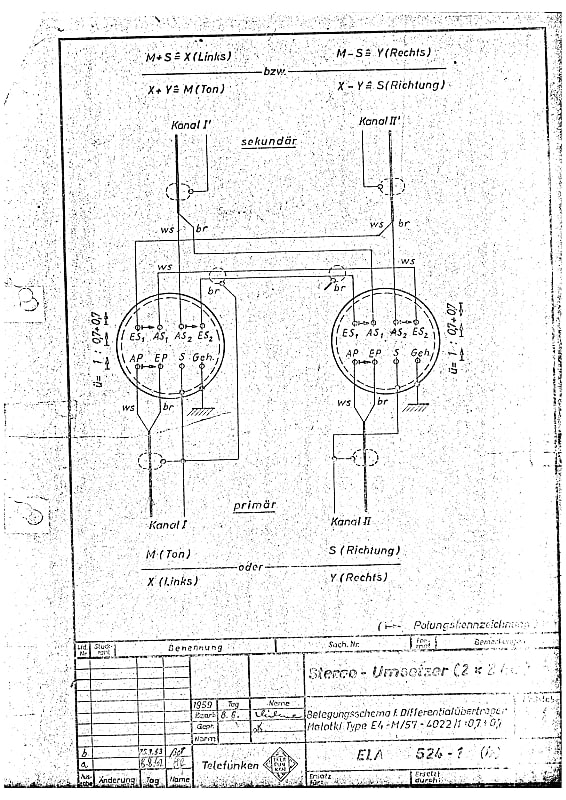

The picture of post 27 would have been useful to see from the beginning to prevent endless speculation.
That confirms what I did not want to speculate. The *pair* of 0,7:1 transformers is used to convert stereo program from L+R to M+S or M+S to L+R. There is no other excuse for making these things. They still have some small demand for that purpose: some record mastering operations work better in M+S mode, although increasing digital is putting M+S transformers out of work.
Any other use, such as L+R to L+R, is not what the designer intended. Since they are very low impedance (200? 600?) they won't have major flaws however you wire them, unless you try to drive straight from tubes. They should not distort at in-house levels. (The HIGH levels used for long-line national networks might smudge the deep bass.)

Yes they were used in a mid side configuration so that is why someone changed the letters on them.

yes they are the same, see this pic. My last question is about the ratio wich i have never seen other Malotki transformer with this ratio 0,7 : 1.
They usually are 1: 1.
Does the 0,7 mean that it lows the signal at first?.
