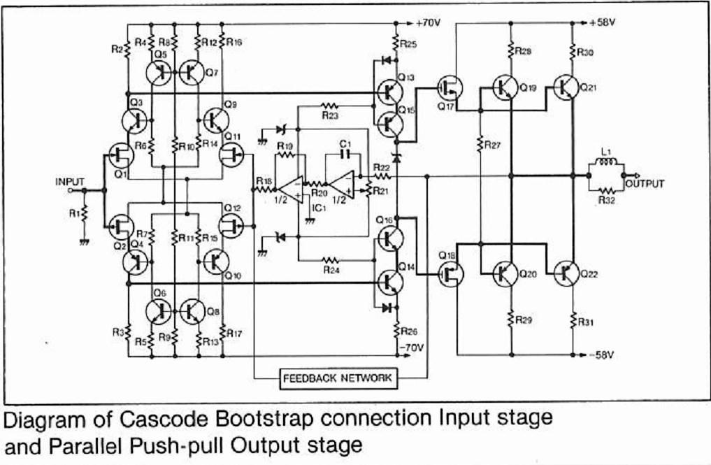

The output of these types of amplifiers should be within a volt or so of the output section supply under maximum load.
With a regulated +/-58V supply you would probably get 200W (8R)
But if it is a transformer / rectifier / filter cap 58V supply, if it drops to 50V under load (between filter capacitor charging from rectifiers / transformer) then I would rate it at about 150W because this is where you would enter in to clipping and therefore more significant distortion.
IMHO
Hope that helps.

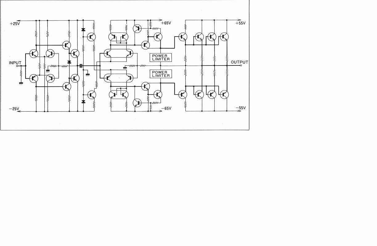

By the way, those amps have important errors , where did you get the schematics?
The first scheme this Accuphase block - a scheme
second too them
