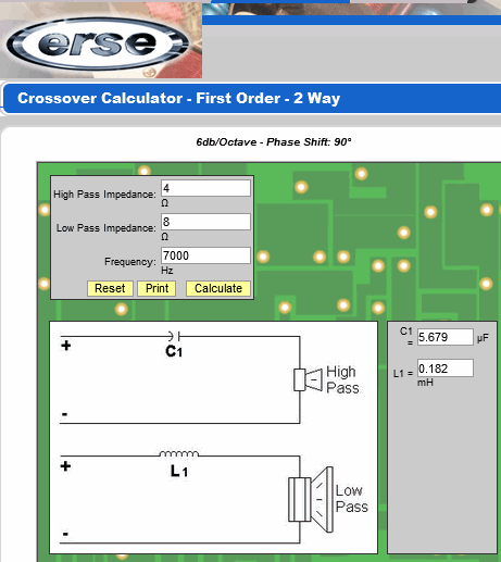

I need help calculating a 7000 Hz 2-way crossover for the following speaker configuration:
2 x Visaton FR 12 8 Ohm parallel (4 Ohm)
1 x Visaton SC 5 8 Ohm
Small, flat, closed enclosure only 3 liters

EDIT- I may have mixed-up the woofer and tweeter. You can do it right.
