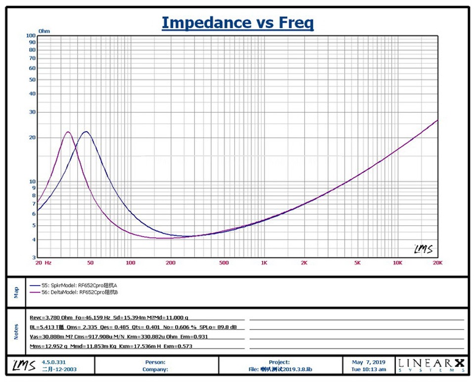

These T/S specs are 'floobydust' to the max! based on the published LMS measurements, which I verified match up whether T/S or Cms, etc., is used, so best if the above post is deleted.For ease of reference, here are the parameters of the Aiyima 6.5" Woofer:
Impedance: 4 Ohm
Rated power: 50W
Frequency: 46Hz-3.2Khz
Sensitivity: 89db±3db
Voice coil diameter: 30mm
Vas: 12L
Qts: 0.4
BL: 5.4
Perhaps an accommodating expert will suggest a suitable woofer enclosure? 😉

A typical closed (sealed) box volume for a roll surround 6.5" mid/bass speaker, such as the 8 ohm one in your link, is around 0.4 cubic foot (11 litres).
That's the best I can do in the absence of T/S parameters.
P.S. The 0.4 cu ft estimate of box volume comes from "Building Speaker Enclosures" by David Weems, and is not simply a guess on my part.
Please disregard those specs and return to square one!
As we don't even have an Fs or recommended BW as a basis to choose box/vent size using (one of) the pioneer's selection charts, PRR's guesstimate seems as good as any, so time (for me) to move on.
