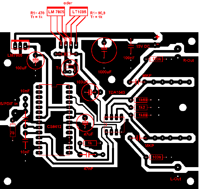

Just found this. Could this be ithttp://www.audiotuning.de/english/index.html?1-53-cs8414.html
or could I use this without the smaller chip (a DAC):

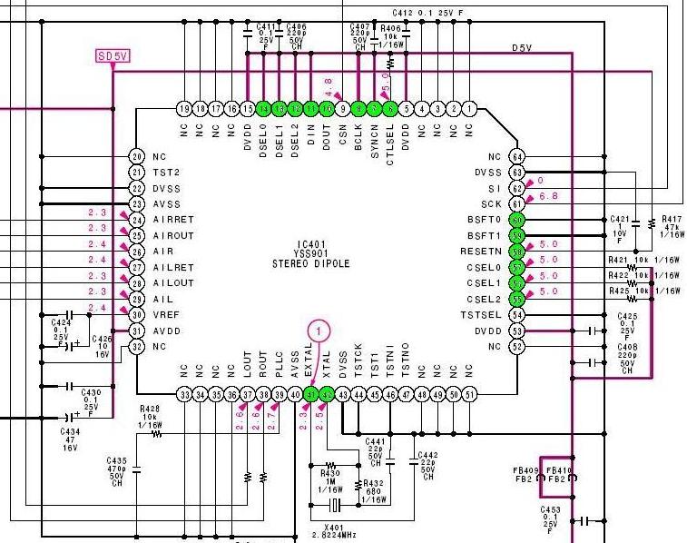

I attach a connection diagram that I figured out based on facserei´s indications on how to attach the chip into a panasonic digital amp.
One of the issues that is bugging me is the chip uses a 2.8224 Mh
crystal and I reckon the twisted pear audio receiver operates on a different frequency. Does that mean this will not work?
Also, do I connect the legs straight to ground or +5v on the DC switches for high or low selection or do I insert a 10k resistor before the switch?
Thanks from the great help so far, I sure need it.
you sure with your connection diagram? double check if you interface your DSP properly or it will not work at all. this is a very important part of this project. :att'n:
the chip may operates at a different frequency. but as long as you put the bck/lrck/data/gnd right, it will work its timing out don't worry. 🙂
you have to back check the logic level from the datasheet. but it is likely if the chip consume +5v, the maximum logic level could be up to 5v but anyway please double check. 😉

yss901
Hi, I am new to the forum too.
Poldus, I managed to get a Sony U-board too, with schematics, and just like you I am figuring out how to interface the YSS901. Like you I prefer to have a stand alone box. Did you make any progression with the spdif boards and the shift register issue?

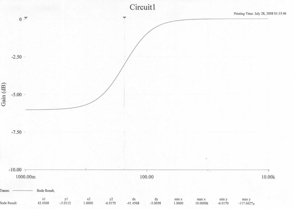

Regarding your remarks about missing the low-end:
- looking at the output opamp IC408 (which is'nt that bad), it is used as a HP filter rolling off the bass with 6 dB between 100Hz and 10Hz. See attachment.
- mixing unprocessed bass with the processed dipole signal acoustically may give problems because of the processing time delay.
