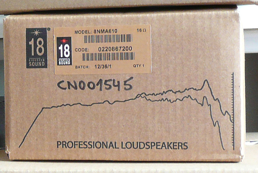

Eighteen Sound 8NMA610.

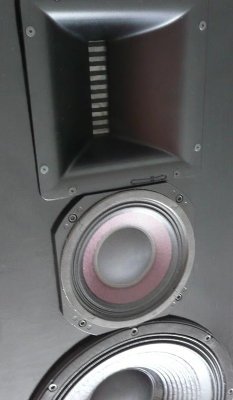

Extremely difficult to get hold of as they're not on Eighteen Sound's website, and were never on sale to the general public, but really a bespoke special version (of the standard 8NM610 driver) made specially for KV2 Audio, who use them for their VHD2.0 and ESR215 models. I managed to buy two of these drive units directly from KV2 Audio about 8 years ago.
I've got them as mids in my 3-way, inbetween Beyma TPL150H tweeters and Faital Pro 15XL1400 woofers. Crossovers are 275 Hz and 2750Hz with 30dB/oct LR linear phase slopes using individual driver FIR correction via six channels of OpenDRC.
713939d1541509914-help-crossover-tpl-150h-10nda610-box-jpg
713938d1541509905-help-crossover-tpl-150h-10nda610-driver-jpg
Nice! Do you know if these can be purchased anywhere?
