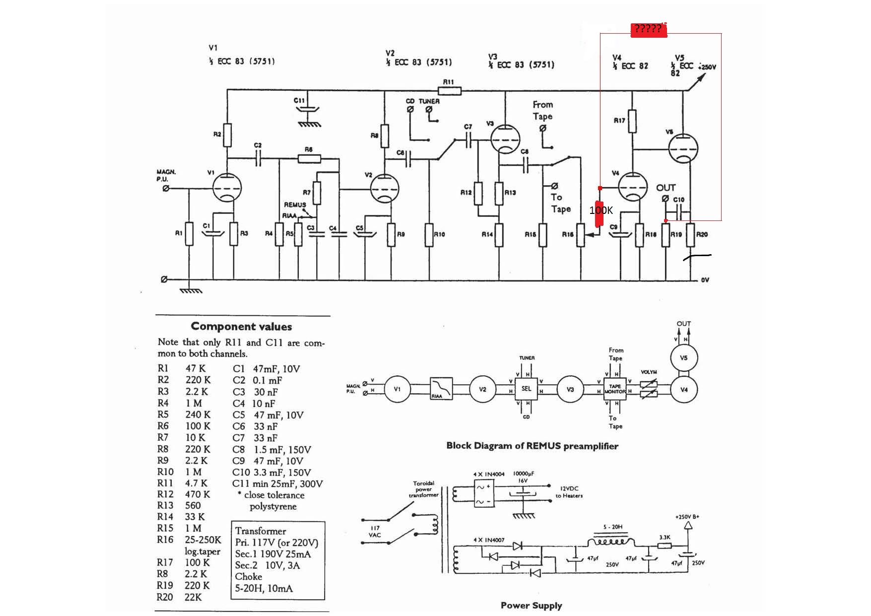

Help - the pre amp I made is not working!
I'd optimize tubes and operating points- FAR more important than components (assuming you've got decent but non-fancy components).
Absolutely correct on the components front - didn't cut any corners but nothing exotic.
On the tubes front I think I'm ok, they are all special edition ECC80X and spent quite a bit of money on them.
By operating points, are you referring to the power supply? Considering moving to regulated B+ for the finished project, any suggestions? Would like to avoid tubes in the power supply - will be external and want to be able to hide it behind the record players stand without worrying if it will break. (Ultimately this will be a double phono pre-amp which is summed before the line stage to allow for rudimentary cross-fading of two sources, in other words a fancy DJ mixer without all the features I seldom use at home.)

Well, you can buy a fancy ECC82 but... it's still an ECC82. That is not a particularly linear tube. So you might think about changing that to something different, the tube choice depending on the gain you actually need. It's possible (especially if all of your sources are things like CD players) that you don't even need gain in your linestage, in which case, you can convert it to a unity gain buffer. If you go that route, you definitely want to consider a higher transconductance tube than the ECC82.
By "operating point," I mean the plate voltage, plate load, and plate current (which by default encompasses grid bias as well).

It's true that I don't need anywhere near as much gain as this has and was considering adding feedback to take it down a bit. Was in fact thinking about using a variable resistor in the loop, adding another "level" of volume control which I can vary depending on what this goes into.
Could you point me to somewhere where I could read about unity gain buffers and/or recommend a circuit? What valve(s) did you have in mind?
Having read around forums and sites, noticed suggestions that swapping the ECC82 with a 12BH7 offers improvement - any experiences? Perhaps another option is to change it for an ECC81? That's supposed to be less noisy, right?

ECC81 would not be my choice here, a previous suggestion to use a 6CG7 was an excellent one. This device has linearity to match the 6SN7 - far better than either the ECC82 or '81. The 12BH7 in most instances is an improvement over the ECC82, but the 6CG7 is better still.

I guess I could re-do the heaters supply to 6.3V and try the 6CG7. My only fear is that I'm not sure my transformer will be able to handle the higher current draw - I will need to supply 8 tubes in the finished product and doubt it can do 5A. There are two pairs of 6.3V taps. From a current draw point of view, can I treat them as two separate sources?
What is the rating of each tap? One option would be to just place the 6CG7 filaments (channel to channel) in series.. I am not sure where your filament current numbers are coming from as there are 5 stages per channel so even with the 6CG7 I come up with only 900mA - 975mA per channel or < 2A total on 6.3V, it would be half this on 12.6V.. 12AX7 per envelope (2 triodes) use 300mA at 6.3V and 150mA at 12.6V, the 5751 uses 350mA/175mA respectively, and the 6CG7 is 600mA @ 6.3V per envelope two in series on 12.6V would be 600mA.. I'd just use one winding per channel assuming that they are rated at >1A or are you using dc heating in which case the numbers are a bit worse and I'd recommend 12.6V for better efficiency. (rectifier and winding losses, regulator drop-out voltage, etc.)
Sorry - misread my notes and thought that the ECC83 and 81 drew as much as the 6CG7.
Still, it is more than 2A:
By mixer I mean that I will have two times the circuit up to the volume pot and this fed into the line stage and cathode follower using resistors (with the addition of feedback which, according to the research I have done, improves isolation and distortion and reduces gain).
So, will have to supply four ECC83s (.3A @ 6.3V), three ECC81s (the two volume stages and the final cathode follower - .3A @6.3V) and one 6CG7 or whatever I have there (up to .6A @ 6.3V). Total of 2.7 if using the 6CG7
Total would be approximately 2.7A. I have no idea what the rating of the heaters taps on my transformer is - I salvaged it from an old valve amp I picked up on ebay. This is part of the reason I went for 12.6V to begin with. Currently running a regulated DC supply.
When you say "place the 6CG7 filaments (channel to channel) in series", presume you mean "pin 4 of valve A connected to pin 5 of valve B and live and neutral connected to the other two heater pins". As I am only using one 6CG7, I guess I could instead connect one of its pins to the heaters centre tap of the cathode follower and then my live and neutral to the remaining pin of the 6CG7 and the two heater connections of the cathode follower (so that it also draws 6.3V). Do you think this would work? It's easy enough to do and I could try what each of these combinations sound.
Can I just leave the rest of the design the same if I try the 6CG7?
You could drop heater voltage with a resistor, but this wastes power. Better if possible to drop with another heater. No noise implications, as resistor noise is way lower than the 6V hum which valves are designed to cope with.
The ECC81 (cathode follower) draws 300mA @ 6.3V whereas the 6CG7 600mA, is it still ok to hook up the former's two heaters in parallel (using the centre tap) with the latter in series and supply 12V you think? Would both valves fillaments get 6.3V or could there be an imbalance?
Most importantly, do you know what tolerances fillaments have? Can I afford to just try it and see, or would I bugger them up if one got, say 7-8V or something and the other the balance?

If you put valve heaters in series then they must have the same current rating, so you can't put a 300mA in series with a 600mA. If you do the 300mA one will get much too hot and the 600mA hardly warm at all. You can put a 600mA in series with (two 300mA in parallel).
You could try the 6/30L2 (ECC804). This has a 300mA heater, but 6CG7-like characteristics (apart from the maximum anode dissipation being lower).

Could I please ask for some more help? I've been experimenting with adding feedback to reduce gain and I'm having a bit of a problem. I have attached the schematic with that I have added to it - a resistor the value of which I'm experimenting between the output and the grid of the line stage valve driver and another 100K resistor between the pot and that grid.
200K where the question marks are does reduce the volume, but nowhere near enough. 100K is better, but this adds a very disturbing repetitive "thump", almost like turning up the "feedback" control on an analogue delay/echo FX unit. Without really understanding these principles deeply (I promise I will one day read Morgan Jones' book!), I suspect this means that rather than negative I am having positive feedback? Am I right? Why is this happening?
And the million dollar question: can anyone guess/calculate what value resistance I need to reduce gain to unity (or thereabouts) and explain how they did it? Also, is it possible to add a variable resistor there, to tweak the overall gain of the line stage?

PS this is all a separate issue to the earlier discussions about changing valves used - I will probably do this anyway, but for the time being I want to understand how feedback works and how to tweak its parameters.
