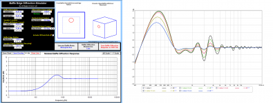

Someone may chime in and prove me wrong, but I can't really see why the surface has to be smooth. Just thinking of the size of the wavelengths (1" and up), seems like it would take a pretty substantial glob to really affect things much. Sort of the opposite side of why it's not worth rounding the corners of cabinets unless using a radius of a couple of inches at least (though part of that is because directivity keeps hf away from the edges already).
Are you then saying that in a SEOS-12 / 12" woofer build, that if the biggest roundover bit I have is 3/4" that it's not really useful?
According to Dr. Geddes, it's not. I haven't seen any evidence of it helping in the builds I've used round-overs on (though it can look pretty nice), but YMMV
Build it, measure it, and see.
Mindsource,
In Jeff Bagby calculator three inch edge radius looks as blue trace in left plot below, at right plot traces is 0/0.5/1.0/2.0/3.0 inch radius.
