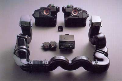

GM (Government Motors) made some cars with the Bose cannon. The massive 4-1/2" driver was in the corner of the trunk, with the short tube running up through the door and exiting up near the driver, the long tube ran across the trunk and through the other door and exited up near the passenger. The tubes were a rough oval, and made of genuine plastic.

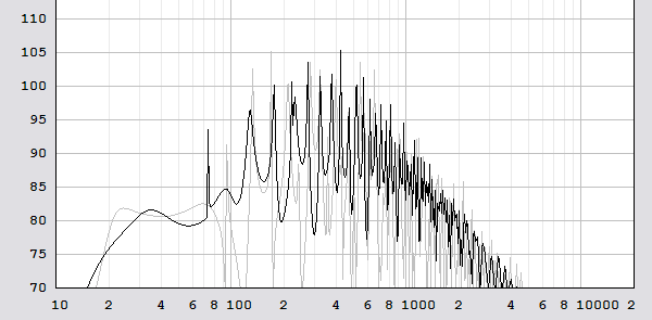

I've simmed these half a dozen times over the years, and I never came up with anything that looked good.
But you mentioned something I'd never considered, which is that the distance from the ends to the listening position are not equidistant.
When I'd simmed Bass Cannons in hornresp, I'd always blasted past the dialog where it asks you to enter the 'path length difference'. I'd always entered zero.
But it's not as simple as that.
This is actually a GREAT thing! It means that the bass cannon is insanely directional, which could be really handy in a room or in a car. Put the bass where you want it.
Here's a few examples of this:

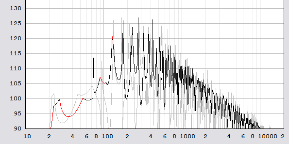

First off, here's a tapped horn with an Alpine 8", the SWR 843D to be specific. This folding is based on the Insubnia sub. I've built a sub similar to this, and it's a great little box.
Here's a bass cannon, using basically the same tunings and box size, compared to the tapped horn. We see a couple things:
1) The TH has a little more output at 30hz
2) the bass cannon has a lot more output at 90hz
No big surprises here, Hoffman's Iron Law still rules the day. With comparable volumes, the two boxes have similar output and displacement.

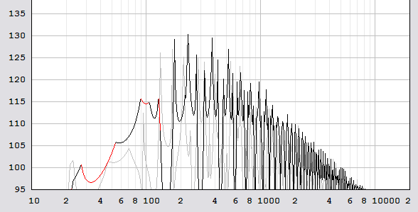

If you change the pathlengths by 100cm, now the tapped horn is significantly louder than the bass cannon. But this isn't necessarily A Good Thing; directional subs sound great. (Just ask anyone with a dipole.)
The easiest way to change the pathlengths is to simply rotate the bass cannon. Probably get a mic out and rotate it until the power response looks good.
Once you maximize the pathlength difference, the output from the far side of the bass cannon has been reduced dramatically. In the real world, I anticipate that the sub wouldn't be as directional as the sims show, as the output from the far side of the bass cannon will be reflected by any walls that are nearby. Having said that, this sub will *definitely* be more directional than a sealed box or tapped horn. The directivity of the sub is due to the pathlength difference, and maximizing that difference maximizes the directivity. In the sims, the output at 60hz drops by ten decibels when you get 90 degrees off axis from the bass cannon. That's like reducing the power from 1000watts to 100 watts!
Here's the hornresp data for the tapped horn and the bass cannon
Here's the hornresp layout for the TH and the BC.
Note that the small segment of the bass cannon is created by using the 'ported back chamber' option in Hornresp. This option is under Tools > Chamber > Rear Vented
Here's the displacement and the phase response. They're basically identical. The response of the bass cannon is different than the tapped horn due to the pathlength differences, but the displacement, impedance and phase is similar because they're both tuned to the same frequency and their volume is basically the same. (Hoffman's Iron Law.)
