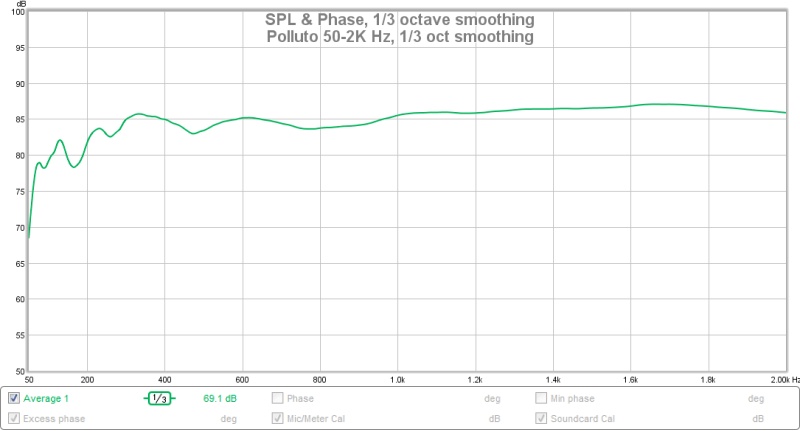

Finally, some sweeps!
OK, I set up the pair of Pollutos and did one sweep (two per measurement) for unit A, B and with port open or closed. The sweeps are remarkably the same, leading me to wonder if the QW tube worth the trouble? Rather than bore you, I inclose a link to the REW file you may download and play with.
Remarkably flat (+/- 5?) between roughly 70-3000 Hz. Not bad for a cheap driver.
Usual disclaimers: ECM8000 not calibrated, done aoubt 3 feet from top of cylinder and 2 feet off tile floor. Data should compare well because mic and speakers were in essentially the same positions.

Plotting against us!
Why of course...since the responses are so similar, here is an average (50 - 3K Hz). The response peaks about 1.7 KHz and drops more or less evenly at about 7 dB/oct. If you want a different plot just ask. This set of measurements were done below axis of the speaker, at say -30 degrees to the horizontal so it is kind of not on axis 🙂
