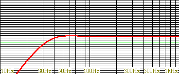

Here is a great 10" long stroke woofer from Peerless that is within your price range and almost made to order for such an enclosure. Ten or twelve years ago, this speaker's predecessor was about as good as it got in the subwoofer department at almost any price. Subwoofers have moved up performance wise, but this speaker is still a great value for the money. The only difference between this speaker and it's predecessor is the fact that the new composite cone extends the smooth response up to the 1500 Hz.
Following is the WinISD graph showing it's excellent response in a 2 cu ft box vented to 27 Hz.
Here it is. Really good to 30 Hz.

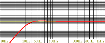

INSTALLATION CONFIGURATIONS - PCwg120
from blaupunkt
Most accurate:
2.0 ft3
Really pleasant deep bass with good tonal quality
all i want is the above nothing more nothing less......
is this good or bad or ok?😕
???i dont know what all those picture grapgs mean???
If you've heard your friends and like it then go for it you have nothing to lose. But don't get discouraged when you post here and people recommend different products than you had in mind. Everybody has a "pet" sub or amp that they like and it's the nature of the audio freak to recommend their favorites to everybody who asks.
With regards to the graphs, they're showing the drivers frequency response. You want to avoid a driver/box combo that has lots of peaks and dips in it. A smooth fairly flat line that drops off slowly at a low frequency is what you're generally after. This is quite simplified, but at least now you should know basically what they are.
The plot you posted has a small hump centered around about 60Hz where you're up a little more than a decibel. Looks to be -3dB somewhere between 30 and 40Hz. Which isn't bad at all.
