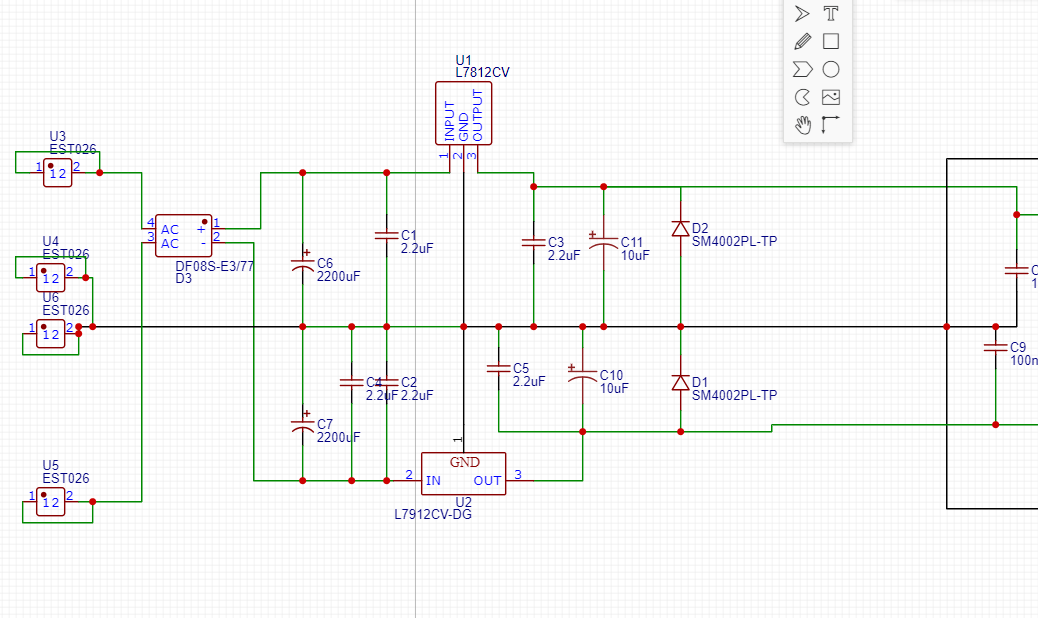

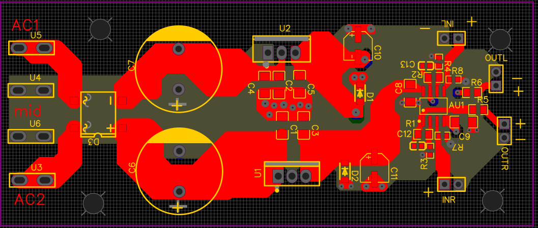

I recently built a 6 channel amplifier after many years of planning and plans changing for a 3 way system with active crossover. Basically I used a stereo 3e audio tpa3255 and a 4 channel tpa 3251. These boards have 20dB gain. and I need more, so i tried to design myself 3 stereo preamps. They are based on a OPA1656, i attach the schematics (amp__section and supply section, split for ease of reading). The supply section of each of them is connected to a transformer, the centrals of the transformers and the grounds of the PCBs are connected together by thick wires. The ground of the PCBs is a thick ground plane.
The connections are the most obvious you can imagine (see layout): basically, wires from the external RCA connectors to the IN terminals, and wires from the OUTs of these boards to the INs of the 3eaudio boards. I tried also some variants, that didn't make any change, including connecting together the grounds of the 3E audio boards.

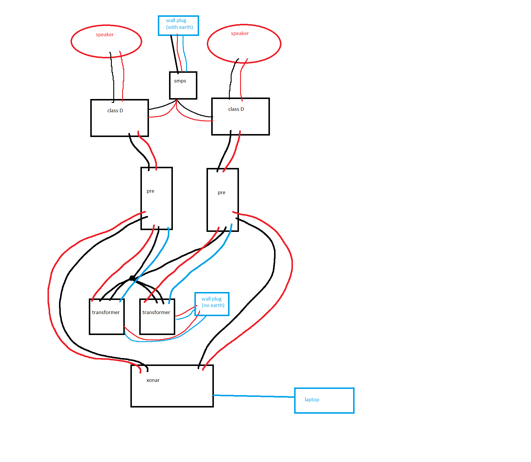

It's most probable not in the schema but how you connect everything together. Draw a system schema.

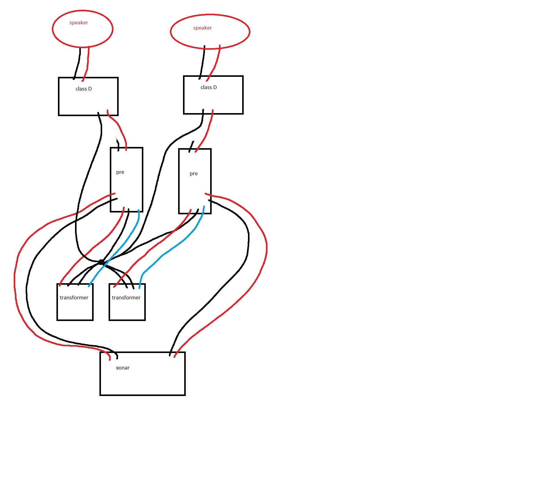

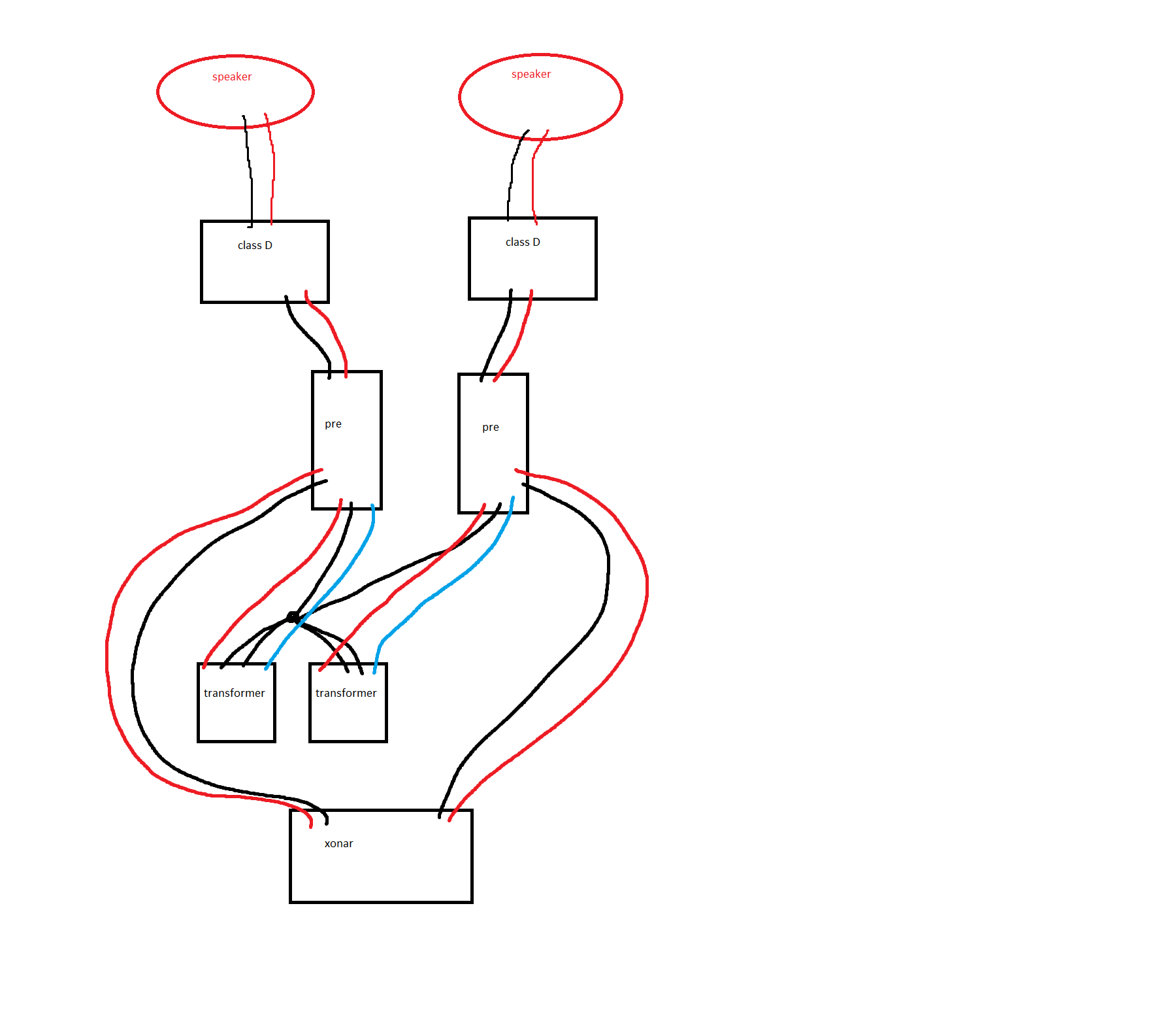

Here is a drawing of the system connections!
I hope the colors make clear what i don't write.
i simplified the drawing by considering just 2 preamp boards, and considering them mono.
Both configurations gave exactly the same 50Hz noise.
in the experiments i made, just consider portable headphone amps in the middle between the xonar and the preamp, or a portable player instead of the xonar, or the xonar's headphone out instead of the speaker out
edit- i forgot to draw the class D supply - it is just asingle 32V SMPS connected to both of the class D boards

One of the outputs (- most likely) is connected to mains earth probably. This goes back to the earth of the laptop and so to the Xonar. Big loop outside of what you have drawn. In cases like this, you also need to draw all the power supplies, also from the laptop and how thoses are connected to mains earth.
Have you tried the laptop on batteries?
Strange that it doesn't make a difference on the laptop with batteries. Galvanically isolated does not mean that earth isn't connected. Negative is normally connected to earth in the psu. I know it is the wace in the laptops I do have (all 4 of them from different brands).
