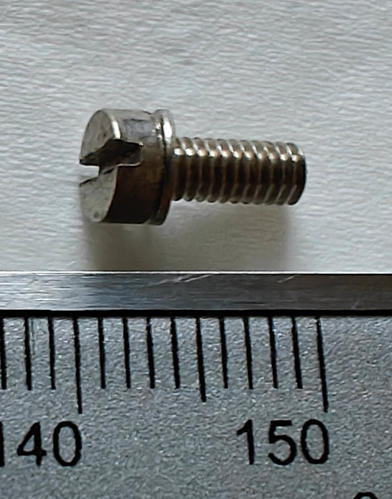

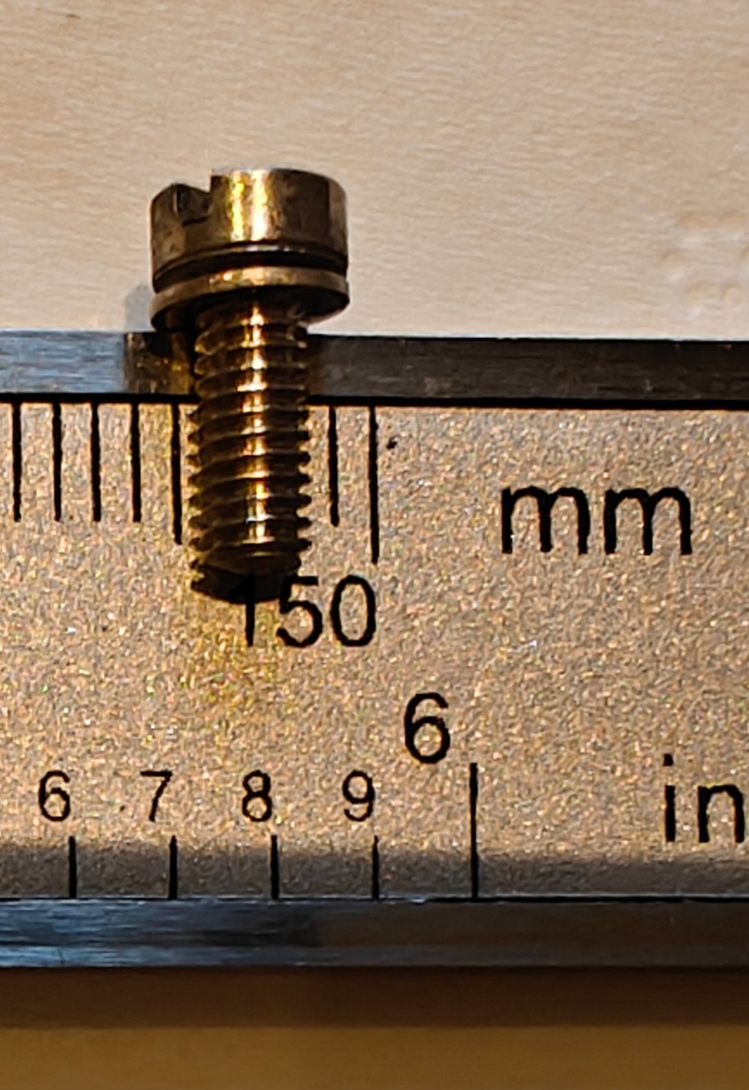

Mine measures approx 2.73mm thread diameter on my el cheapo calipers. But probably an imperial thread, either No. 3 or No. 4. Sorry I can't be more helpful.

Ok, after a rummage through my spares I found some M2.5 bolts and tried one. It bit ok on the thread and could be tightened but didn't feel 'right' if you know what I mean.
So I think it might be ok with that if you're not planning to doing it too tight or constantly doing and undoing.

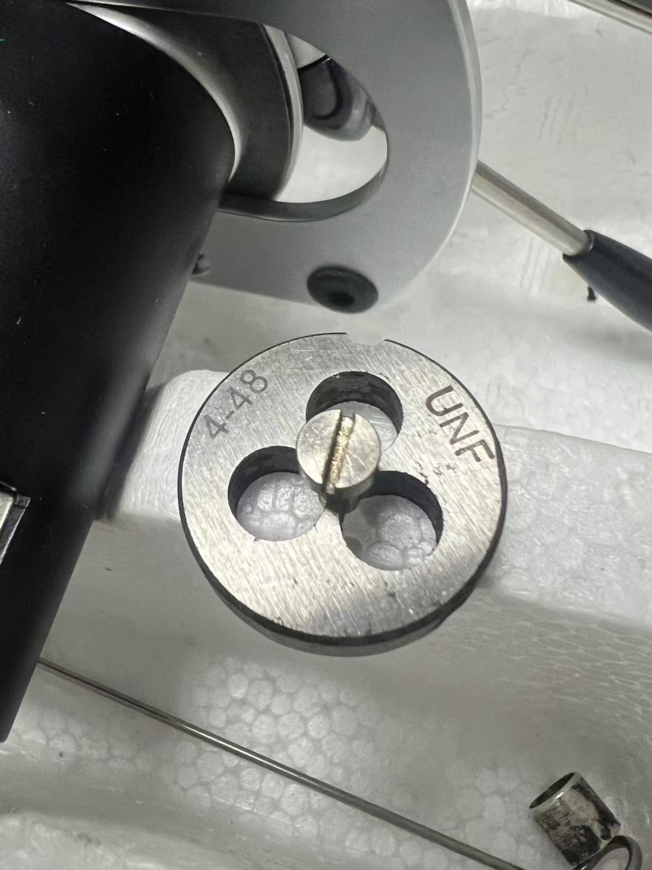

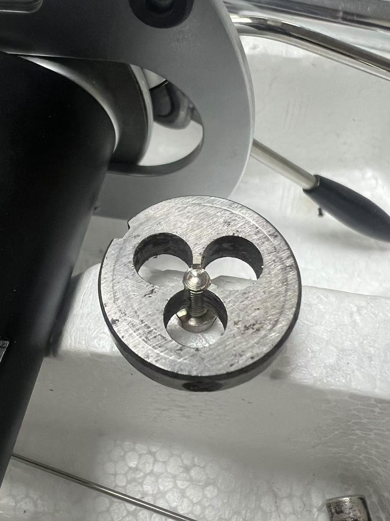

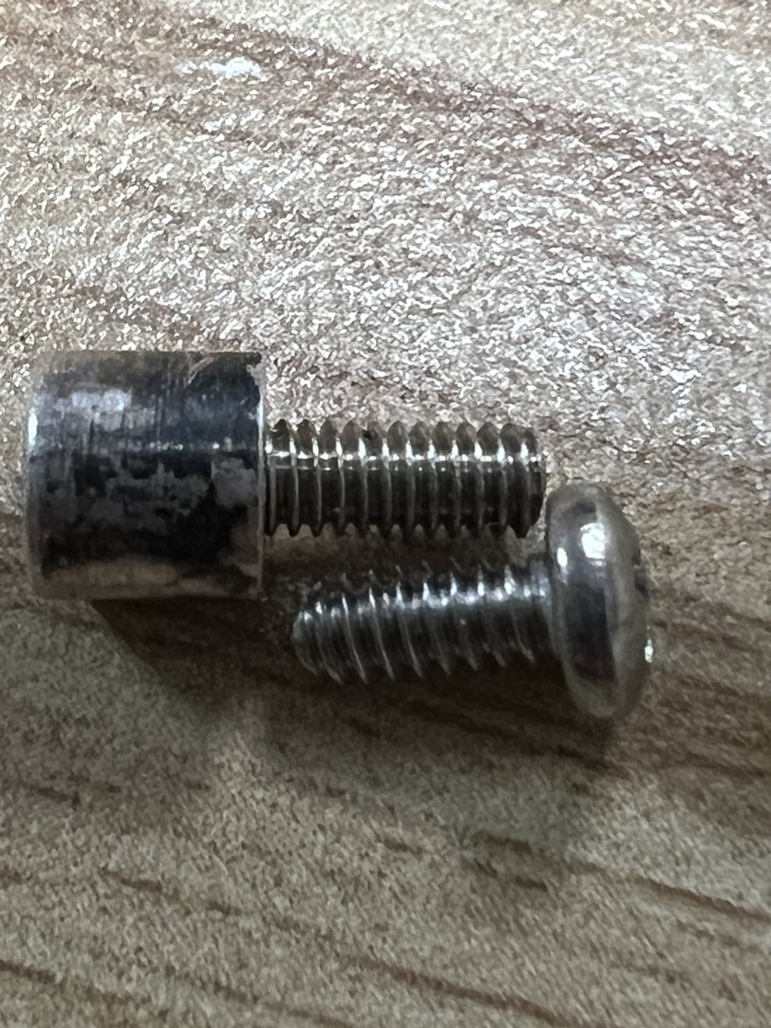

Steven Rook, thank you for your reply. I have purchased 4 # -40 * 1/4 screws, but the pitch of the screws is different from SME's. I have taken pictures for your reference. Non standardization is a headache inducing thing.
Dave Cawley, thank you. I have checked and found that the 6BA and 4-48 specifications are very similar. 6BA is a more difficult size to buy. I purchased a 4-48 tool and attempted to modify the screws of M3. I will report the results to everyone.
