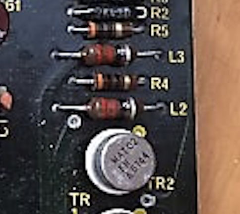

I have a question regarding a summing amp that I am about to build.
I am posting the schematics and a picture of the original card.
could you help me sourcing this inductors and from what type it is exactly ?
We talk about L9 and L10 here.
the value is 15 uH.
thanks a lot !! 🙂🙂🙂

thanks for all your great infos !
silver is 10% precision right ?
could different brand affect the sound in a huge way ?
I am adding an other older version where they use as well inductors... seems to. use the same brand (maybe I am mistaken) (and where they use MAT02)
do I need to be careful. about something ? except the size and tolerance of course.
is there different "type " or technologies ?
thanks very much !

This one looks similar to the original, Epcos B78108S1153K000:
https://uk.farnell.com/epcos/b78108s1153k000/inductor-15uh-10-610ma-20mhz/dp/608506
Silver indeed means 10 % tolerance. Similar inductors with a smaller tolerance should, of course, also work.
The inductors should not be driven anywhere near saturation by the signal currents, their parasitic capacitance should not be so large that it destabilizes the amplifier and their losses should be small compared to those of R279 and R289. I expect that just about any 15 uH axial inductor of about the right size will meet these criteria.
