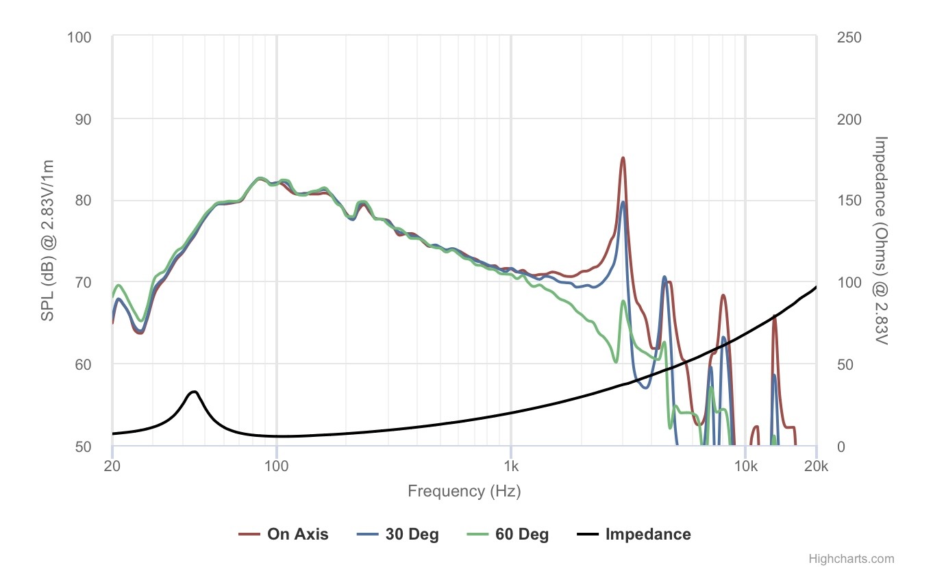

Problem: one blown mid bass driver LF-M049, 8ohm, 168mm OD, 140mm cutout.
I am having great difficulty finding a replacement because the baffle cutout diameter is 140mm, which is slightly too small for the normal 6.5" driver options. There's no info available for this driver using the search term LF-M049 as per the sticker on the magnet. It looks just like a regular Monacor driver, but they don't have one that's the right size for the baffle cutout.
However I've found a Peerless driver - SBS-160F35AL01-04 - this fits but I don't know if it is the right spec.
What sensitivity should I be using? Most of the woofers seem to be around 84-09 dB but these Peerless ones are 78.7 dB. So I haven't the foggiest if they would sound ok and match the crossovers.
Like I day - completely ignorant about this stuff! But am an engineer (mech) and love getting into new stuff, so feel free to educate me.
Any guidance on what to go for in terms of audio specs would be greatly appreciated. I'd replace both drivers obviously.

That SBS-160F35AL01-04 is a small woofer: and by no means midwoofer suitable for matching to a tweeter.
Sensitivity differences aside; the droop in the midrange will make it unsuitable for a replacement.
