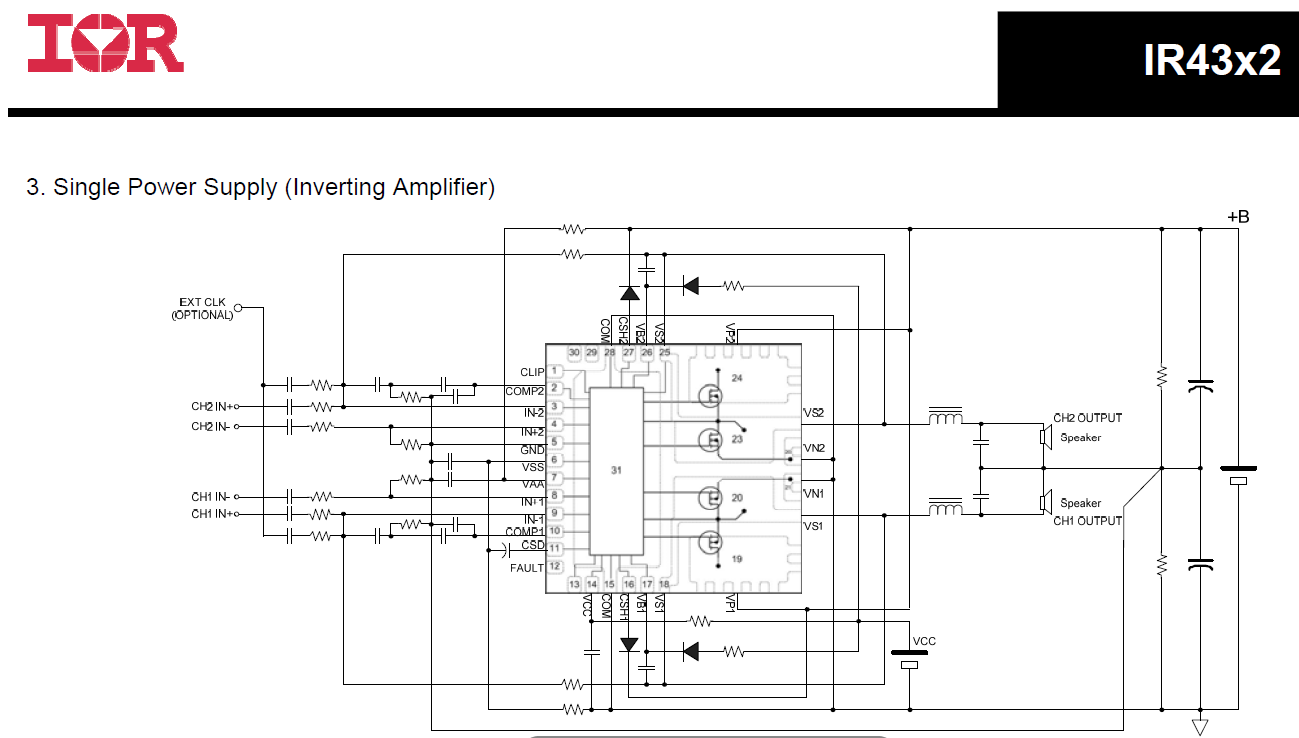

After a couple of hours 'net searching I came across a chip that looks almost ideal, IR4322 from International Rectifier which can cater for 60v single supply, stereo, minimal components. However it seems this chip isn't very popular and even digikey/mouser don't stock it!
I'm not entirely clear about the implementation differences between single and dual supplies are for Class-D. What is interesting is that the schematic for the IR4322 for single supply (see attached) has a resistor divider on the output as the gnd return for the speaker, yet this doesn't make sense as the resistor would not be able to carry the output current.
Looking into the audio transformer it seems would be quite bulky at the frequencies we are talking about (not to mention possible EMI problems as abraxalito points out). I'm not understanding why the transformer is needed if a blocking cap is used on the output, as the transformer primary just looks like a load connected to ground from the amp output perspective (mosfet half bridge).

The trafo is needed so that your rather weak 56V PSU does not collapse under the strain of driving a raw 8R (or heaven forbid, 4R) drive unit. Put simply, there's insufficient current available, even with the local storage cap.
A trafo primary looks like a large inductor (typically 1H or more) so does not load the amp much except at the very lowest frequencies (below audio).
